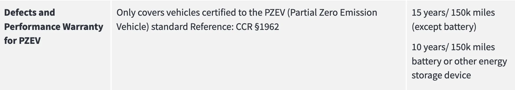

When I bought my RWD Taycan in Los Angeles two years ago I was told by the Porsche outlet general manager that California law supersedes the Porsche battery warranty and provides a 10 year warranty. Apparently this is not the case, which is quite surprising and, frankly, disappointing. From California Air Resource web site:
I agree w/ the comments about the risk of "bricking" otherwise perfectly fine EVs after, say, 100,000 miles due to the high cost of battery replacement. Because of the low cost of other service aspects of EVs, it doesn't seem unreasonable to pay, say, 25% for a new battery system every 10 years if the expected life of the car is in the neighborhood of 300,000 miles. Otherwise it will become yet another ding (a big one) against EVs.
For me, I keep my vehicles forever so I pick ones I love and will stand the test of time in terms of beauty & performance. My Taycan will test me on this for the first time in my life. I won't put more than 60K to 70K miles on it by the time the 8 year battery warranty expires. If the range is reduced to 50% or below after 10-15 years I can live with that but I hope the old battery modules don't become a risk of fire in the long term when charging in my garage or from credible possibility of spontaneous combustion in my garage. If there are long term dangers for battery modules beyond a certain age then you can't simply replace a few modules to get back range. You would have to replace them all to remove the fire risk or replace just a few and remove all the old modules which would not necessarily be possible since it would change the battery weight distribution in the vehicle or require modifications to the charging system if the overall capacity was to be at 50% or less depending on how many modules were replaced and how many removed. On the bright side the car would become lighter so the range with 50% less battery capacity would give better range without the dead weight of batteries which are already greatly diminished but if all old batteries beyond a certain age must be replaced for safety reasons then that would really destroy the value of EVs of any type or manufacturer since you would then be forced into an expensive complete battery replacement which would be higher than the residual value of an EV.

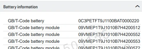

@Genau When I took delivery of my Taycan over 2 years ago, the sales rep sent me a report entitled PCSS vehicle information report for my VIN.
Among other things in the 6 page report were the HV battery serial number, GBT code, and the GBT codes of each HV battery module. See extract below. You may want to request that report for your VIN. Might help in determining whether your car is/is not in the recall group.
Porsche Taycan Recall 23v-840 Replacing Cell Block Module on High Voltage Battery 1714429431355-76
