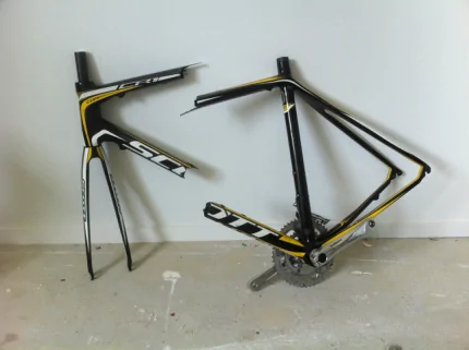

Not sold on the carbon fiber rollcage, doesn't carbon fiber shatter?
No.
I, personally, have total contempt for carbon fibre as a shiny interior trim material but as a structural material and properly made it is better than any metal for the car structure. I have been using it for just over 40 years.
Sadly too expensive for most car structures though.

No.
But when it reaches its limit it does this instead of deform like steel, right?
Well that depends!
Mild steel, which is the least strong, does plastically deflect a great deal, absorbing energy as it does so and is ideal for inexpensive crash structures.
The stronger steel alloys have less plactic deflection before failure and absorb far less energy because of this. That means they may be better (if expensive) for strengthening a car structure in certain areas they are less suitable for crash structure.
The physical shape of a component also influences the way in which energy is absorbed and redirected and also makes it possible to control the collapse propagation to absorb energy in a controlled way in time and distance.
Composites, including carbon fibre ones are also extremely dependant on the actual fibre and resin chosen, as well as shape. There are several grades of raw fibre, some less strong but more resilient and some stiffer but more brittle. This is also true of the resin systems with temperature sensitivity brought into the mix as well, as with most polymers there is a range of good working temperature where too high it starts to fail due to chemical deterioration and at the low temperature end it goes past what gets called the "glass transition" temperature and goes brittle.
IME a Formula 1 chassis will have low modulus fibres and a reasonably resilient but temperature resistant resin in order to cope with engine and coolant temperature and pass the impact tests.
The wings, where stiffness is paramount (it is pretty well impossible to make them as stiff as you want due to their shape and the huge loads) will be full of high modulus unidirectional carbon layers tailored in complex shapes to deal with load cases (and to make sure the deflection that inevitably will take place is in a direction to improve performance or stability).
So "carbon fibre" is not really an adequate phrase in itself!
If the frame in your photo above failed in normal use I would say it is a poor design, however in mitigation, I would say that it is such a fashionable material it is used for sales reasons at price and engineering points where IMHO, metal would be a better choice but maybe wouldn't sell.
So it very much depends on good engineering, whether metal or composite in terms of actual material choice and the exact design of the component.
A well engineered crash structure in carbon fibre will meet the requirements at a much lower weight but much higher price than any metal one.
The "best" material for crash structures in road cars is mild steel because it absorbe energy extremely well and is very inexpensive. Unfortunately it is heavy and one of the main reasons cars have got so heavy over the last 50 years (along with the plethora of electric motors cars have in them nowadays, some hardly ever used).
Sorry to go on so long but I have a big bias against carbon fibre being used inappropriately, which is horrifically common, but total confidence in its capability when properly used which I learned over the decades.
I used my first carbon fibre parts, a front wing mounting, in 1977 on the Hesketh 308E and learned a great deal about it over the next decades as my knowledge and the materials themselves advanced.
I like to see carbon fibre when used appropriately in cars, like visible parts of the chassis structure in a McLaren sports car or the Porsche 918 or even the tailgate of a Toyota Prius PHEV.
I despise its use for fashion or cosmetic trim, but that is just me being pedantic.
BTW if a car has to have some non structural decorative trim inside I prefer wood :)

@f1eng thanks for taking the time to write that. I'll be honest, I'm still going to let others be the guinea pigs for this. They also mentioned in the video it was still illegal anyway.
For the cost of carbon fiber trim pieces, I wish they made them replace some structural components and actually save some weight.
They did use carbon fibre "technically" on the 918 but since structural CF is so much more expensive to manufacture in quantity than metal it doesn't get used often in less expensive higher volume cars.
Since it has a sporty image though it sells well as trim so they may as well cash in on the fashion, I suppose.
