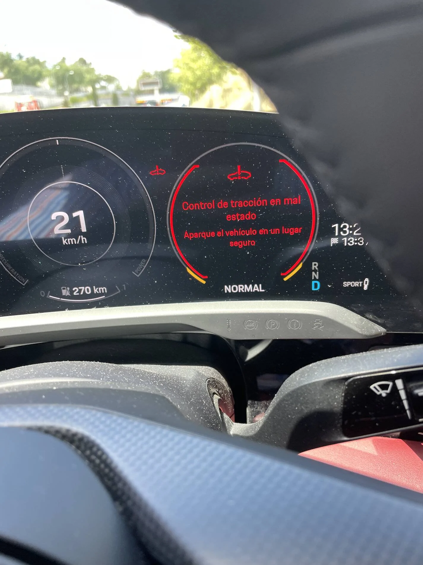

Suddenly when approaching an on-ramp to the highway, I got this message with no indication anything was wrong. I immediately put my right-hand indicator on, slowed and was able to take a parallel street and fortunately it had a clear parking lane. As I drove into it, the car started shuddering like it was going to fall apart ! The shuddering came from the rear axle and it felt like intermittent application of the parking brake every 0,1 seconds. I just turned the car off, and immediately on again. The message disappeared. I cautiously started driving around again and no more error messages. I immediately called my SA and took the car in so that they plugged it in. As usual, no codes indicating any major faults. Just a couple of suspicious readings from the front left and rear right, which I know where they came from. I parked about a month ago at a parking in Marbella and the ramp was so inclined that every car I saw, raised the front left wheel and then the right rear wheel ! So more baloney... nothing to do with this error. Anyway they reported to the mother ship in Germany.

They really need to get a handle on this issue. Is there an EU agency this can be reported to ?

Have a look at https://www.taycanforum.com/forum/t...ating-taycan-power-loss-issue.5062/post-73825, could be the same issue.
Also ask your PC if the car needs the software patch mentioned in https://www.taycanforum.com/forum/threads/motor-control-error-fix-2021.5336/post-73515
