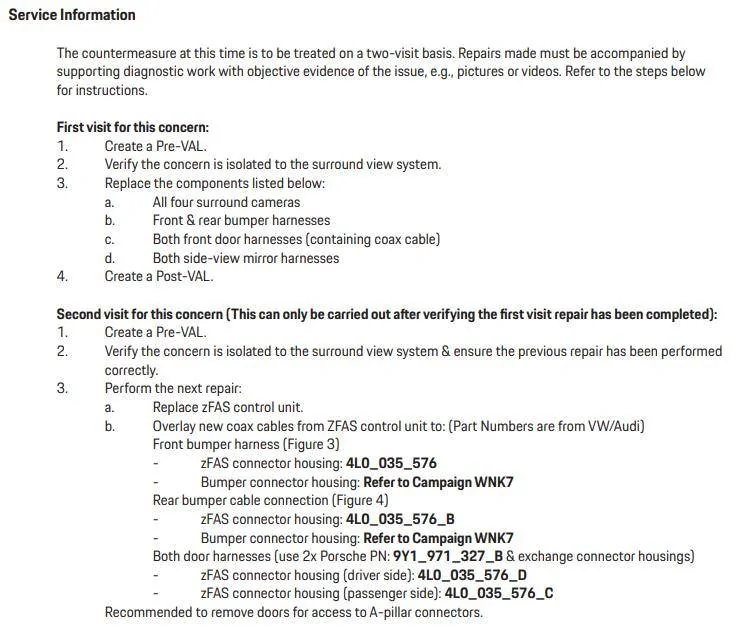

TSB: Surround View Camera Intermittent Operation - March 22, 2024

OP edited for updated TSB dated September 3, 2024

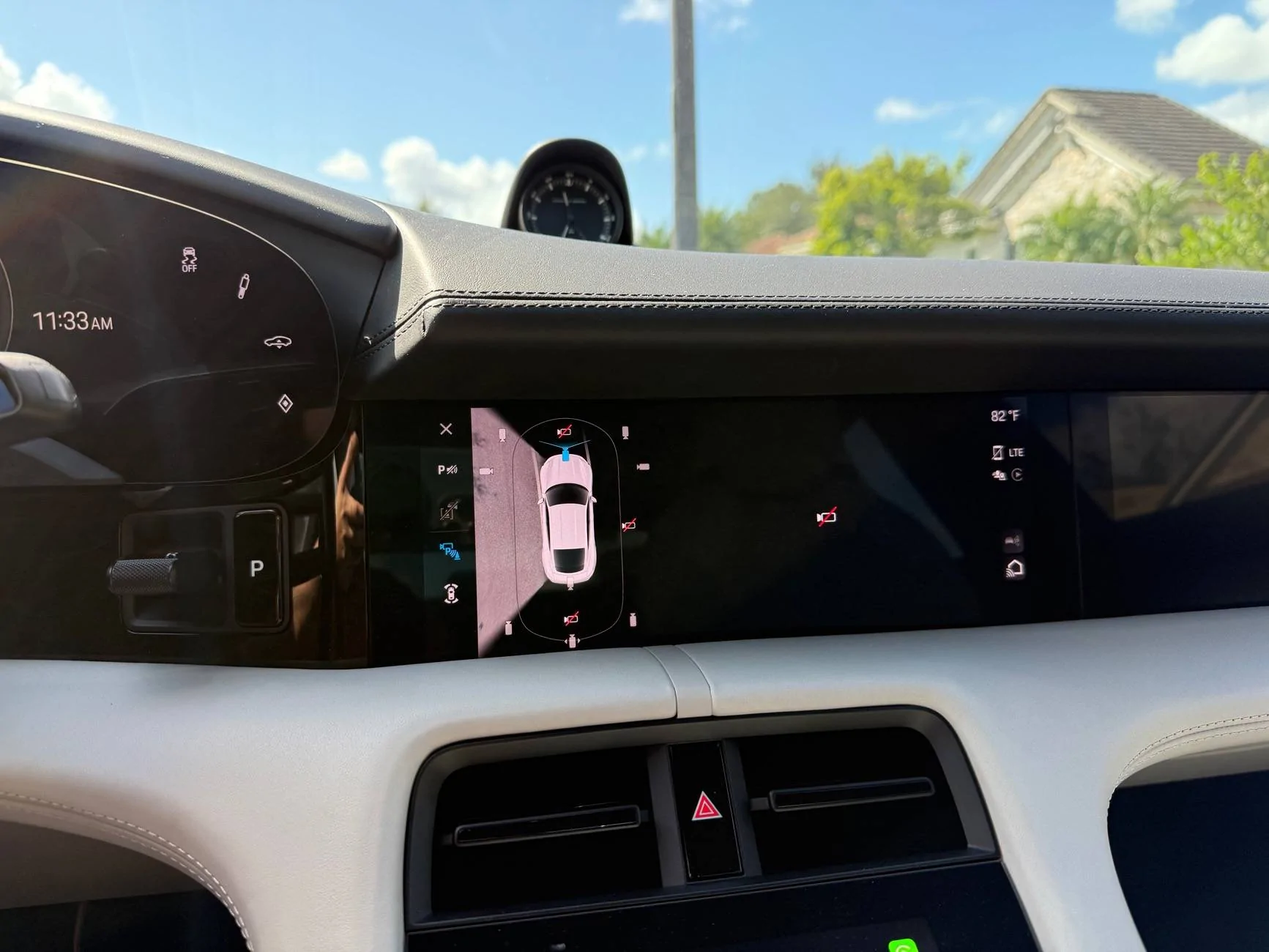

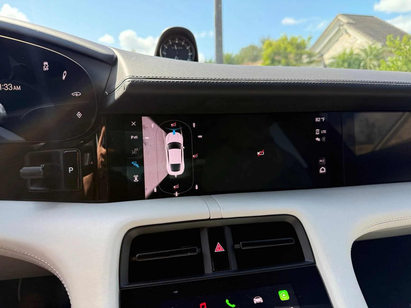

I have had the same problem 2 to 3 times over the last two years. The cameras typically sort themselves out after a few days and I think this is a water ingress issue.
I most recently had this problem about 2 to 3 weeks ago and took some video as well as pictures. When I took it to the dealership, they said that they could not find any error codes stored in the PCM and they would not replace The wiring harness despite video and photo documentation of the same. I pointed out the TSB to them as well.
They want to replicate the problem themselves. Unfortunately, they’re always booked out, and I cannot get in for several weeks. The problem self resolves by the time of service visit and the PCM probably clears of the codes.
apart from reaching out to PCNA, what are my options here? I raised a little stink with the dealership service manager today (Porsche Orlando) and they asked me to bring the car back in today for another evaluation.
Porsche Taycan TSB: Surround View Camera Intermittent Operation - March 22, 2024 IMG_5353
Porsche Taycan TSB: Surround View Camera Intermittent Operation - March 22, 2024 IMG_5352

They swapped the cameras and looms on mine. Hasn’t happened again.
