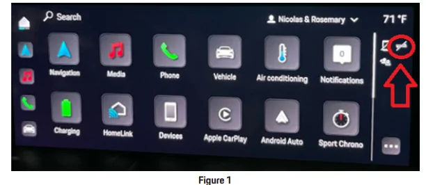

The customer reports that the vehicle loses LTE connectivity. On the right side of the PCM screen, the LTE icon
is replaced by two opposing horizontal arrows with a slash through them. (See figure 1.) In many cases, the
connectivity returns after a key cycle and workshop action is not necessary. In bad cases, the customer cannot recover connectivity and must visit the workshop.

The workshop can often recover LTE connectivity by resetting the ConBox. A simple way to do this is to deactivate Flight Mode.
To do this, use the PIWIS tester to navigate to the “Connect” control unit. Select “Maintenance repairs”.
Then, select: “Deactivate Flight mode” and follow the on screen prompts to completion.
