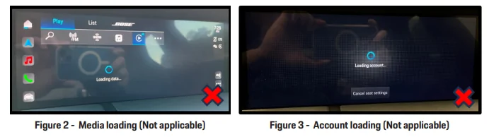

Condition:
Customer complains of PCM display stuck on loading spinner while Bluetooth and radio are still functional by
steering wheel buttons. (This ATI applies to the concern shown in Figure 1 but NOT Figures 2 & 3).
Technical Background:
There is a conflict in software between the PCM and display causing the display to be stuck in a loop. The fault
currently occurs after VR19.0.1-update has been performed, affecting PCMs at software versions 3793 & 3823.
There are no fault codes associated with the display issue. Refer to the images below for the correct condition that applies to the concern.
Porsche Taycan TSB: PCM Display Stuck on Loading Spinner - Feb 14, 2024 1710461796205-tj
Porsche Taycan TSB: PCM Display Stuck on Loading Spinner - Feb 14, 2024 1710461849833-qi
Service Information:
The software solution is to update the PCM software to version 3882.
Follow Campaign WPN9.
https://static.nhtsa.gov/odi/tsbs/2024/MC-10251187-0001.pdf
