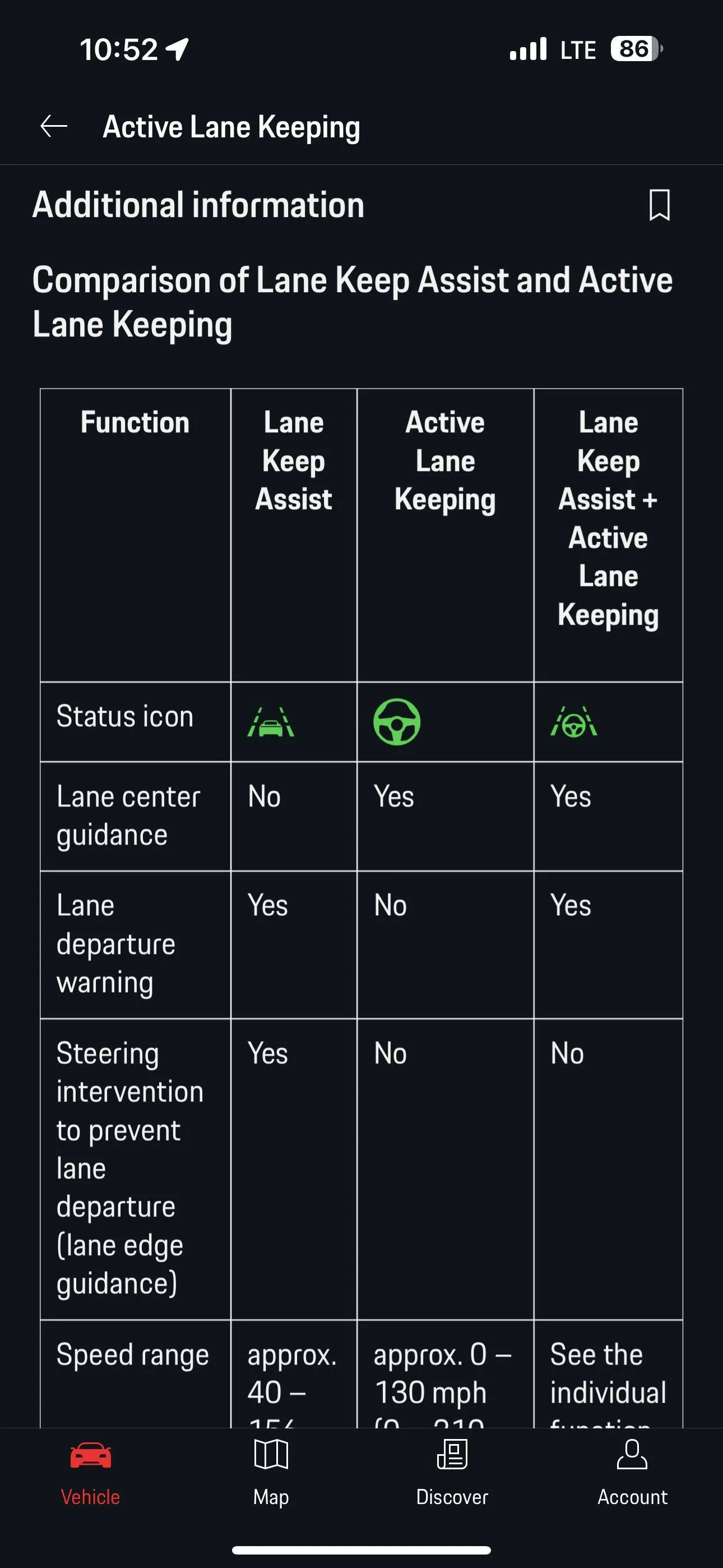

I’m not sure some of the explanations here are correct. But the manual does explain the difference between Lane Keep Assist and Active Lane Keeping, and the display notifications that accompany the two different systems.
Porsche Taycan Two minor InnoDrive/ACC/ALK observations IMG_1039

Ah okay, so I guess in my case yesterday, the car was still providing "lane center guidance" (and steering to keep the lane center, presumably), but would not care, not try to prevent, lane departure?
Actually, that is consistent with my explanation. As with all topics, the manual only provides half of the story and leaves out the practical explanation.
when the steering wheel is green and the lane markers are grey, it follows the car in front and it is as if the lane markers do not exist. If the car crosses the lane markers under these circumstances, so will you because it’s as if the lane markers do not exist.
If both lane markers are green, the car will center between them, but if one is grey and the other is green, it cannot center because it’s as if the grey lane marker does not exist.
That is correct. Currently I use Lane Centering without Lane Keep Assist. They are two independent systems with different functions that can be toggled on/off individually as desired.
When Lane Keep Assist is toggled to the off position in the car, you no longer have the lines indicator in the display, gray or green.
As for functionality, I do not believe from experience, nor from reading, that either of these systems is dependent on a vehicle in front of your car to operate. Perhaps a vehicle in front can influence the Taycan’s decision making with certain actions, but you can have the full functionality of the systems while completely alone on the road.
