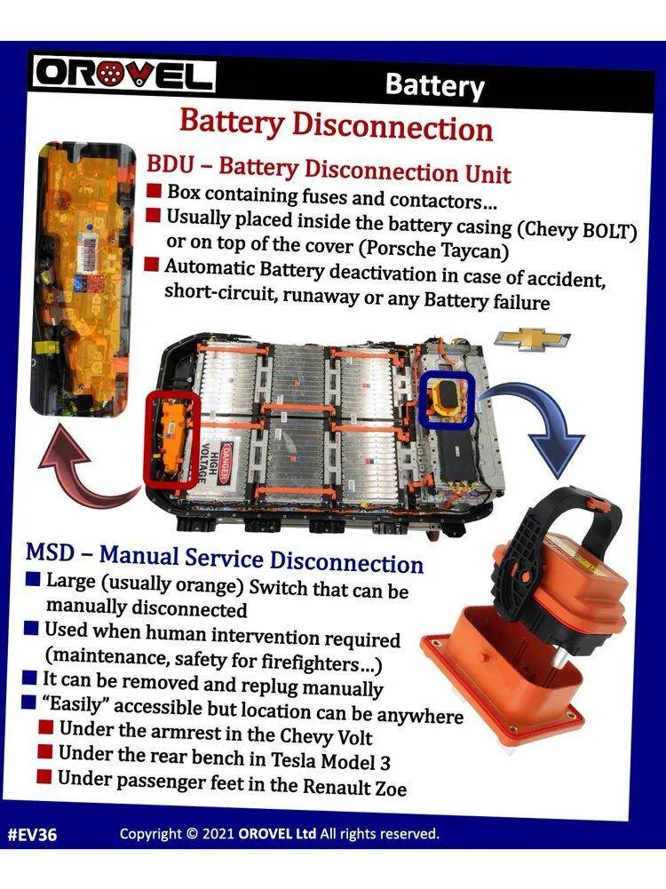

Maybe these links could be helpful:
Battery Disconnect
OROVEL
The image below is not a Taycan battery pack (possibly as Chevrolet Bolt), though it does note "Battery Disconnection" location as "on top of the cover (Porsche Taycan)."

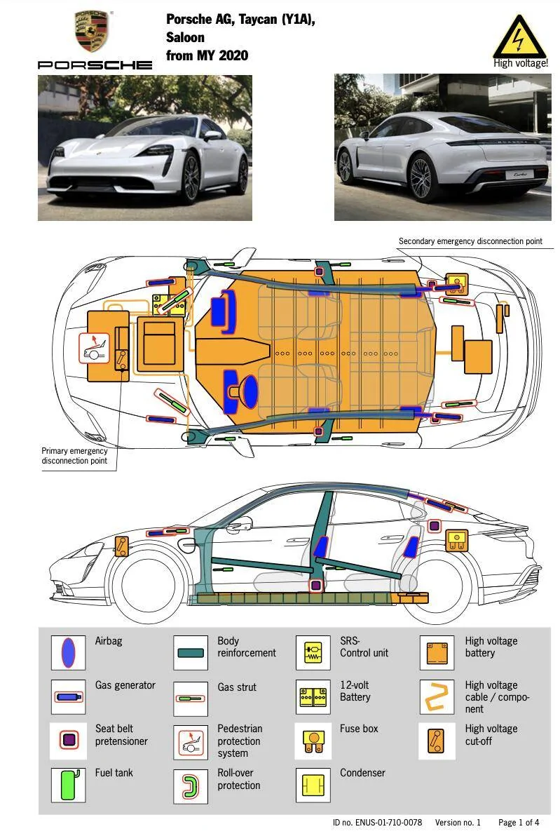

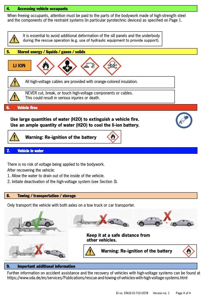

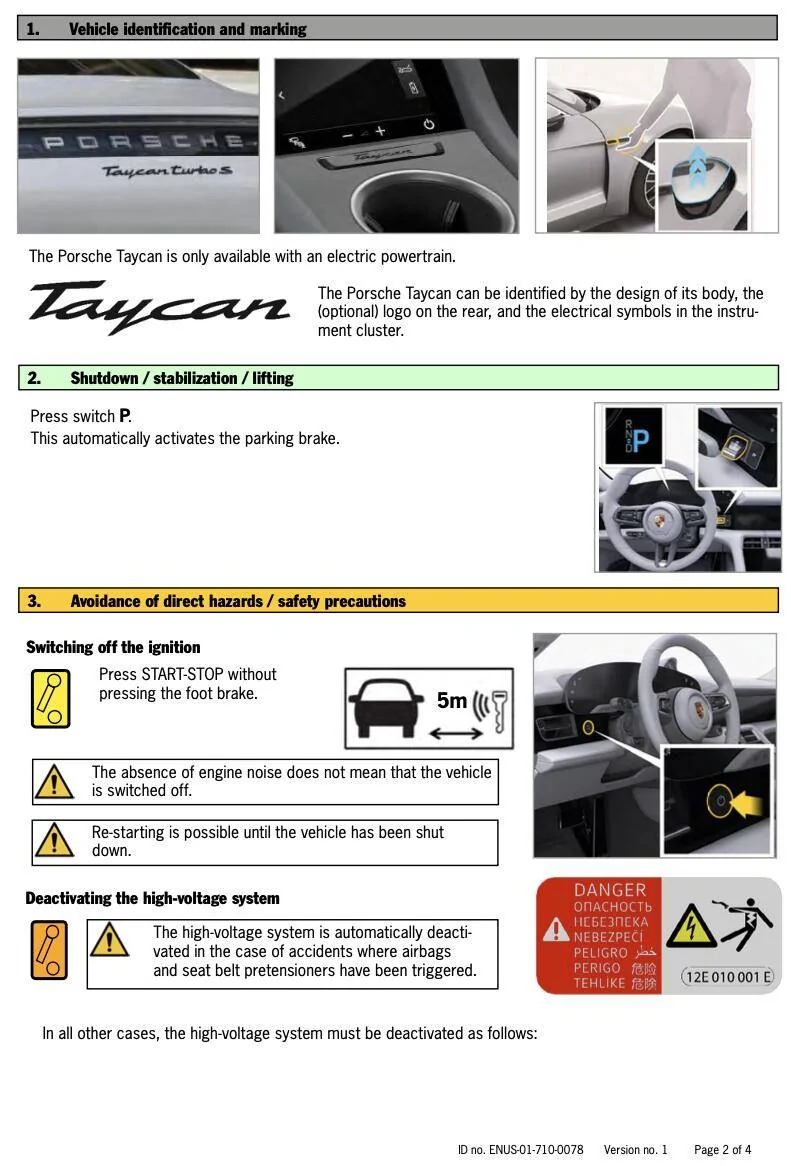

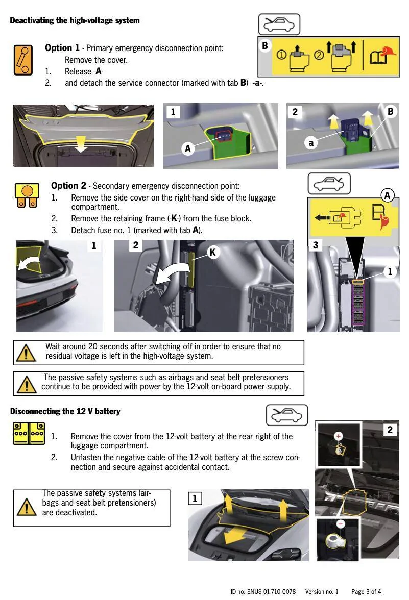

Here are Taycan relevant pages from (an OLDER 2020) 'Rescue' manual, a PDF on emergency disconnects etc - can ref the GTK app and/or current car's manual (digital or physical) for most up to date info:
