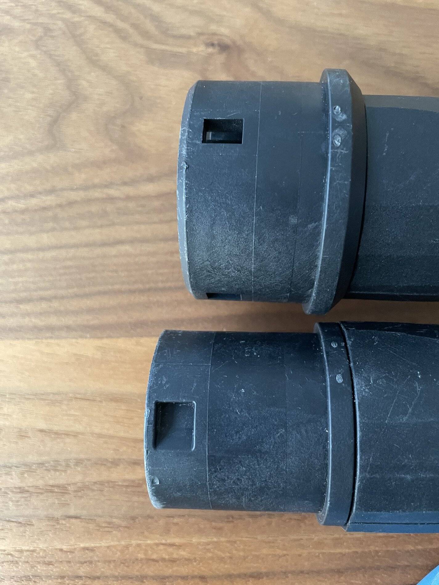

Hi Carl,
You'll find that it's not possible to use an extension lead such as the one in this link beween the PMCC and your car. The male end of the extension lead is designed to plug into a female port in an unthethered charging point (one with no cable attached). When you plug the male end of the extension cable into the female plug on the end of the cable from your PMCC, you'll find that the pins aren't long enough. See the lower plug on the image attached. I believe the plugs are designed like this to stop you doing what you are proposing.
So whatever you do the PMCC needs to be plugged directly into the car - perhaps you can extend the 40 Amp supply somehow?
Porsche Taycan Type 2 extension cable with the PMCC File_000

Hi Carl,
Hi Anthony,
Thanks for the feedback, I am a little confused as the website does say it can only be used to extend a type two cable but what you stated does make sense and I considered the different socket sizes.
My “plan b” is to install a twin commando socket and have both chargers connected, I would only be able to use one at a time, but as I only have one EV then that should be ok.
