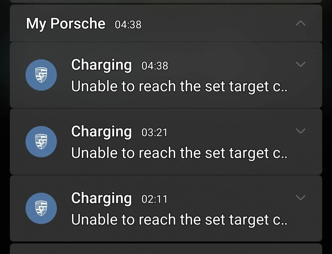

I was having issues with my car not charging fully overnight. I kept getting the app notification 'unable to reach set charge' (pic)
The unit is a Sync EV.
I assumed it was the car at fault.
But I contacted Sync and they monitored it. They said it was cutting out as it was getting too hot.
They also said it was (I'm no electrician) a very high voltage to the house? and that was the cause. Not much they could do about the high level - that would have to be through electricity provider/grid.
But they tweaked the settings to stop it cutting out and it's been OK since.

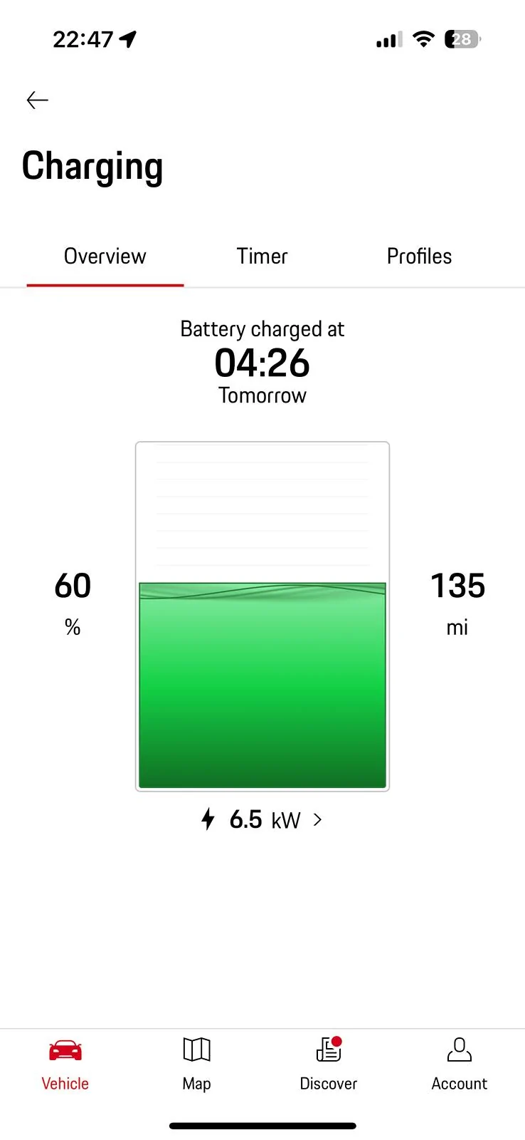

Cars charging at the brothers right now with my cable on same side
Porsche Taycan UK - Charger issues, High Temperature 1718833749448-mz
11,063
6,846
Ok so looks to be fine then assuming the session didn't complete successfully.
Suggests either your EVSE or the supply - my guess is the supply or termination point where your EVSE connects (the short cable / connector) has the issue.
