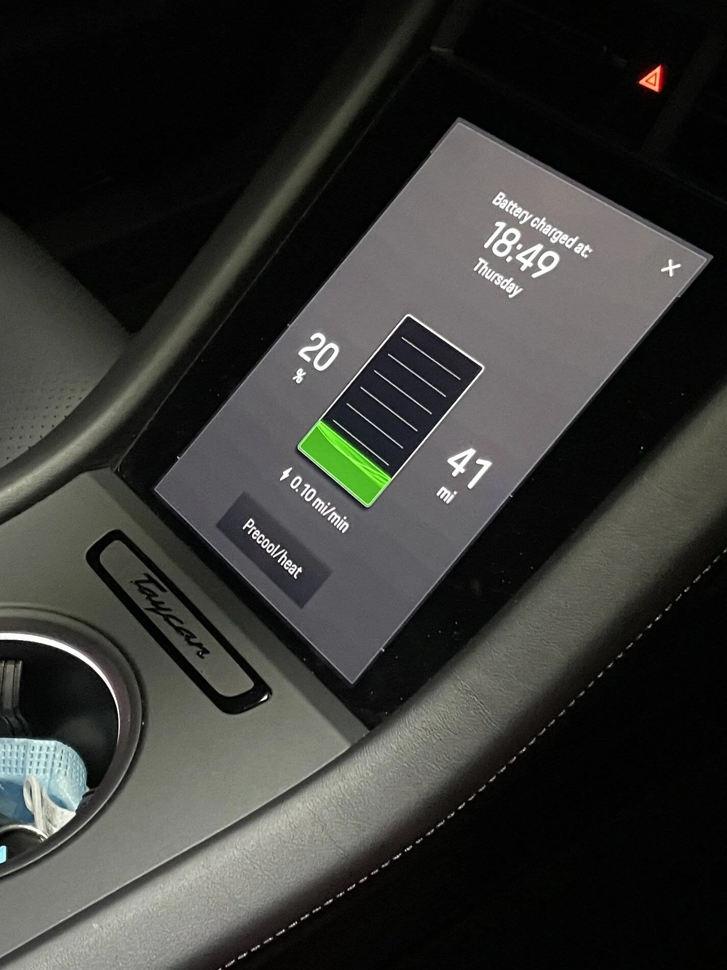

Hi guys,
I have a loan car for the day. It’s a brilliant 4s in crayon with an amazing spec.
I have a panamera 4e hybrid so am considering the change.
I have a rolec 7.2ke charger installed at home running of its own 32amp fuse board.
ive plugged the car in using the type 2 cable I had for my Panamera and also tried the cables that come with the 4S and when I plug it in, the console reports charging at 0.10mi/min
Can anyone tell me if this is right? I’m a bit confused on all this kw/h and need to know if my charger is not suitable
I know I have single phase and my rolec seemed to charge my panamera with 3 odd hours.
Is there something I have to set.
In my sons polestar there is a setting where we can restrict the car to a certain ampage and he has his set to 32amp l.
Would really appreciate someone giving me a realistic “how long does it take to charge a 4s to full over a Uk home with a 7.2kw charger which I understand is quiet common for a home ev install.

Press on that 0.1 mile/ min and change it to kW! Than you will see how much power goes into the battery!

Ok thanks. So it shows 3.35kW
I thought I had a proper charger which the installer said was 7.2kw.
Could it be the cable or any settings I need to adjust

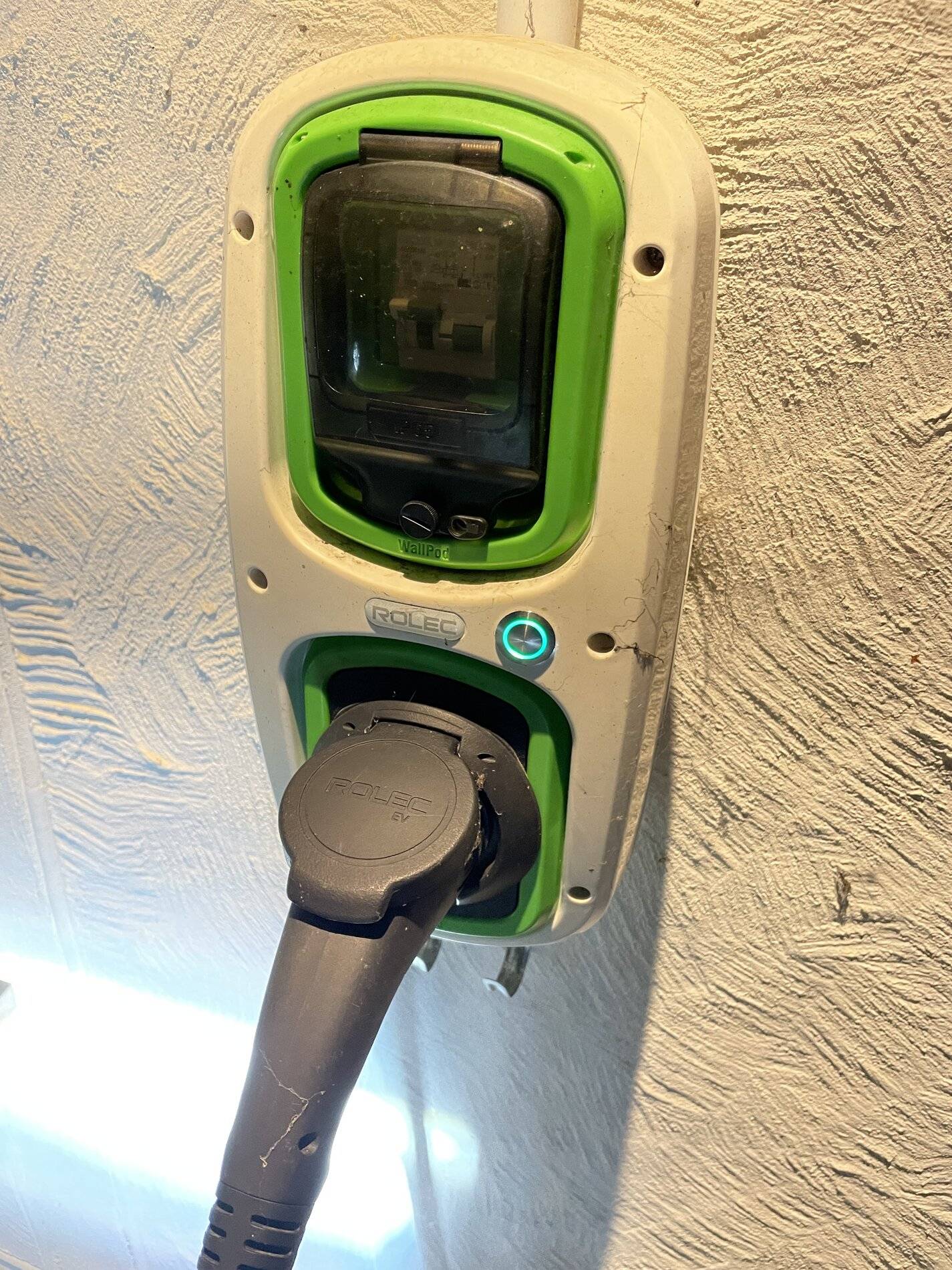

Doesn’t look like it’s set up for 7.2kw charging. Mine reads 0.3 miles per minute on a 7.2kw rolec charger

Is it definitely a 32A (7.2Kw) charger? only reason I ask is that I’m pretty sure a Rolex do 16A ones too, which would account for the low rate. Or (as suggested above) it’s not configured to 32A.
What’s the rating of the MCB behind the perspex panel? If It’s 40A then it’s a 7.2Kw unit which I guess must be configured lower somewhere.

So the rolec has a breaker on it but it doesn’t indicate any ampage but it does have something that says 40A
however I came home and then found a Porsche cable which is listed as a 32amp cable and it started charging at 6.34 showing 0.30mi/min
worked for 10 mins to 20 mins and thenthe fuse board trips.
Tried a few times and same problem
then I used the same cable and plugged it into my sons polestar2. It works and is charging at 31amps according to his screen. Been on charge for 1hr and it hasn’t tripped.

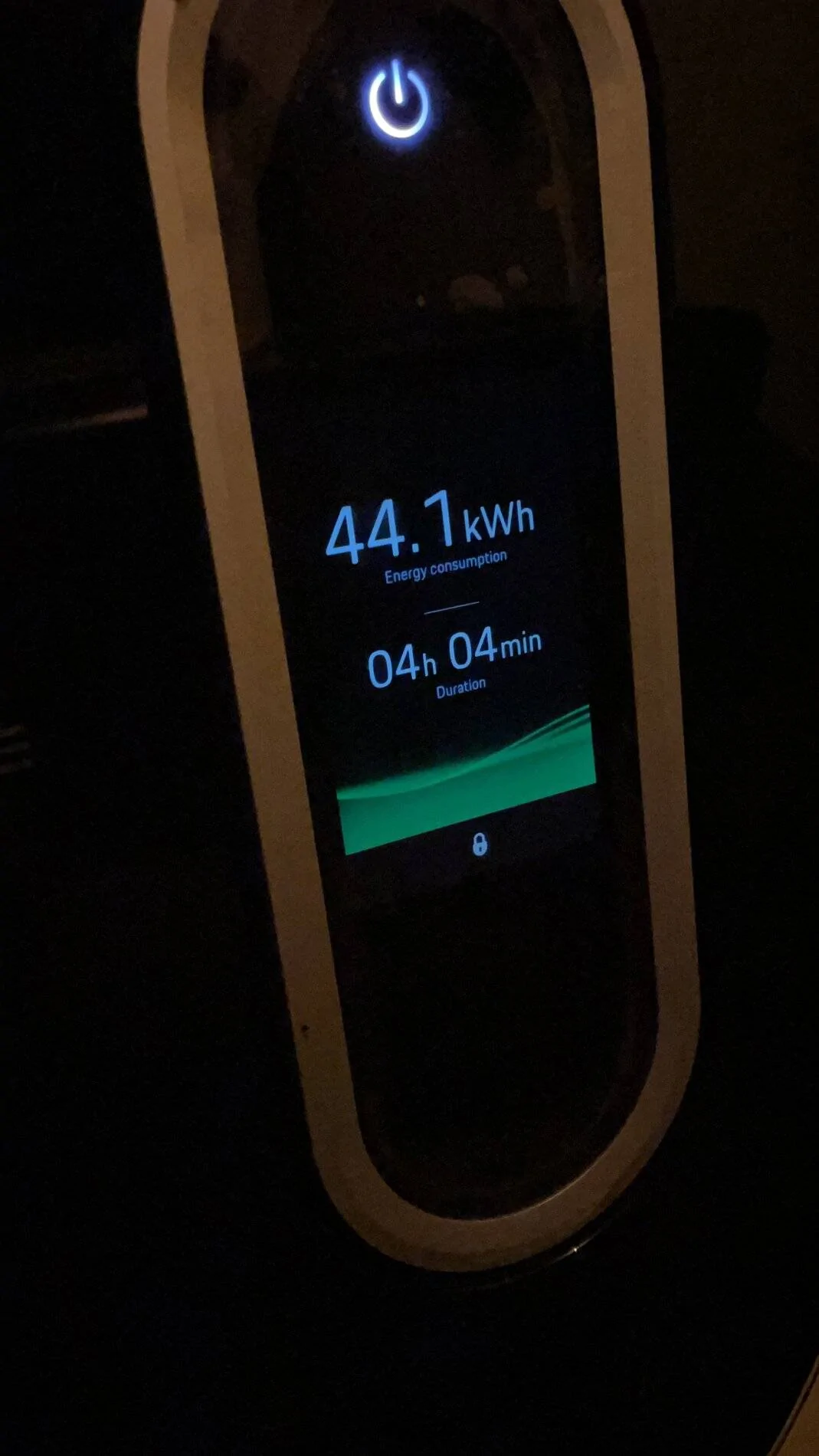

I’ve just exactly this. Swapped out a rolec 32a charger for the Porsche charger connect. i have the charger on its own circuit but even so the Rolec almost always tripped the house distribution board. (We also have an electric Aga so the amps draw could be large). What I found is the Porsche is much more gentle on the power draw... it starts off low and increases to its max available. So far we’ve had no trips at all.

I’m getting the full 11kwh speed on a 3 phase but when I check on the information on pmcc it’s only taking 16amps constant . Shouldn’t it be taking the max 32 out of 32 amp? I don’t have the 22kw optional onboard charger so restricted to the max 11

On 3 phase it will be drawing 16A to get ~11kW (16*3*240) - it will only draw 32A on 3 phase if you are setup for 22kW charging. Single phase is different as 32A will be used to get the ~7.4 kW. The exact amount depends on your local voltage.
