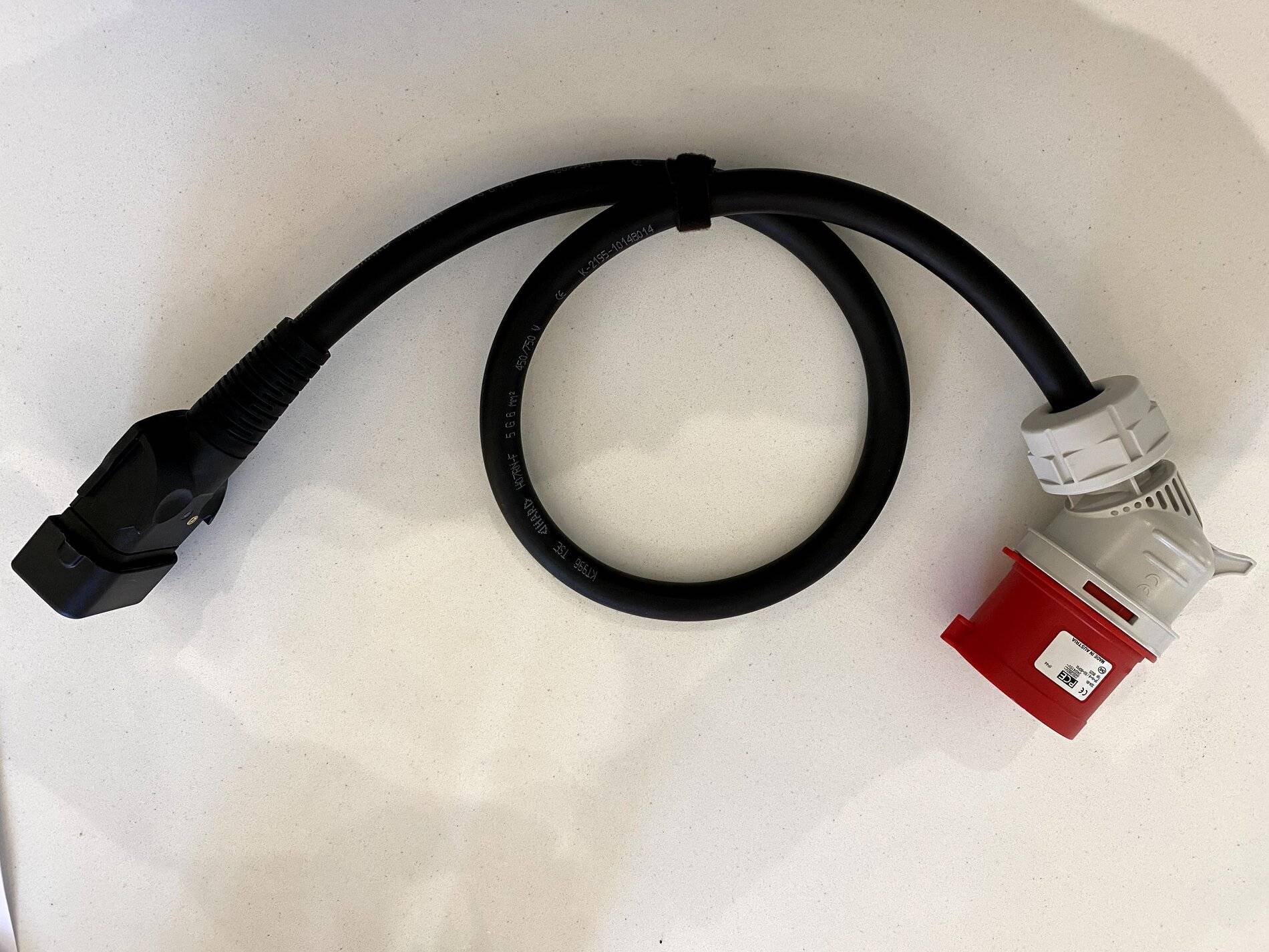

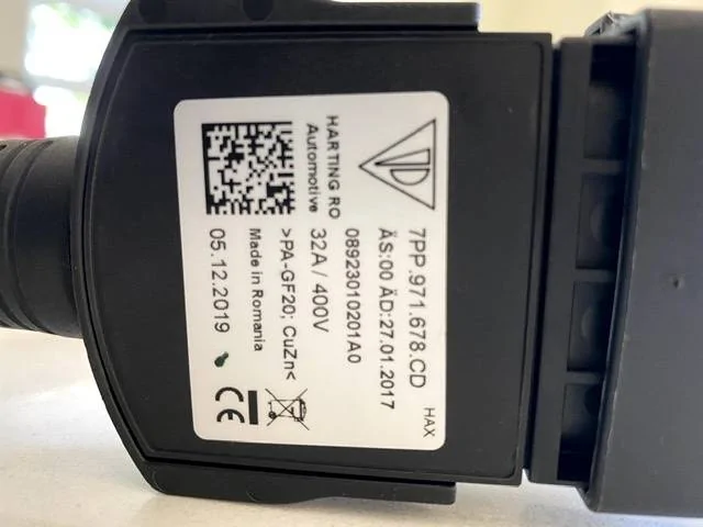

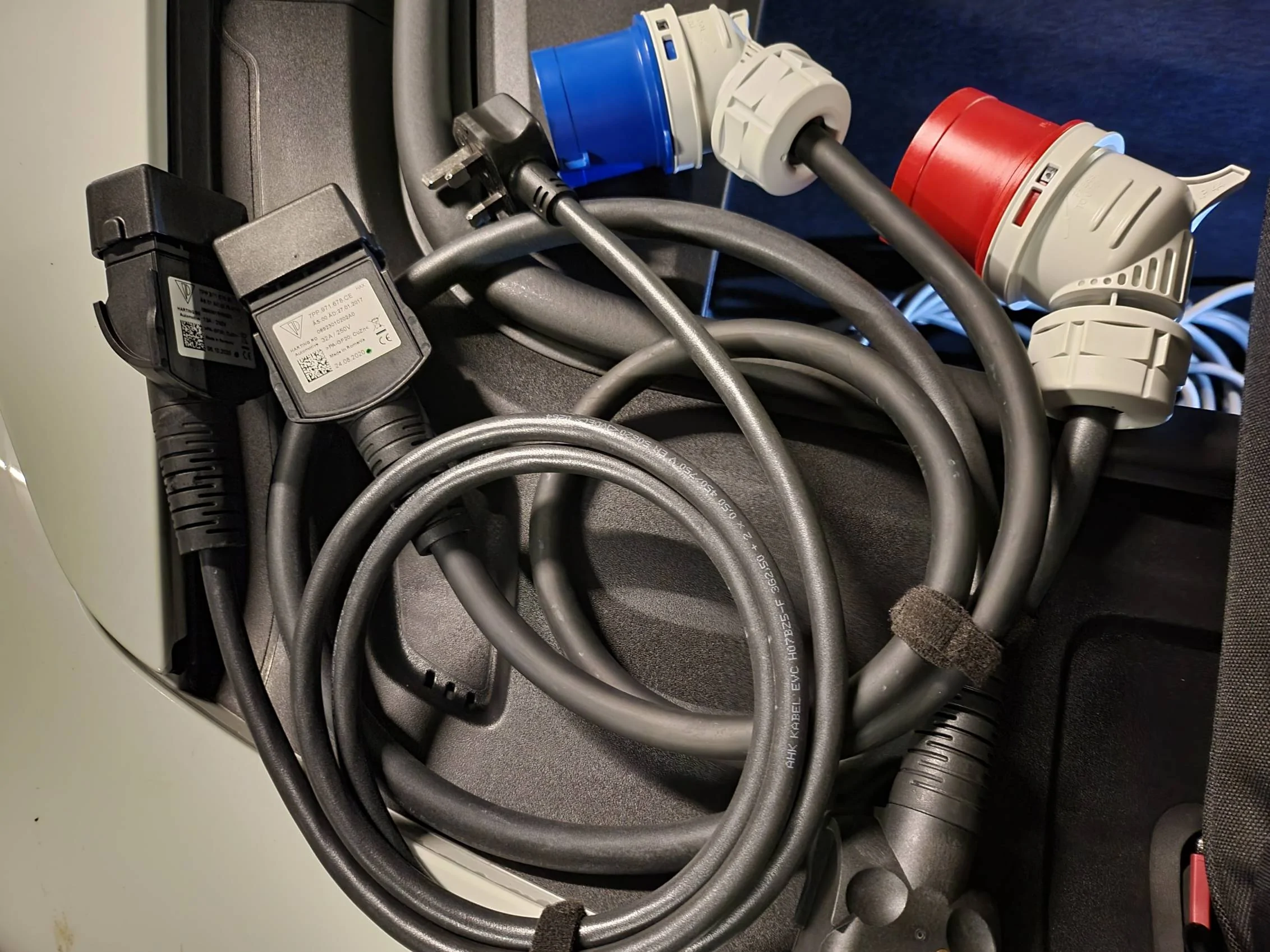

Hi, I just saw your post. If you still cannot find that cable or anyone finding one, I got it from ECS Tuning. The part number may be different but it is indeed 3Ph 400v 32A.
Porsche Taycan Wanted: PMC Plus - Red 32amp 400v supply cable 20220110_111155
Porsche Taycan Wanted: PMC Plus - Red 32amp 400v supply cable 20211229_004148
Got all three of them.
P.S. I've got a 22kW PMCC.
