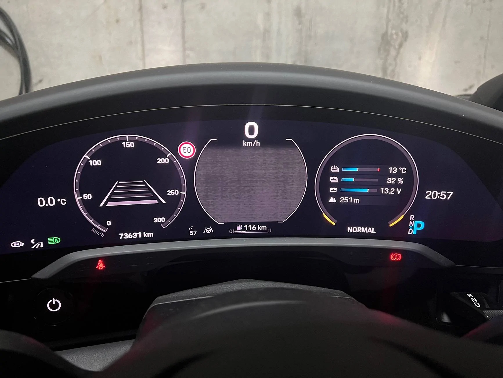

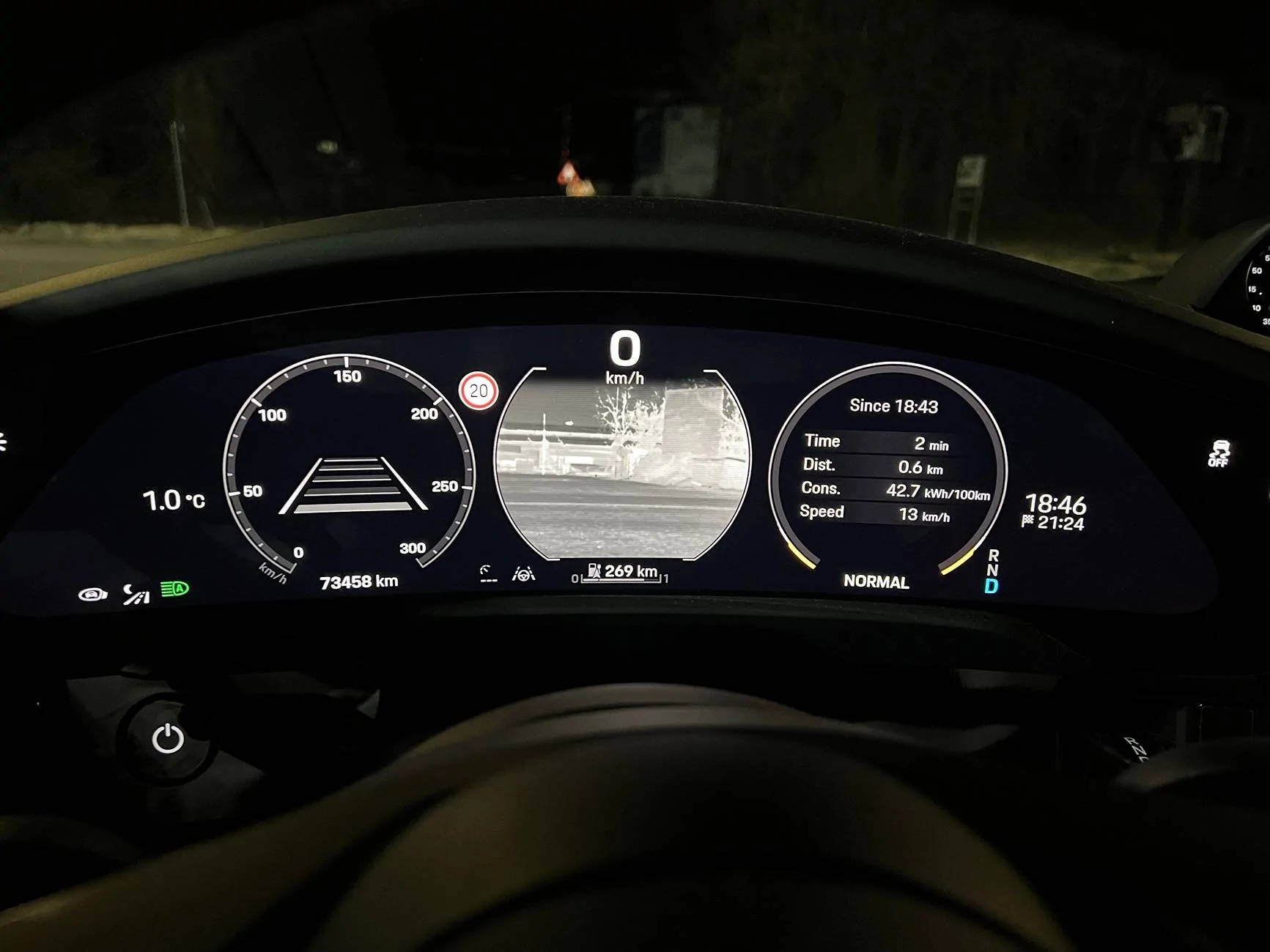

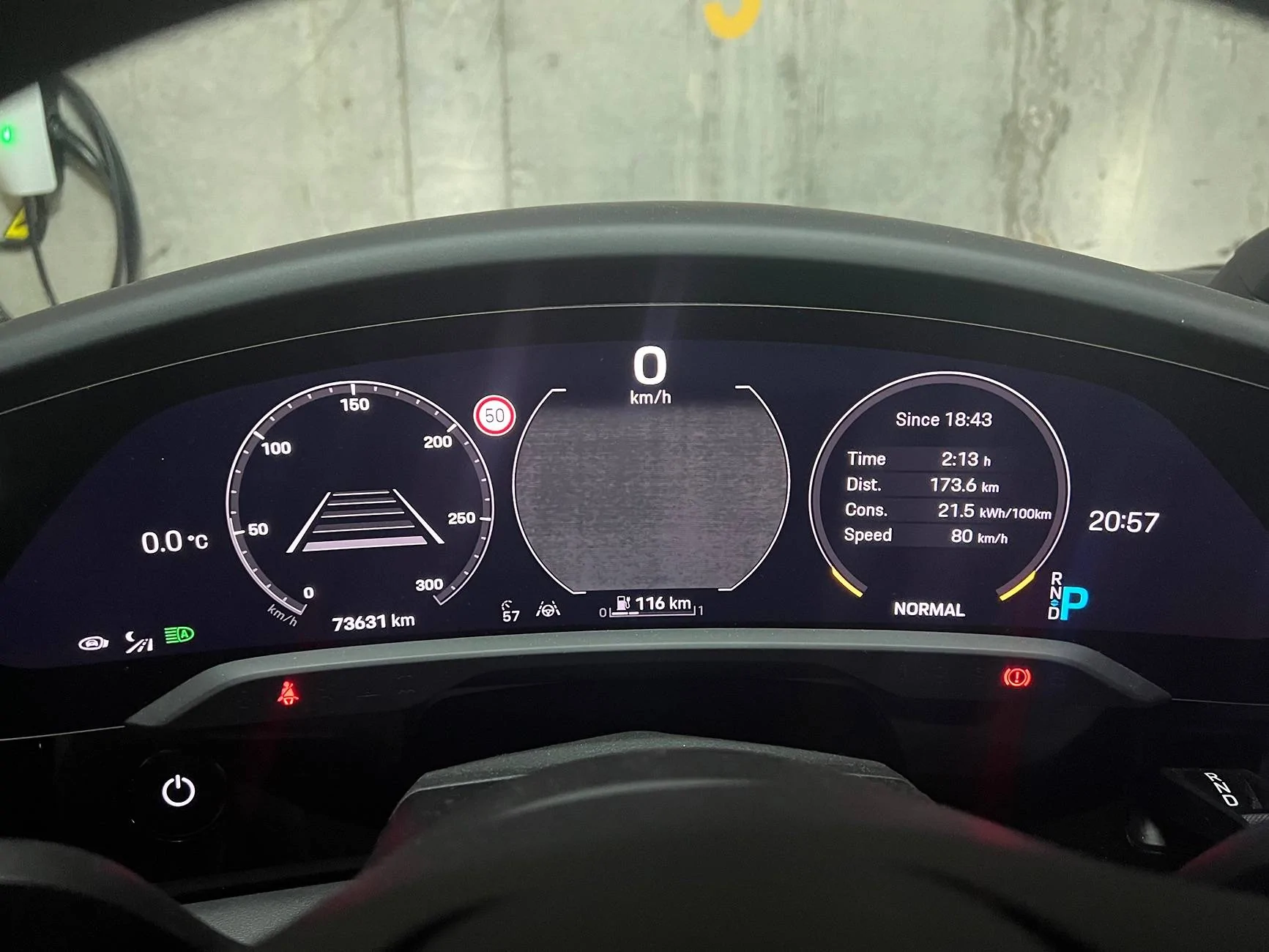

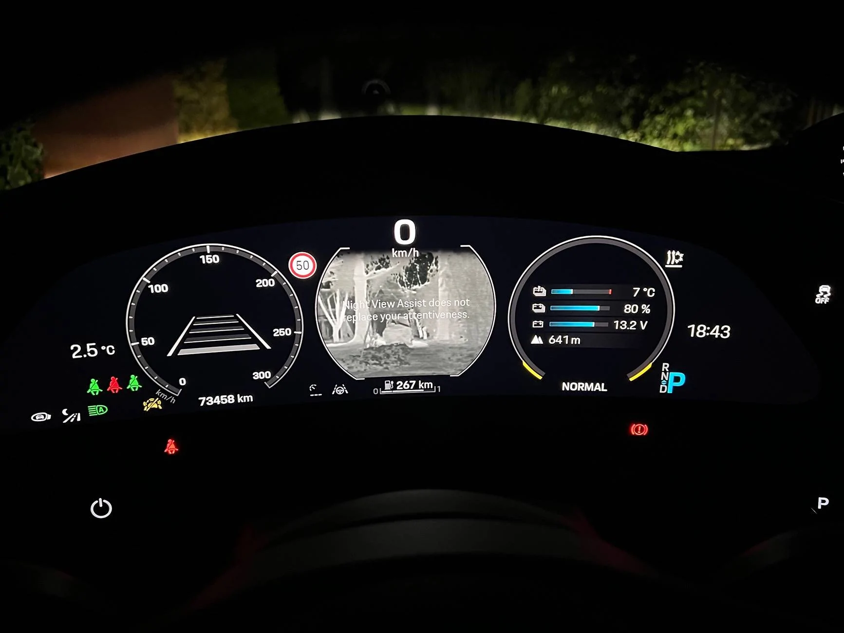

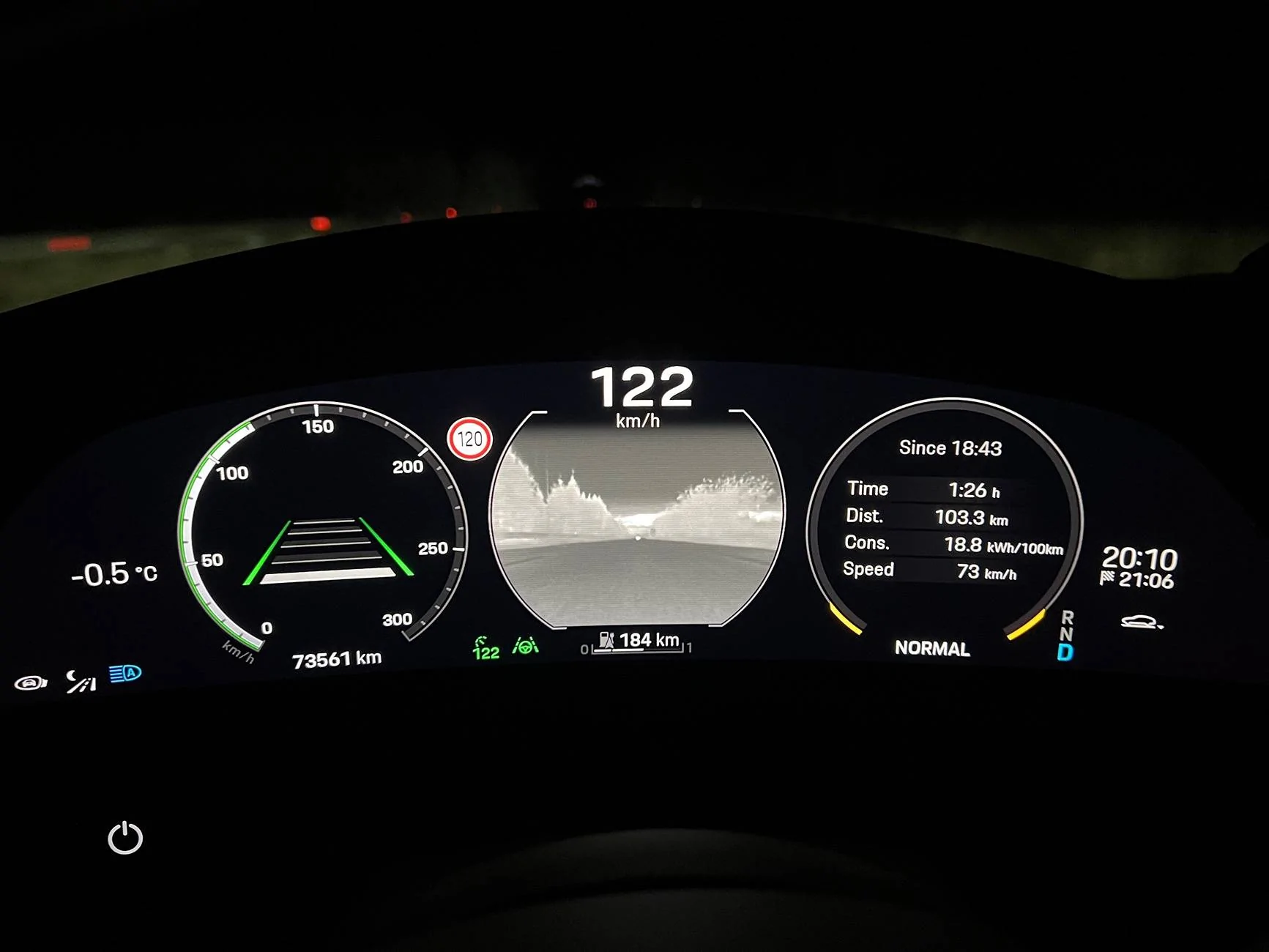

START: 2 minutes of preheat before leaving, charged to 100% in the morning, spent 20% until noon, car sat at 80% until leaving in the evening. Temperature max 2.5C instantly dropping to 1C, hovering around 0C 90% of the way with a minimum of -0.5C. AC+ECO @22.5C Normal mode.
21.5 * 173.6 / 48 = 77.758KWh NETT
Hinting to an SOH of 89.7%
I’ve fully discharged and charged since last time and the % accuracy has improved, but not to pre ARB7 level.
Car scanner still showing 94.1% SOH which should give 86.7*0.941=81.58KWh NETT inline with he number I’ve been getting the past 9 months doing the first calculation. Has the buffer been increased by ~4.5%?
