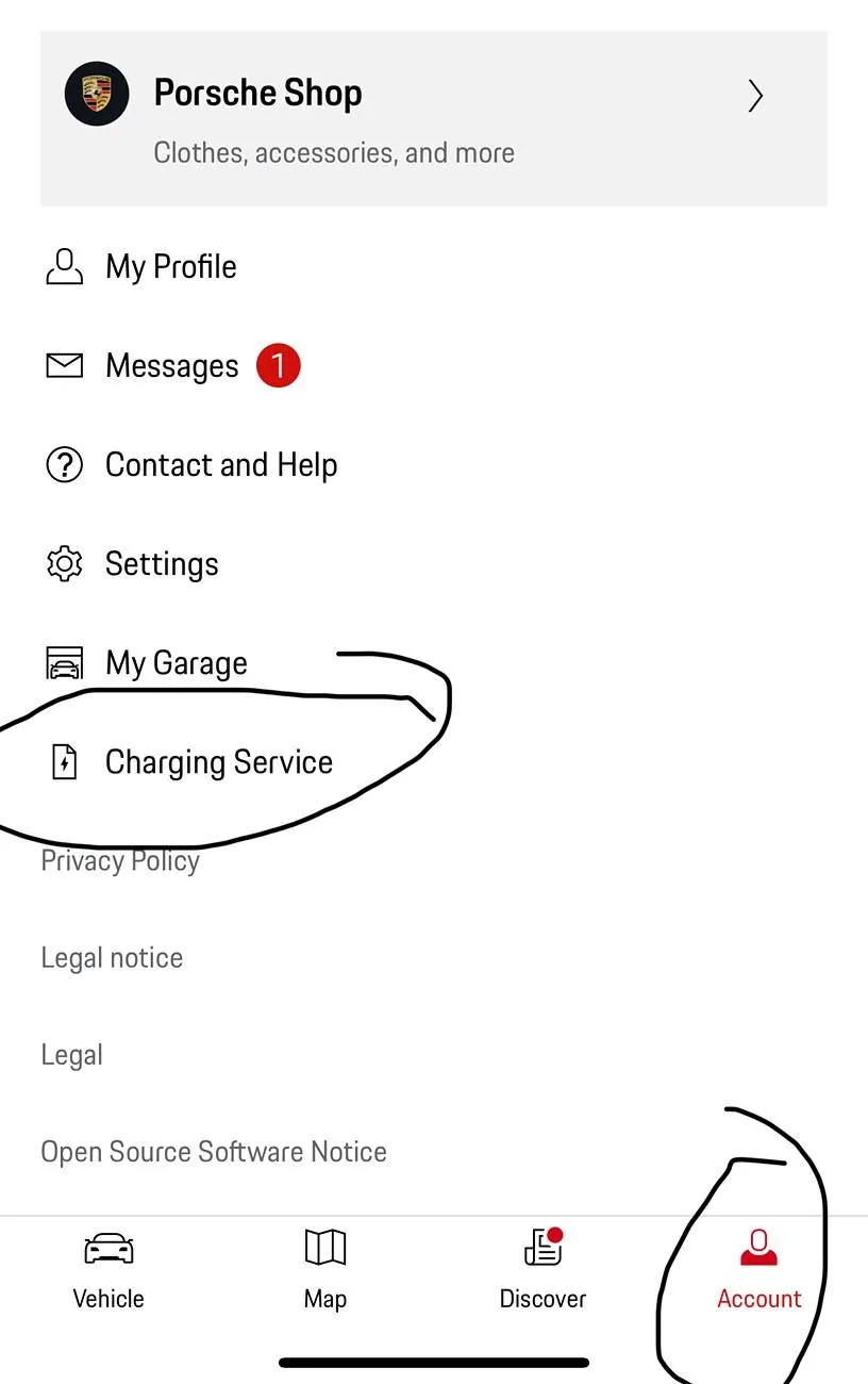

If you go to the Porsche app then account, then charging, it should show the serial of the active card. However I don’t know if the card has that printed on it. You might be able to use a generic rfid reader app to find it from the card.

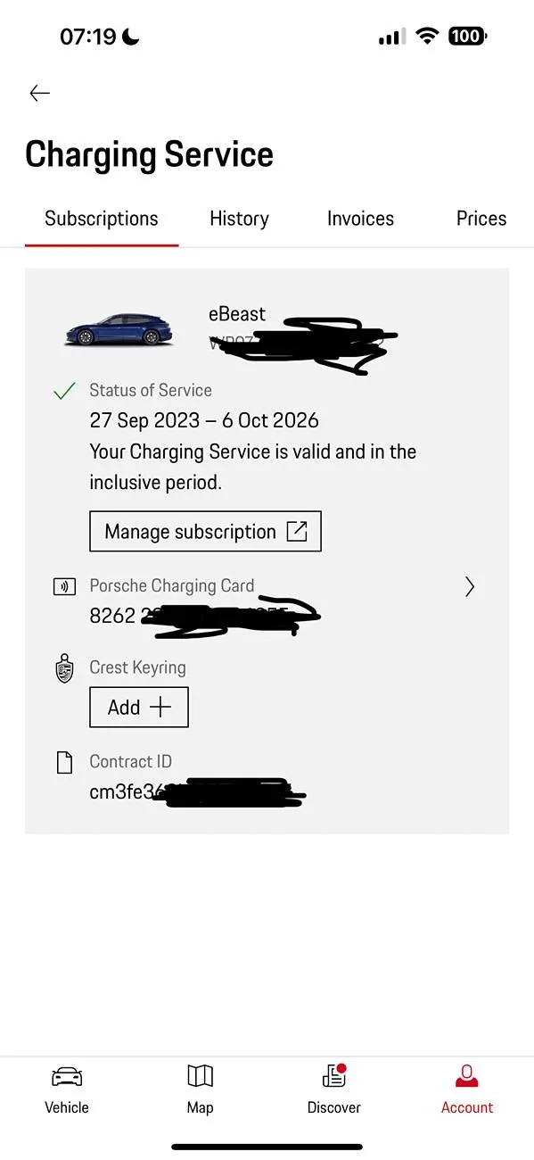

this is what I see:
Porsche Taycan Which charging card is Live? IMG_0509
Porsche Taycan Which charging card is Live? IMG_0510

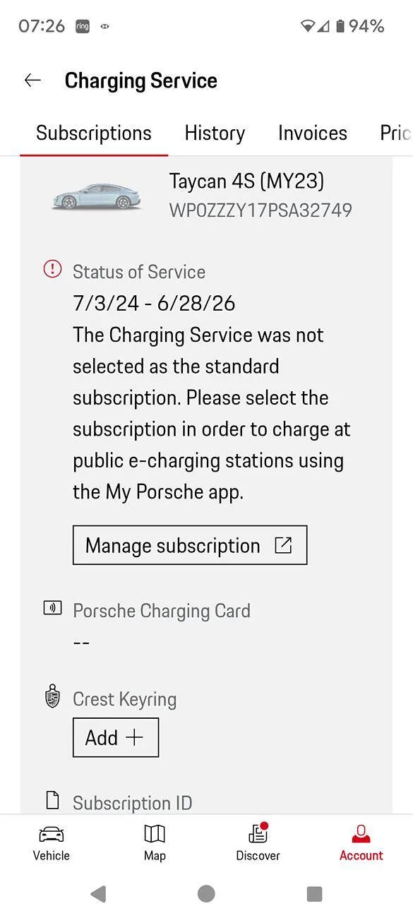

This maybe my problem then.
Cards have worked fine for 4 years until now..
Porsche Taycan Which charging card is Live? Screenshot_20240704-072600

I found that last night, never knew it was there. Just used it on an Ionity in Belgium and worked great.
I've never seen that in 4 years!
