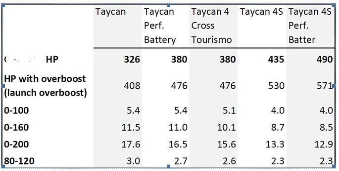

Had stored this at some point.
Hopefully is still up to date/relevant?

I do think PB+ os one of the cheapest options porsche offers compared to value. There is $ value attributable to perf pick up after 30 mph., which I calculated to be a MIN ~$2600, using a pretty objective math. Hear me out. There seems to be consensus in forums that an upgrade to 4S from RWD is perfectly justified (if not mandatory to some) given the performance difference. The price difference between 4S and a rwd is $13,800 in the us (for similar batteries, after adjusting the list price difference by $5000 to capture air suspension and an attributed value to 4 wheel drive). In the case of 4S vs RWD, $13,800 buys you a 0-160km/h time improvement of 23%. (Per the table above). Which converts to $600 per 1% improvement. Now PB+ improves 0-160kmh performance of the RWD by 4.3%. Yes a more modest improvement compared to 4S jump but shouldn’t it have any value? If we use the same “price per % improvement” factor: $600x4.3=$2600. Now i used 0-160kmh as a basis as i think this is the typical speed band an enthusiast spends seeks the maximum power during spirited driving. If i were to use 0-200kmh band as a basis valuation goes up to $4000 (probably more relevant if I lived in Germany). Now this calc ignores the handling impact of weight differences between models, which some of us are very sensitive about. But for most of us who does not have the balls to push into race driver limits, weight difference in the entire range does not seem to have a noticeable impact on driving experience. (Many magazine reviews seem to have the same conclusion). Bottom line i think it is fair to attribute ~50% of the PB+ price to marginal perf improvement, which leaves a small price pay for the range pick up.
I think the real world figure that people experience the most often (and should be used) is the 80-120km/h.
That is far more relevant every time you accelerate while on the move, not the limited number of standing starts to high speed (using Launch Control).
I for one seldom get a chance to even attempt those on public roads.
80-120km/h is a 10% improvement in the RWD PB+ over PB.
Which considering the bigger battery also buys you extra range (and likely retains a good proportion of its value) makes it good value.
It also brings the RWD nearly half way closer to the 4S 'in gear times'.
Whether the PB+ provides a better driving experience is another matter.
I bet it doesn't as it adds weight.
Also a separate issue to pay for the jump up to the 4S.

Loving these stats!
Does anyone actually use launch control other than in the few few weeks when the car is new, not sure about others but I find it difficult to find places suitable to test it, in my BMW as it takes around 30 seconds to go through the procedure and often does not engage first time!
Therefore as stated above the main factors in 4S PB+ VS 4S PB are short term acceleration (where both PB+/PB are the same) and 80-120 (again where they are the same).
This debate is not about what I can afford but more about getting the best 'bang for buck' I think the 4S looks to have this in terms of 'sweet spot' in the range and the standard PB is only of value if you need the extra range.
