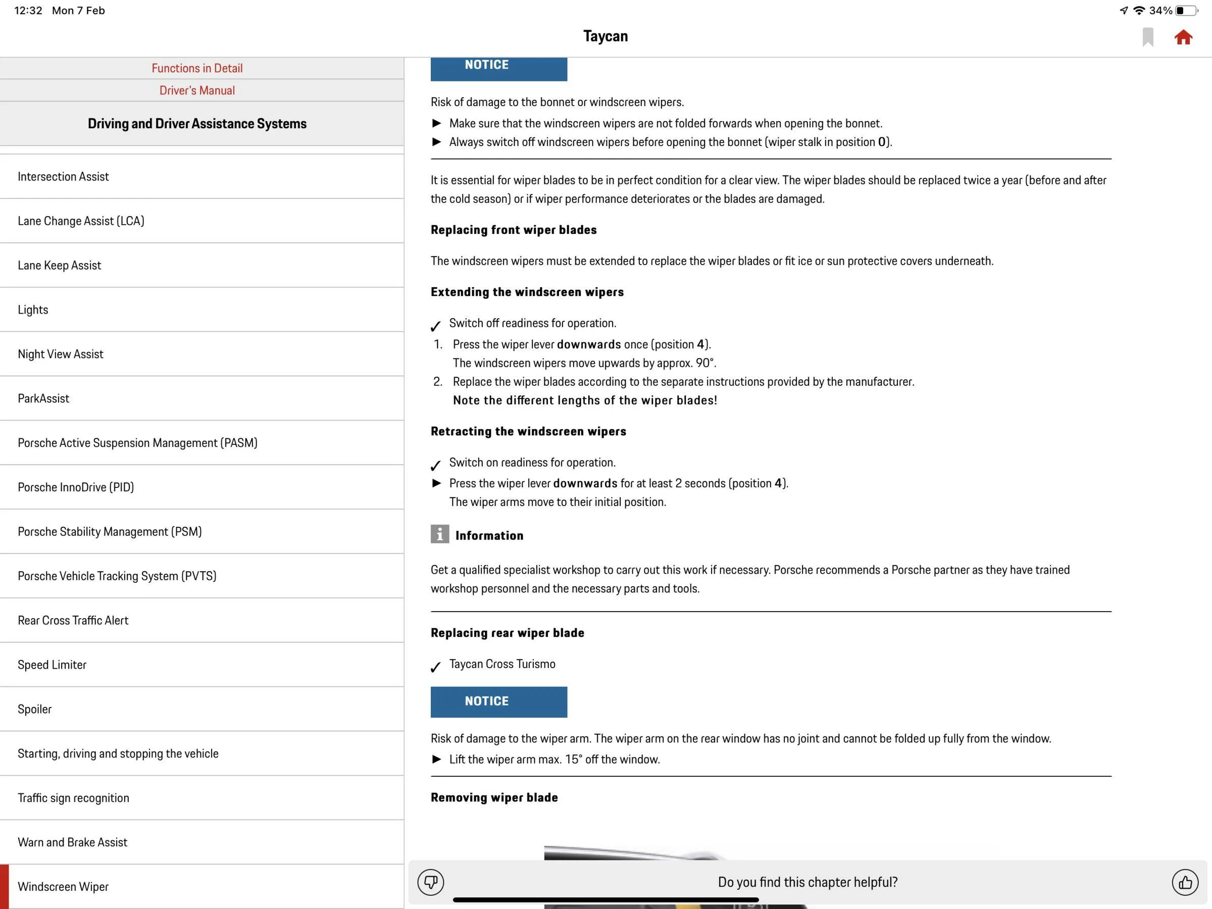

As explained earlier - really simple and documented in the Porsche Good to Know App if you need pictures etc.
1. Power off
2. Push the wiper stalk down once as if to flick wipe - 1 sec or so (or 1 Mississippi!)
3. Service mode reached
If you open the door after power off and before you've attempted service mode the power is cut and it won't work - the door comment is therefore significant.
Once in service mode, to place back to normal:
1. Power on
2. Push the wiper stalk down once as if to flick wipe - 2 sec (or 2 Mississippis)
