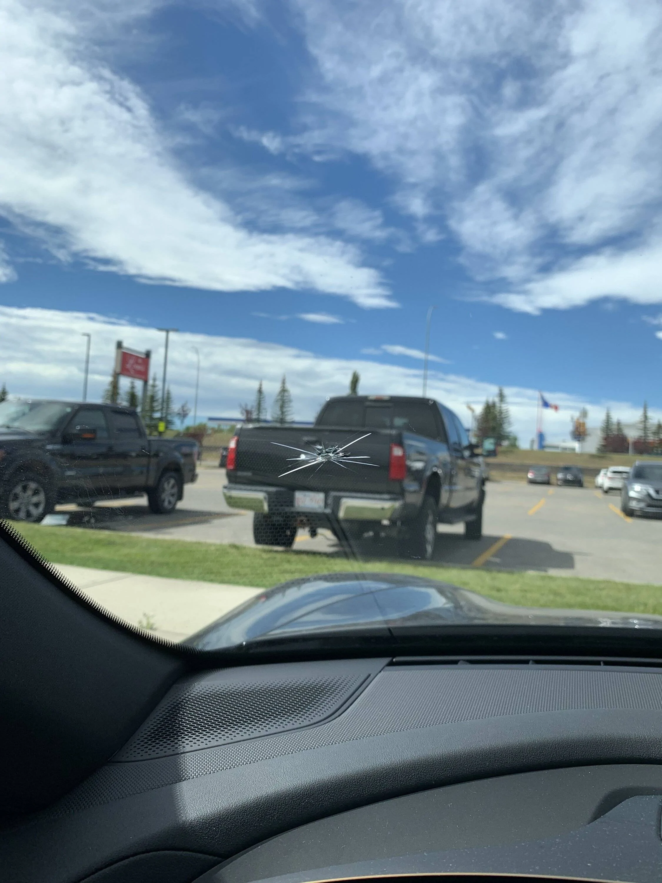

Got a pretty bad rock chip in my windshield. Luckily I have the windshield protection plan and plan on replacing the windshield but I wanted to wait until the winter season is over before replacing so I asked Porsche dealership if they can just repair it for now to prevent worsening but they said they can’t repair it and can only replace based off this picture. Do you guys think it can be repaired? If so, should I bring it somewhere else to repair for now until the winter is over and then get it replaced?
I'm sorry to hear about the rock chip in your windshield. It's always frustrating when unexpected damage occurs to your vehicle, but it's great to hear that you have a windshield protection plan in place.
As for repairing the chip, it's hard to say without seeing it in person. However, if you're looking for a more affordable and convenient option, you might want to consider a do-it-yourself windshield repair kit. These kits can often fix minor chips and cracks and prevent them from spreading further.
You can find a variety of do-it-yourself windshield repair kits on Crack Eraser's website at https://crackeraser.com/collections/diy-windshield-repair-kits. Keep in mind that not all chips can be repaired with a kit, so if you're unsure, it's always best to get a professional opinion.
