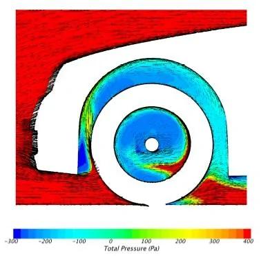

For anyone hitting thermal limits on the track, I did some experiments at a second outing at Laguna Seca with my CT4.
I was interested to see whether improved air flow through the radiators could help extract more heat and keep battery temperatures down, allowing us more laps before reaching the 132F thermal limit and the car cutting power. The summary is that I was able to test 1 out of the 3 modifications I had planned and the gurney flap added to the leading edge of the wheel well resulted in a 20% decrease in battery temp ramp rate. That equates to about 2 extra hot laps around Laguna Seca.
The premise is that by reducing the front wheel well air pressure, we get more airflow and heat transfer through the radiators which vent into the wheel wells. The wheel wells see higher pressures since the wheel and tire creates turbulence, so the rad exit location is not ideal but gives some opportunities to improve cooling. Planned tests consisted of the following:

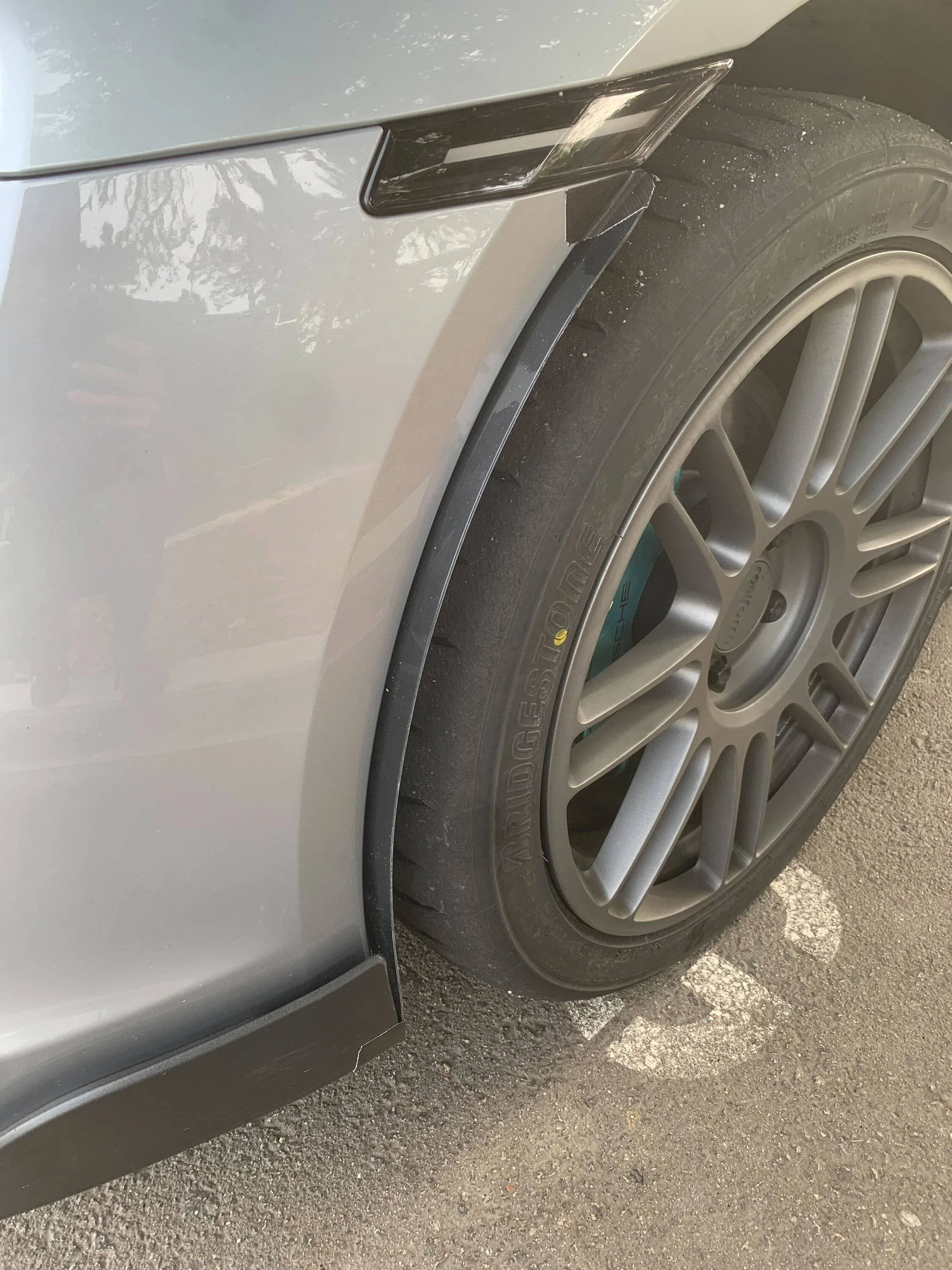

1. Extended wheel deflectors. These reduce the pressure in front of the front tires by directing air around the tire. You instead see higher pressure in front of the deflector and the pressure behind, in the wheel well is reduced. Note the pressure plots below with and without deflectors. The wheel house pressure further reduces the longer the deflector is, at a small detriment to overall drag. See attached for image reference, a good read!
Porsche Taycan Cooling Modifications Experiment for the Track: more air flow through radiators to keep battery temperature down Wheel deflector 0mm
Porsche Taycan Cooling Modifications Experiment for the Track: more air flow through radiators to keep battery temperature down Wheel deflector 65mm

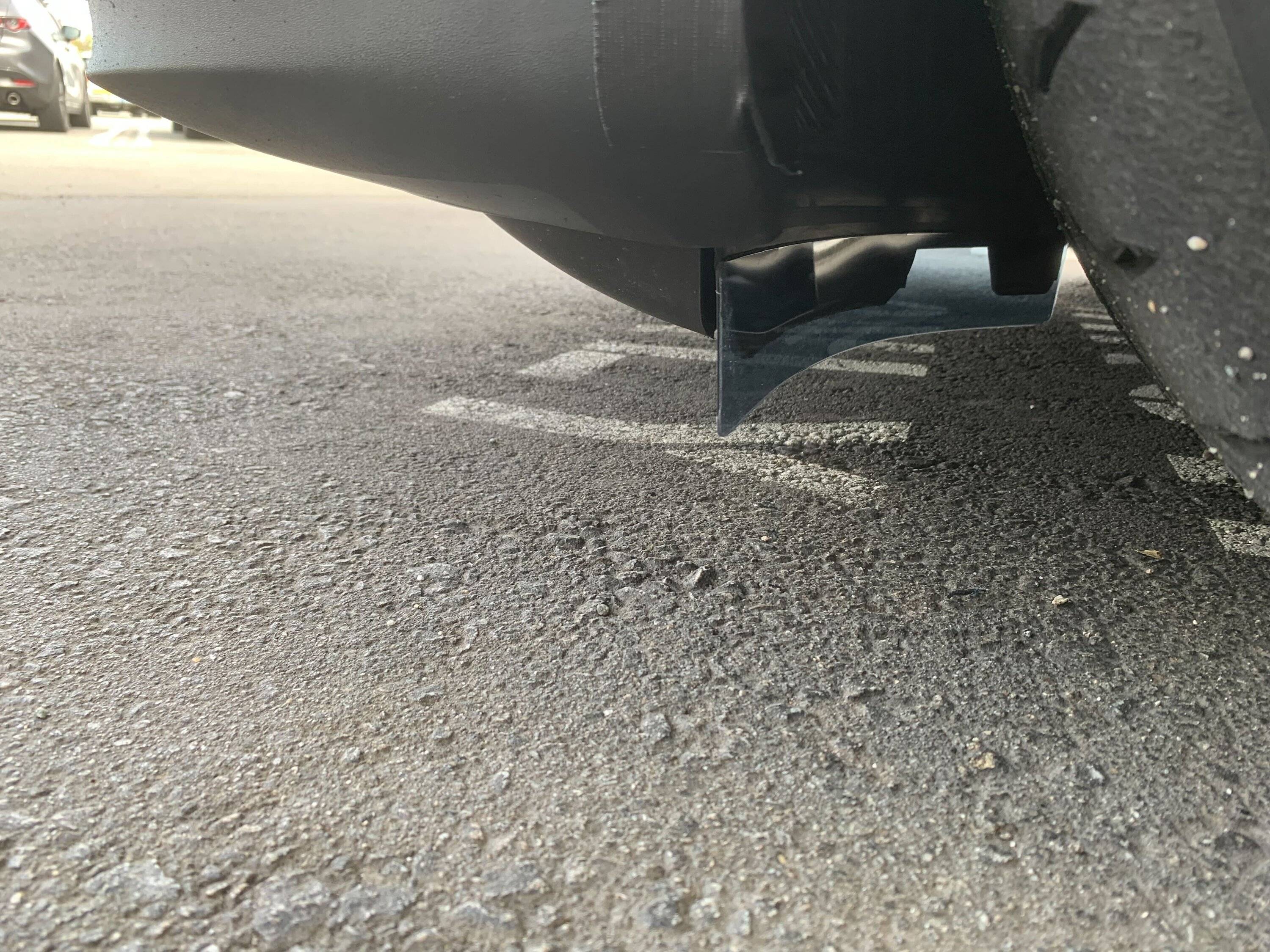

I had made 1" extensions from the existing wheel deflectors but they didn't last 1 lap since I was already bottoming out on the stock deflectors. I would revisit this again with flexible rubber deflectors.
Porsche Taycan Cooling Modifications Experiment for the Track: more air flow through radiators to keep battery temperature down IMG_9018
2. Gurney flap to direct air outwards from the wheel well. This feature has been well documented in SAE papers to help extract hot air from the wheel well for brake cooling effect and reduce lift. Penalty again is an increase in drag as the side wake is increased. I made a test prototype out of 1/16" thick PC that extended out 3/4".
Porsche Taycan Cooling Modifications Experiment for the Track: more air flow through radiators to keep battery temperature down IMG_9015
3. Taping up the air curtain ports on the sides of the front bumper and also partially closing off the brake ducts were the other planned modifications that would reduce airflow from the front of the car entering the wheel well. I was testing a new set of track pads but on my initial session, I was worried that overheating the brake fluid would be a potential risk so decided against the brake duct blockers. The air curtains, I just forgot to tape up, doh! But you can see the Taycan GT spy pics had the same idea.

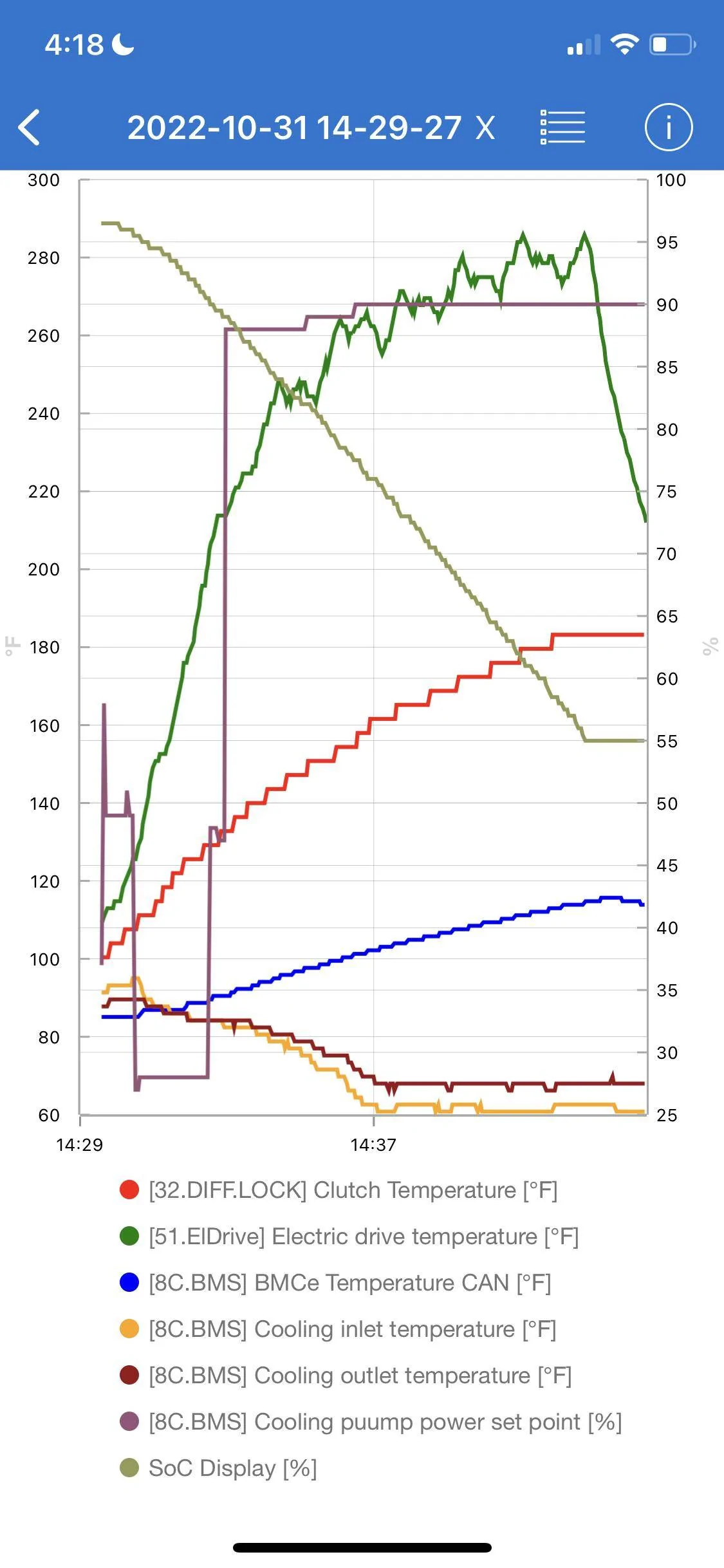

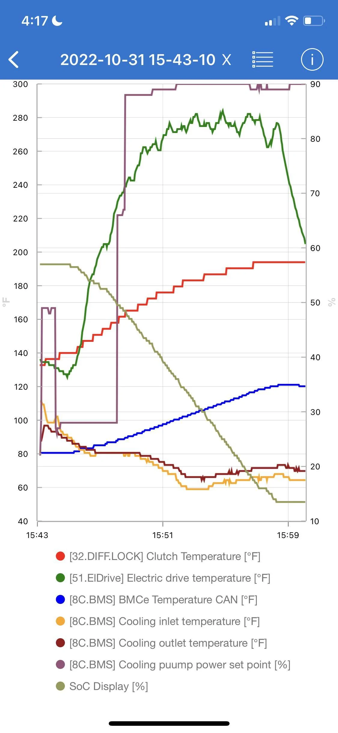

So here's the results that the gurney flap made to cooling. Measurements were logged using the CarScanner app. Both with and without the flap were run in the same weather conditions, partly cloudy 59F in 15 minute sessions. Raw temperature data presented below. With flap on left, without on right.
Porsche Taycan Cooling Modifications Experiment for the Track: more air flow through radiators to keep battery temperature down IMG_9043
Porsche Taycan Cooling Modifications Experiment for the Track: more air flow through radiators to keep battery temperature down IMG_9042

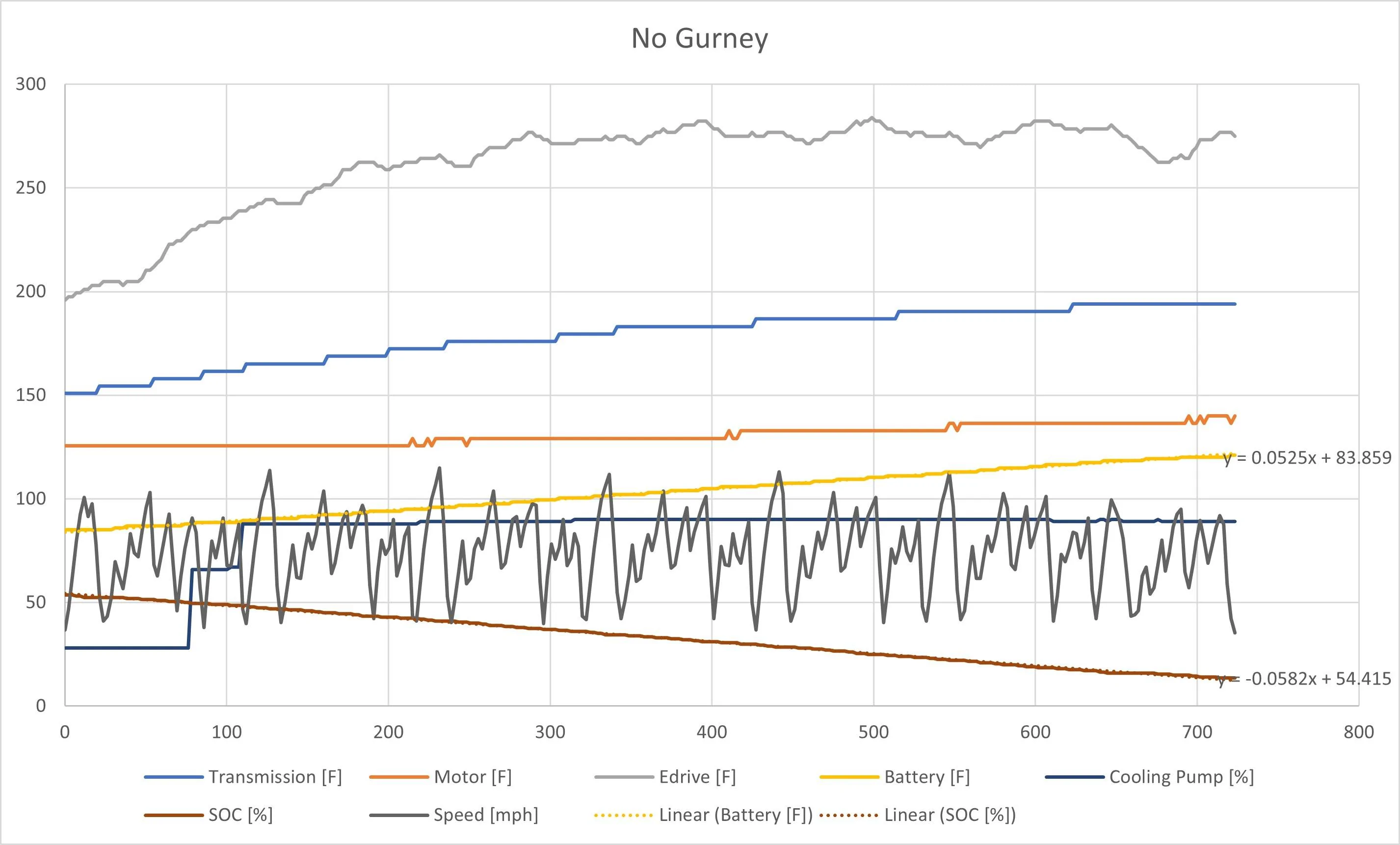

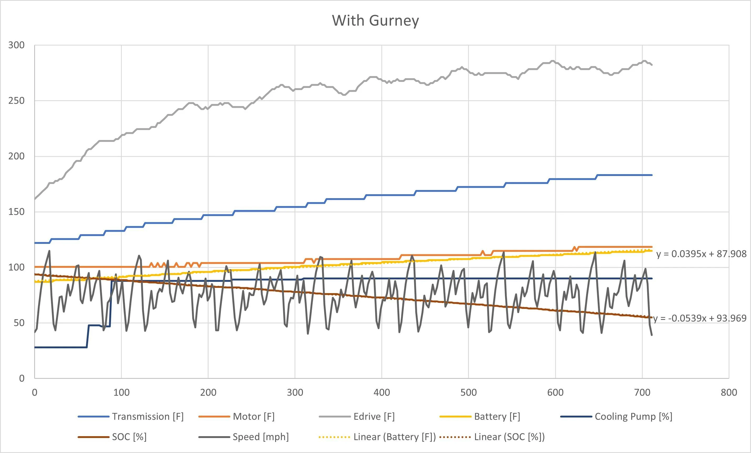

In and out laps are more variable so I truncated the data to include only the hot laps, 7 laps each session:
Porsche Taycan Cooling Modifications Experiment for the Track: more air flow through radiators to keep battery temperature down with gurney
Porsche Taycan Cooling Modifications Experiment for the Track: more air flow through radiators to keep battery temperature down without gurney
x-axis in seconds.
The yellow line represents battery temp and its immediately obvious that the slope, or rate of increase is higher without the flap. In fact, without the flap, the starting battery temp is lower but ends with a higher temp than with the flap.
Battery temp w/ flap: 87->115F​
Battery temp w/o flap: 85->121F​
To make sure we have an equal comparison, I confirmed that the cooling pump was running equally for both sessions, both got up to 90% by the start of the second hot lap. I also wanted to normalize the battery temp ramp according to the energy used. The session without the flap used more energy at 2% higher rate. I added that 2% to the battery temp ramp rate of the no-flap trial. The normalized difference: 20%.
Battery temp increase w/flap: 2.40 degF/minute​
Battery temp increase w/o flap: 2.99 degF/minute​
What does that ramp rate mean? I can extrapolate that to see how much longer (in minutes or laps) it would take for me to hit 132F battery temp, at which the car cuts power. With the gurney flap, I'd be good for another 4 laps, but without, I'd be done at another 1.8 laps. That's a difference of about 3.6 minutes. With the gurney flap I'd be looking at 11 full hot laps in these conditions, a bit more than 23 minutes lapping at full speed with a proper warm up and cool down lap. Perhaps even longer in reality as there's another 10% capacity in the cooling pump that hadn't kicked in yet.

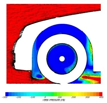

This makes sense and some quick research supports this where an increase in cell heat gen increases with DoD during discharge. Based on the linearity of the battery temperature rise for both tests, I suspect that effect is not great, otherwise we would see a slightly progressive curve given that other cooling variables are essentially equal. For the data I collected, I just further truncated it so comparing a closer range of 75-55% SoC (w/gurney) to 53-34% SoC (w/o gurney) and the difference actually further supports the effectiveness of the gurney. I would say this phenomenon is likely in the noise. But future testing, I'll be sure to reverse the order. Here's a reference to put this concern in context:
Porsche Taycan Cooling Modifications Experiment for the Track: more air flow through radiators to keep battery temperature down 1667408687914
This is for a LiFePo pouch battery (fig.5) with passive cooling so I'm sure there are some chemistry differences. But for the sake of this argument, We're discharging the Taycan battery at a rate of about 1.6C. The heat generation in the graph for 1C and 2C discharge rates are still relatively flat and constant. So I think this further supports it's not a huge factor. Perhaps the slightly higher discharge rates of a Turbo would see a greater demand on cooling at lower SoC, though.
