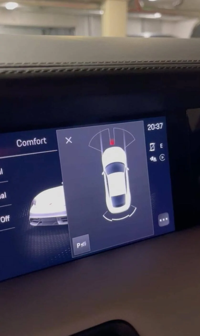

2) Front parking sensors (the car does not have a 360-degree camera system, probably the only option that I miss) seem to detect phantom obstacles periodically. The dealer claims they can catch the number plate holder, but this is unlikely as was adjusted already (see picture). Happened a few times, and resolves itself after the car is restarted/locked-unlocked. The front of the car is PPF wrapped, but the issues there have been ruled our, all is tidy and unobstructive for the parking sensors.

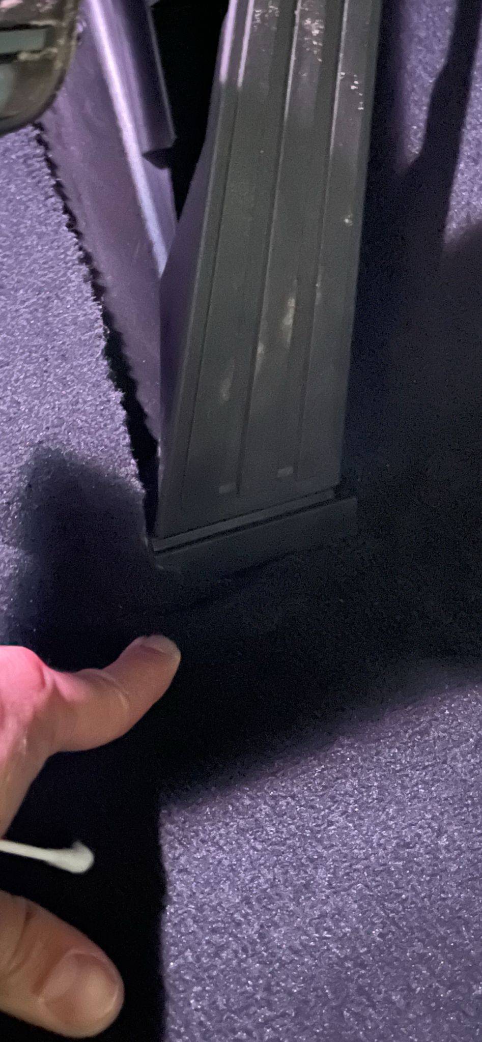

3) Build quality - at times, subpar. Some noises in the interior (the area where the sport chrono clock is, it seems), and some panel gaps outside might have been more even. The absolute highlight that I found from the factory - the carpet in the driver footwell was only partially tucked under the accelerator pedal body (e.g. was bubbling). Easy fix, but why oh why it has even left the factory like this? (see picture)

2) Front Parking sensors sound to me are out of calibration if they continue to do so especially if you had PPF applied, and installers can pop those out and then put them back in to tuck the film. The front sensors known for where I am to detect and beep at Ford vehicles, most often trucks with chrome rear bumpers, and not unique to the Taycan, i.e. Macan/Cayenne.
3) I checked the carpet near the accelerator and mine is tucked in but when I press on it, I can see how it can get loose as there seems to be hollow space to the left of the accelerator. I can see if someone would press there instead of the pedal, then the carpet would let loose. I would tuck it back in and be done with that.

2) The sensors were not taken apart or disconnected in any way, will observe if the bug returns. So far seems to be gone for some time.
3) Yep, 1 torx screw and it's fixed, still do not like seeing it on a new car.
