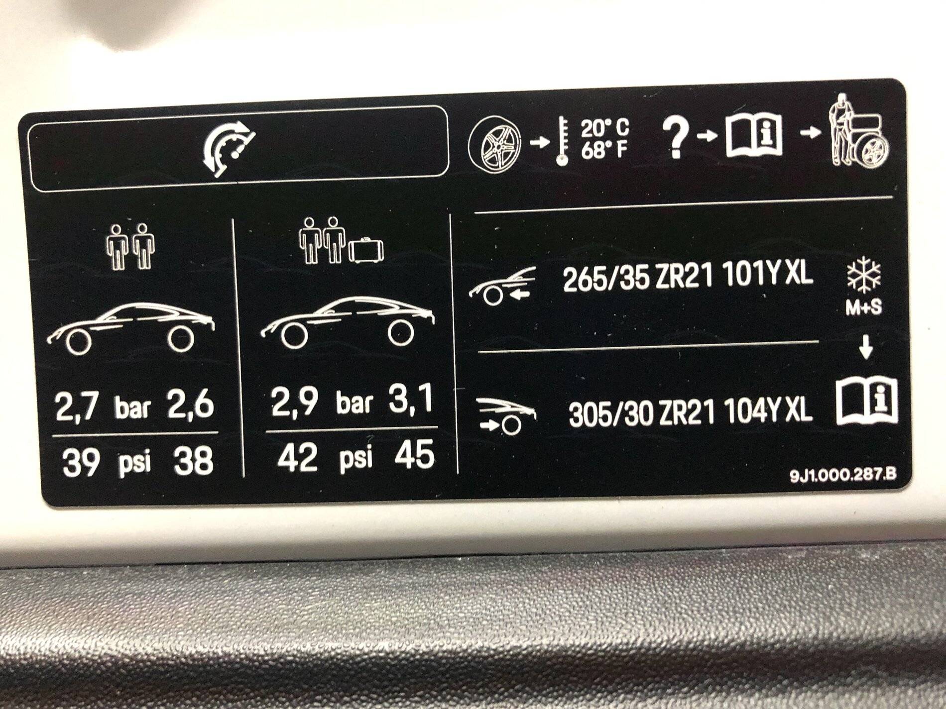

Here is a picture of the recommendation in my car. I have the Good Year Eagle F1 tyres in 21 inch.

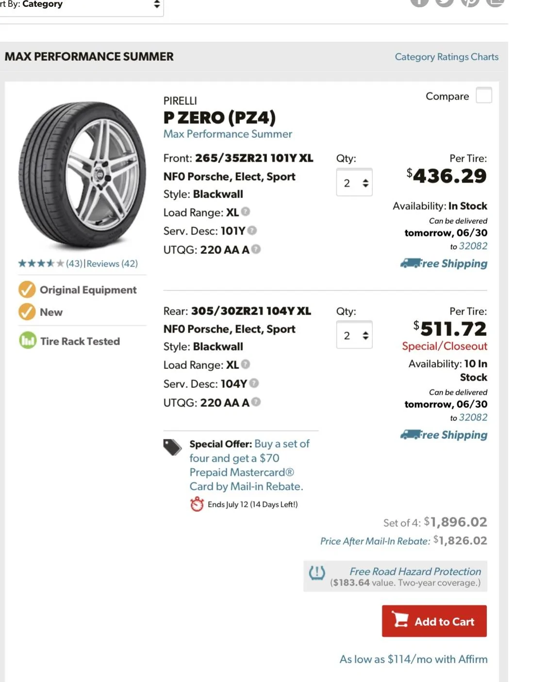

Sounds like we have the same tires. I’ve attached a pic. Where did you get those specs? Are you located outside the US?
thank you
Porsche Taycan 21” Summer Tires - tire pressure? 76E4C940-307F-48C9-A47C-09A9ECAD42B8

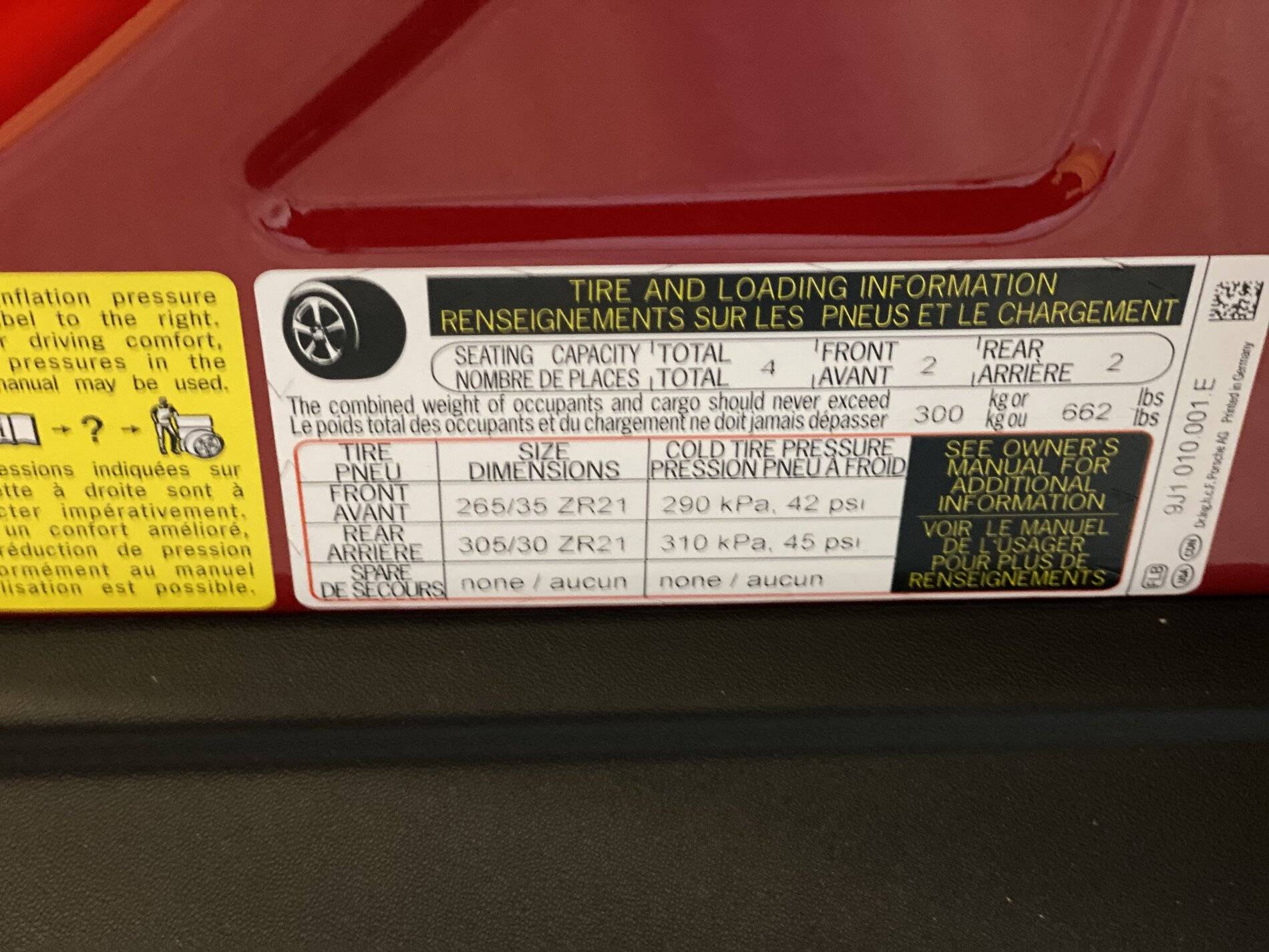

About halfway between normal and full load on the Turbo S with 21” Summer tires (standard US configuration) is 40 psi on all four wheels - an easy to remember cold number (68 degrees, 20C). This is from the manual, which apparently lists tire pressure for greater driving comfort.
The door label lists the maximum load pressure when cold:
Porsche Taycan 21” Summer Tires - tire pressure? 1603301584344
