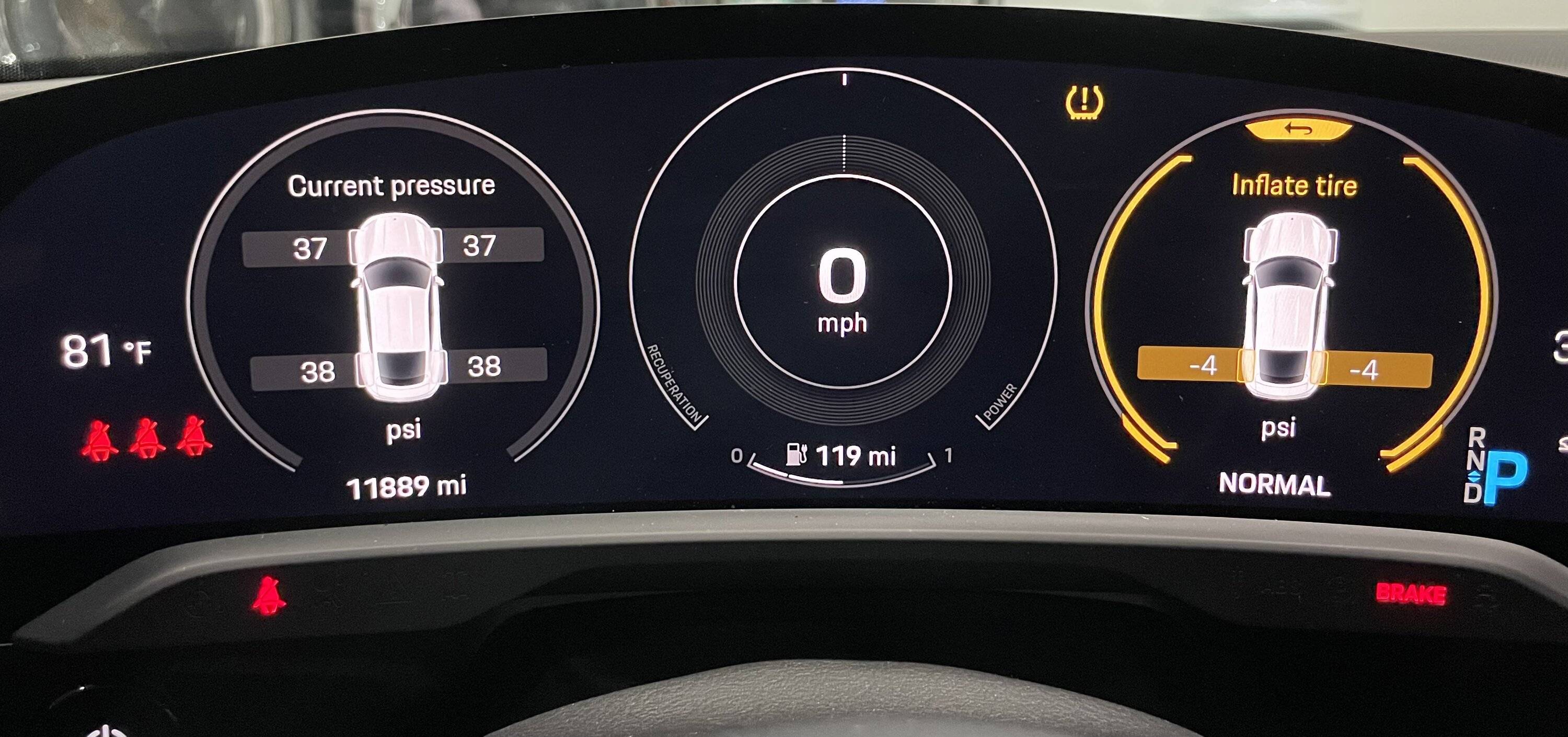

When I got into my '22 GTS last night the car said that I needed to inflate my passenger rear tire 5 PSI. The weird thing is the left dial which I have the tire pressures displayed still show 35 PSI on all 4. I decided to drive a little and it didn't go away. I left it overnight to see if I had a slow leak. This morning the car said both rear tires needed 5 more PSI, but the left dial still shows perfectly normal PSI in all 4 tires.
Has anyone dealt with this? Do I need to reset something? The rims and tires have never been removed. Check out the photo and thanks for any insight from our Taycan community.

I had this happen repeatedly and was manually checking tire pressures. Everything seemed fine but the system kept giving me that error. You can reset the tire pressures in the settings as if you have “new” tires. That would get rid of the error for a bit but it always came back. I went into the dealer and they “inflated” my tires, took it for a spin, and said everything was fine. I swear they changed a setting. Never had the error after they looked at it. Try the settings and re-selecting what tires you have on the car. It will recalibrate each time you do that.
