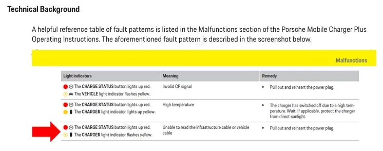

Condition:
The Porsche Mobile Charger Plus (PMC+) can fail to read a new temperature-sensing NEMA supply cable after updating to SW level 3000.
Porsche Taycan TSB: Porsche Mobile Charger Plus Supply Cable Failure (in "fixed" PMC+) - October 30, 2024 1730900268631-3u
Service Information:
While the Operating Instructions recommend removing and reinserting the power plug, this does not always remedy the condition. There is currently no known correlation of this condition to supply cable production date. If a PMC+ exhibits the described behavior with a certain supply cable, normal operation cannot be guaranteed with a power supply cable of later production date. Each cable must be physically tested with the customer’s PMC+ at the Porsche Center to confirm functionality before returning the PMC+ and new supply cable to the customer. This condition is not a fault of the temperature-sensing supply cable.
New cables that do not work on the affected PMC+ devices demonstrating this condition will work normally on other part number variants with updated software. If the PMC+ continues to display this behavior with all available supply cables after multiple outlet plug-in cycles, it should be replaced.
TSB: Porsche Mobile Charger Plus Supply Cable Initialization Failure
Edit on July 9, 2025, to link to TSB update, which adds Porsche Mobile Charger Connect: https://static.nhtsa.gov/odi/tsbs/2025/MC-11020425-0001.pdf
Edit on September 6, 2025, to link to TSB update: https://static.nhtsa.gov/odi/tsbs/2025/MC-11022812-0001.pdf
Edit on November 6, 2025, to link to TSB update dated Oct. 2, 2025: https://static.nhtsa.gov/odi/tsbs/2025/MC-11025056-0001.pdf

Got a '24 Taycan GTS last week. Production date 9/23.
It didn't come with a 14-50 cable.
Sales guy shipped me one... 7PP-971-678-GA
Date says: 04.05.2023
Plugged everything in and things looked okay. i.e. Porsche Mobile Charger Plus EVSE says 100% in green.
I come back the next day and noticed the EVSE has gone to sleep/off.
I press the charge button and it turns back on, but now Charge Status is solid red and charger icon is blinking yellow.
I turned it off and back on, it's okay again.
Rinse and repeat the next day.
I also noticed I had to twist the cable the other direction to plug it in. I guess I have the old wrong version?
I am just going to use my Nissan's 30amp EVSE at this point.

When I recently took my Taycan to dealer for replacing brake lines and new cable for PMC+, I mentioned to service advisor that I had read this TSB stating that some of the new cables would not work with the PMC+ and it was necessary to actually plug in the PMC+ with new cable to ensure it worked at 220v.
Service advisor said, yes, we know that - we had some failures when we started replacing cables. We always test them.
A day later he called and said brake lines were replaced but the cable we got for your PMC+ did not work so we have ordered another one which will be here tomorrow. I picked up car the next day, tested my PMC+ with new cable at home and it worked properly. Put it back in the box for storage until I dispose of the car.

Selling dealer (out of town) gave me another cable. Still didn't work.
I took it to another dealer in town, he tried a few cables (he claims) and made me an appt to bring it back to leave car and charger there.
I emailed the GM from the first dealership I went to in town and explained the situation and the poor customer service. He had his service director call me and told me to bring the car back.
I went in with the charger, showed him the two cables and the bulletin.
He took the charger back. Came back out 15 mins later. He said the software update wasn't done on the charger even though the VIN doesn't indicate so.
Updated it and I was on my way. I was skeptical.
I got home and got the same error. I flipped it from 50% to 100% and the error was gone. Power cycled it a few times, no error. Charged the car with no issues.
