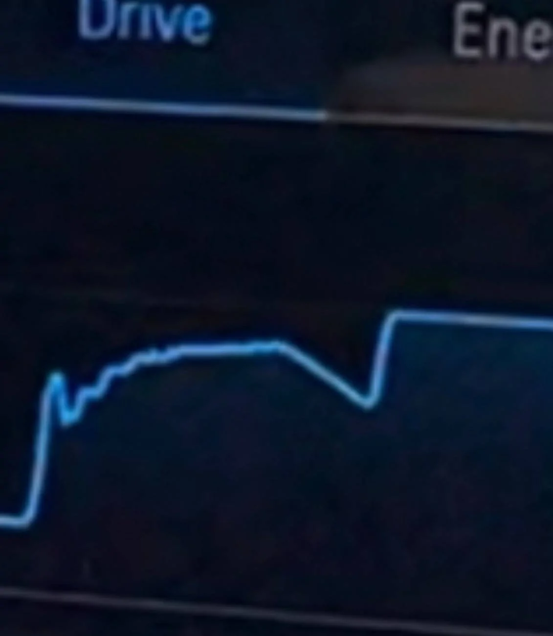

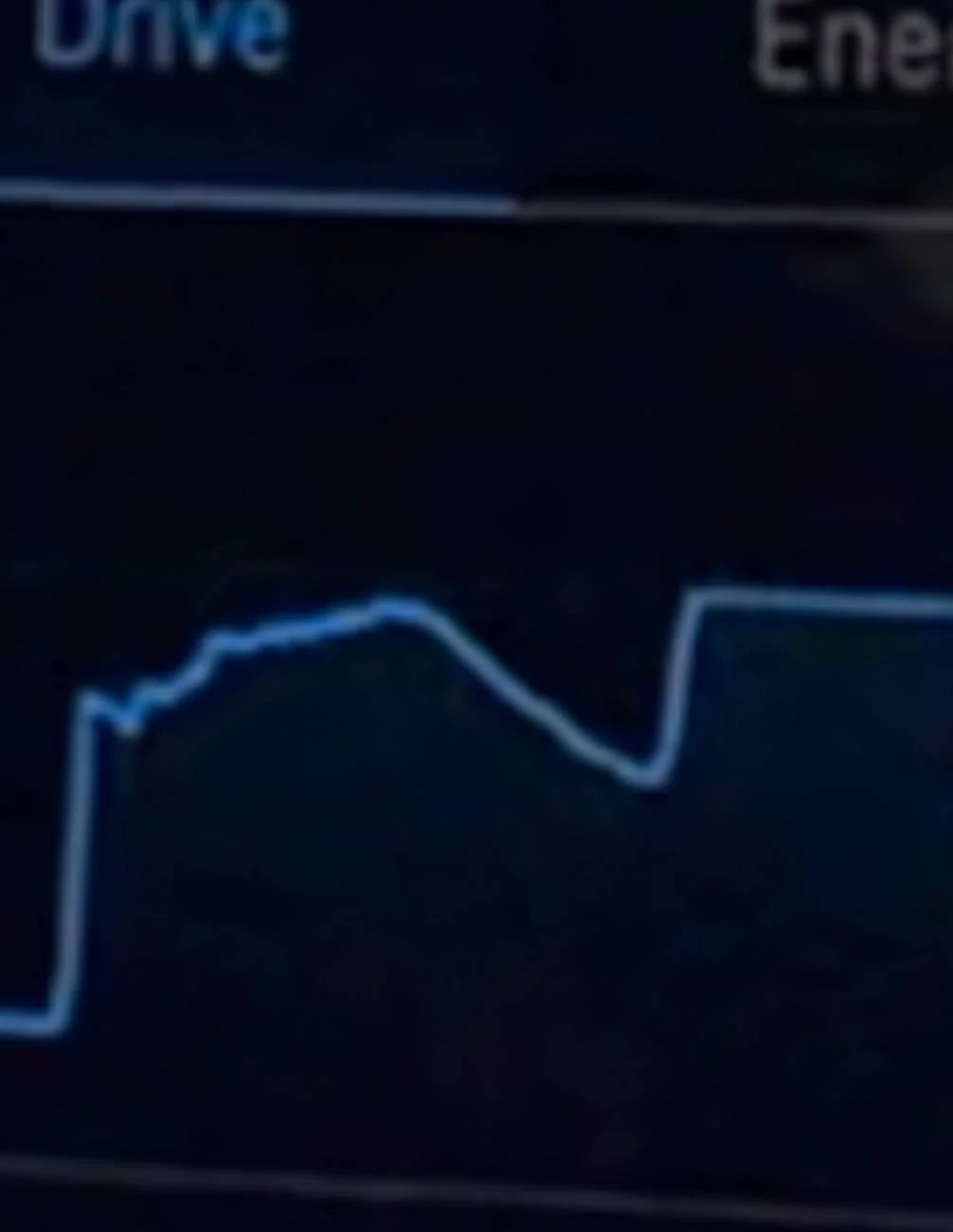

I think It is possible porsche mandated a torque curve in 1st gear (with a head room) that would keep the vehicle clear of TC kicking in straight line in most dry road conditions. I can see them doing it from a “driving experience” standpoint.
But I can tell you it did not feel like TC is actually intervening and limiting the power. I had launches in many different conditions, and some in perfect dry asphalt. It is very noticable when TC kicks-in more slippery conditions (or when you slam with some angle on the steering. I was pretty sure it was not kicking in (at least after the first 15-20mph) In these instances. Also 350NM peak in 1st gear was pretty consistent with no LC in multiple tries on various surfaces (concrete, asphalt), you’d expect to see some variation if TC driven. You get 380NM as soon as you turn on LC on the exact same surface. Again i think you may be right in the sense that engineers thought there is a torque limit on first gear the RWD can handle in a predictable fashion and limited the car accordingly.
Here are two screen shots of the torque curve first w/o LC and the second with LC. You can actually see the torque level in NM live, but it disappears after the fact (i shot a video where i can exactly see what NM level at what speed, fun stuff :)
Not impossible but I doubt it, personally. Electric motors do have a wide and smooth power curve though and it isn't "fixed" like in an IC engine, it depends on acceptable temperature so is time as well as rpm linked.
Vehicle stability control can be very much more precisely controlled and much faster acting with an electric motor than it ever could be with a piston engine and with the exception of the conditions you mentioned probably acts entirely transparently to the driver.
Try switching it off and measure it again. ;)
The difference in torque peak between with and without LC is interesting, the initial wiggles are probably vehicle stability control interventions and the ramp down probably to match thrust force at the gear shift point to reduce shock load in transmission and jerkiness in the cockpit.
The problem with using torque as a measure is that without knowing the gear ratio you don't know the tyre forces.
