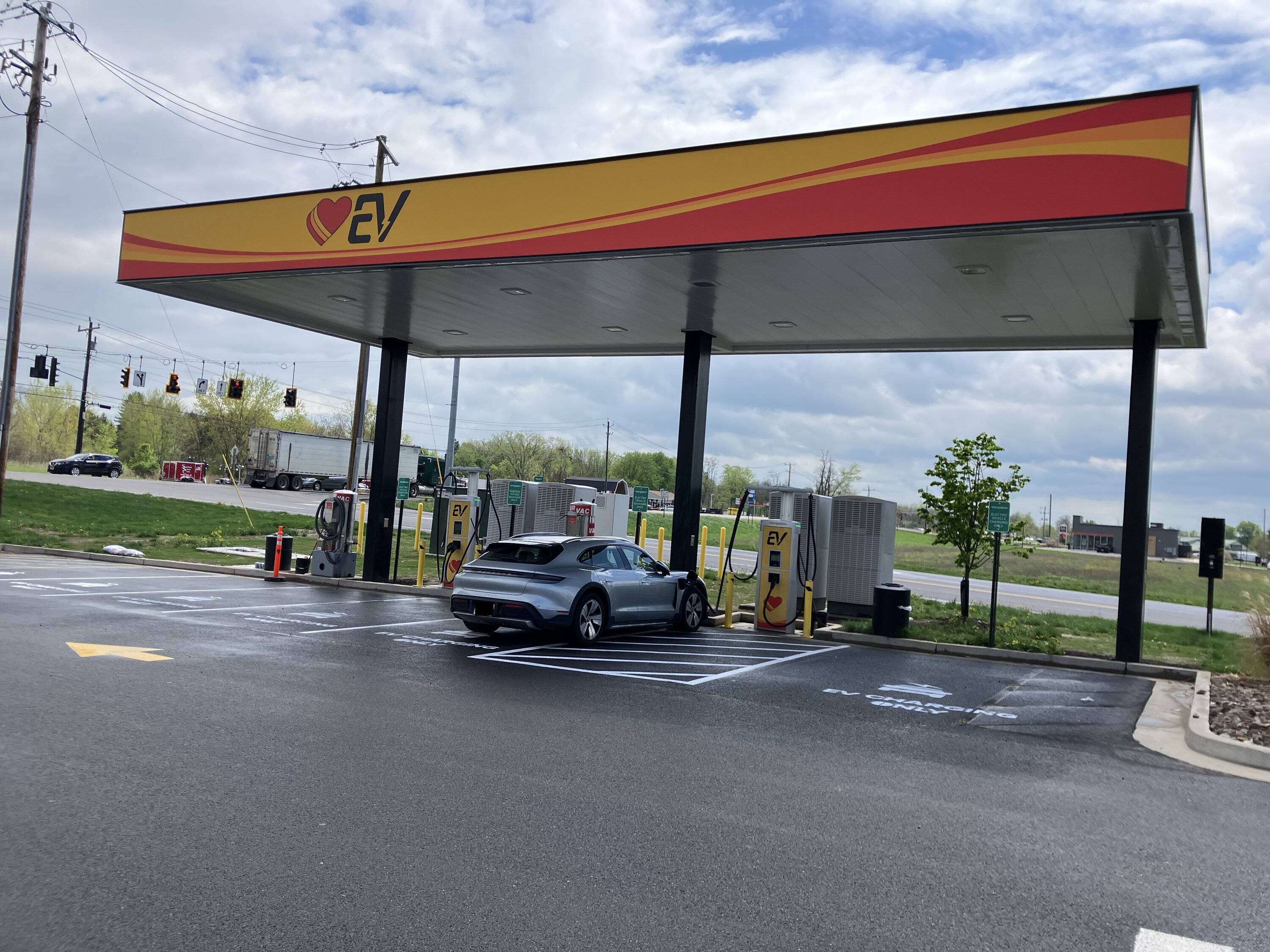

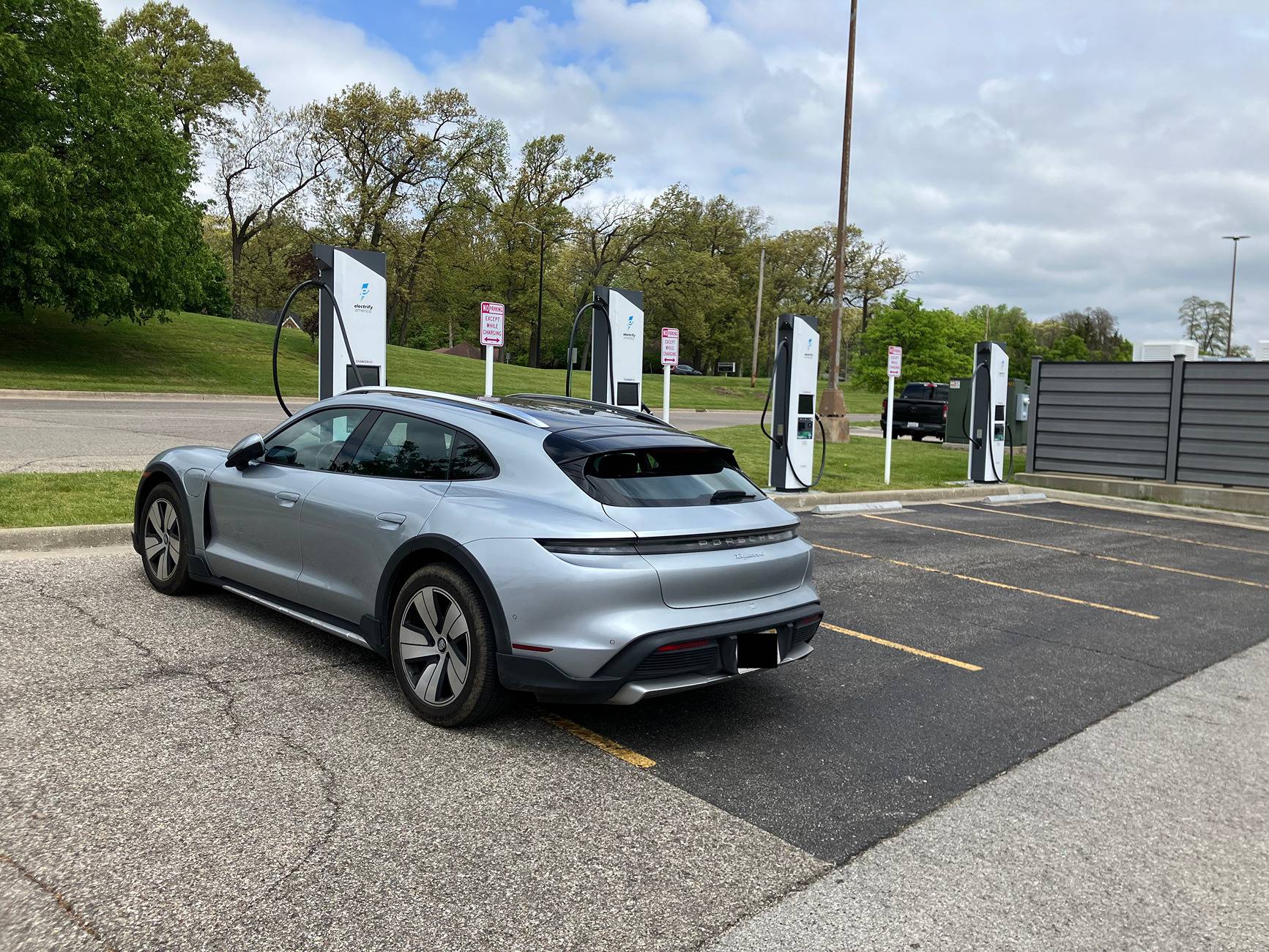

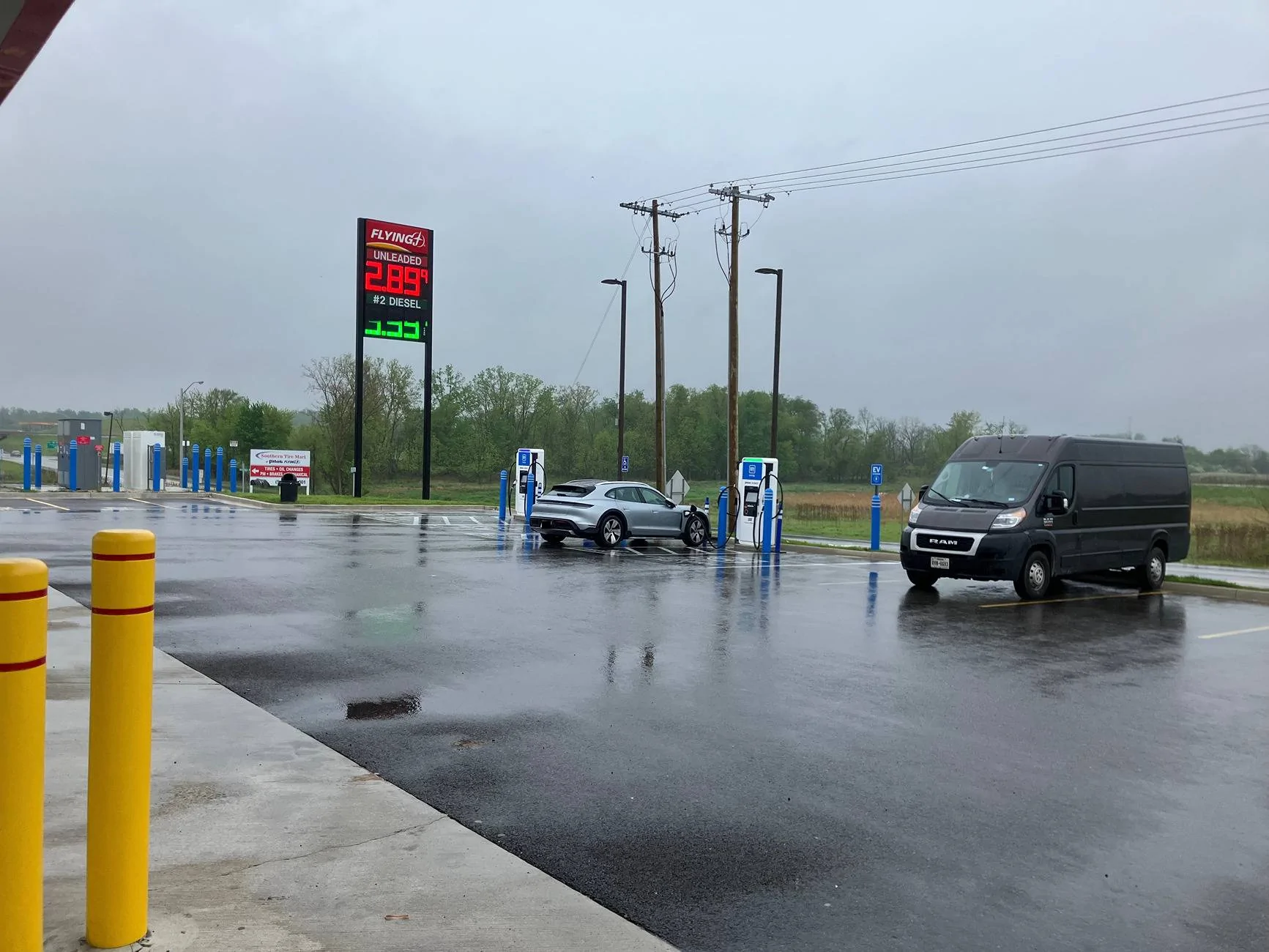

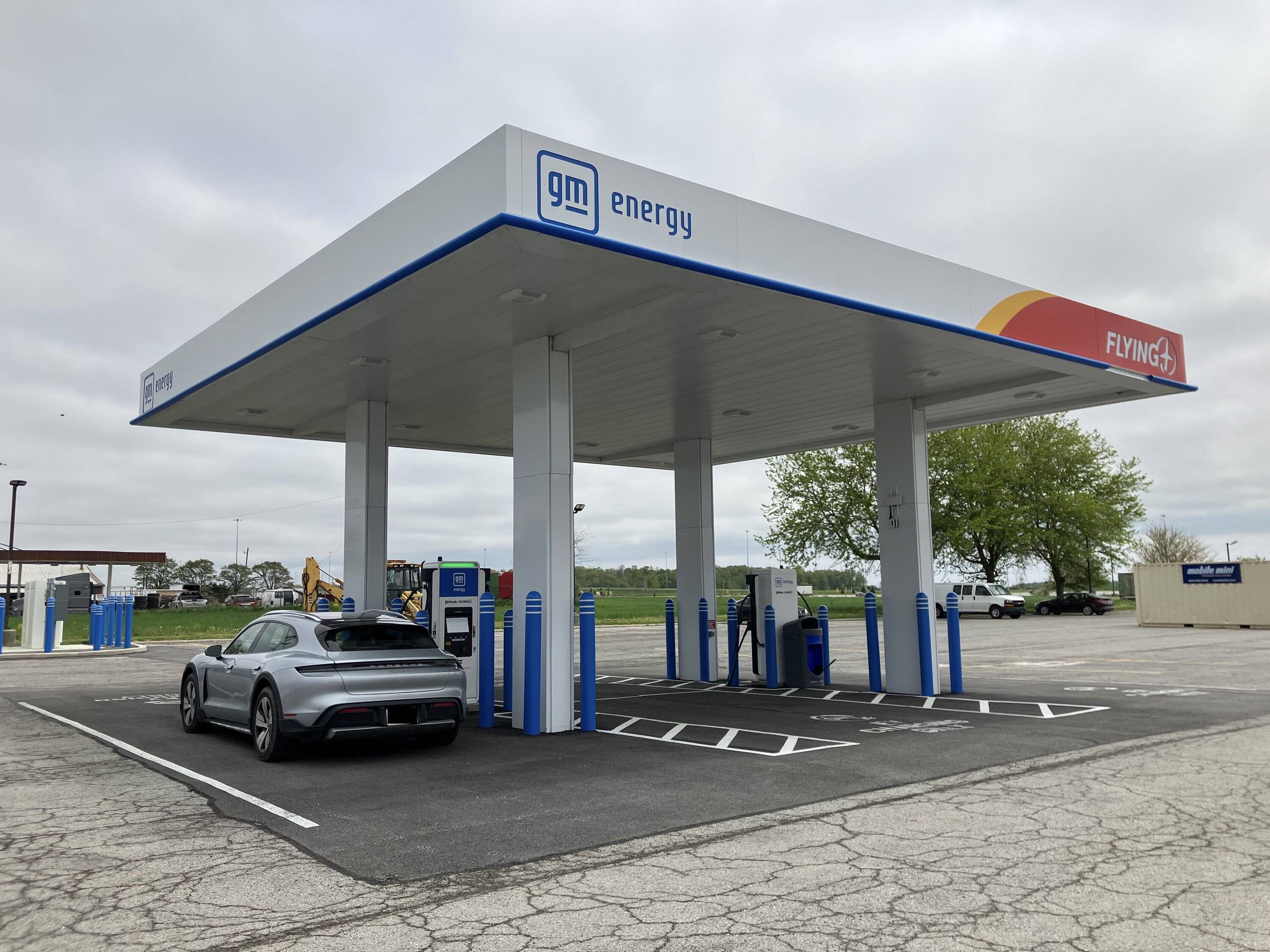

(1) at a Love's Travel Stop in Waterloo, NY (Chargepoint RFID)
(2) at a Flying J gas station in Beaverdam, OH (EVgo RFID)
(3) at a Kwik Charge (Kwik Trip gas station) in West Salem, WI (credit card)
Notice how I'm the only car charging in these photos; this was quite common on this trip.
Out of 28 or 29 DCFC stations that I charged at on this trip, I had only one short wait at one of the stations (EA/Cheektowaga, NY).

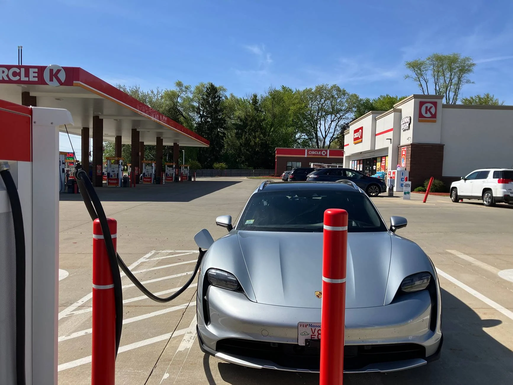

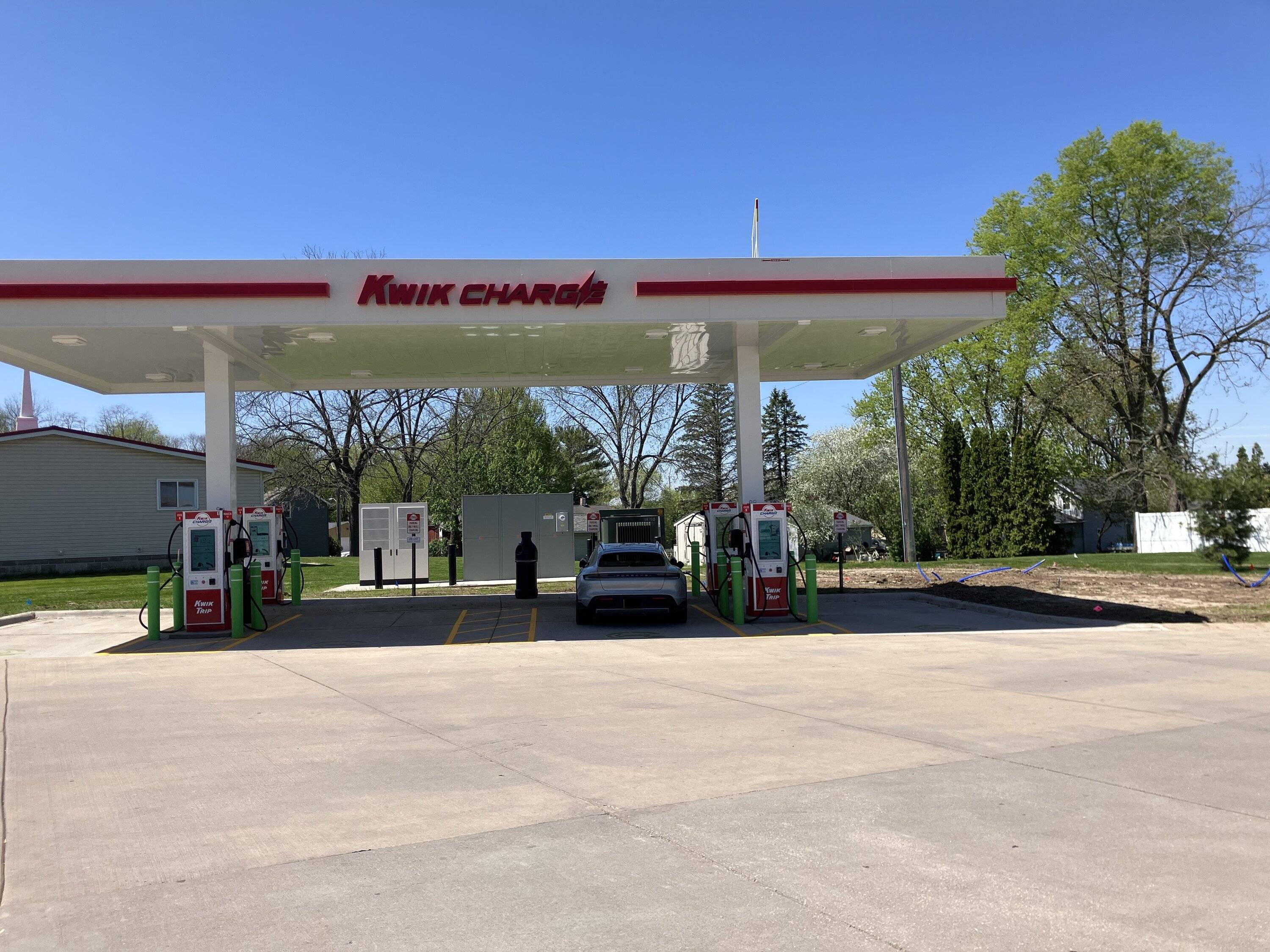

Some more photos:

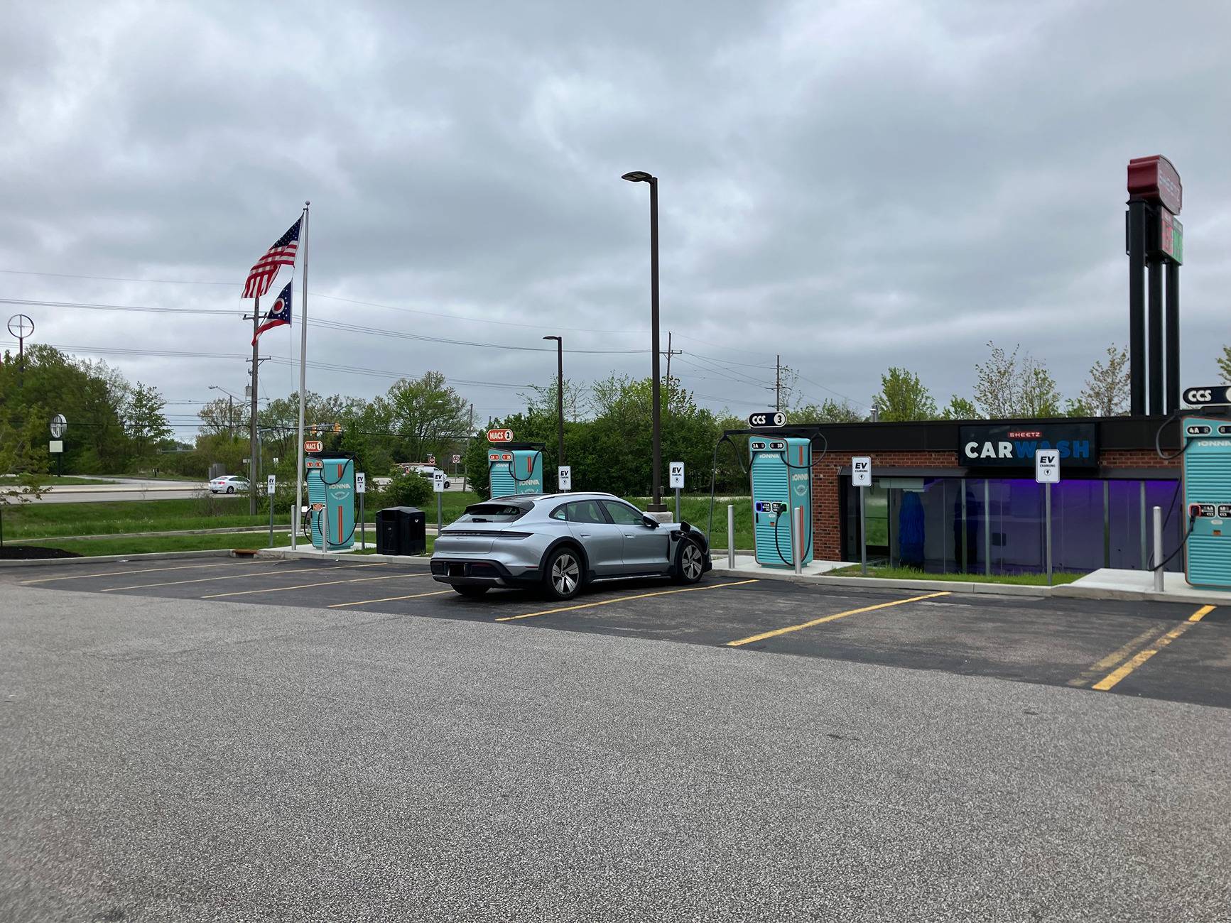

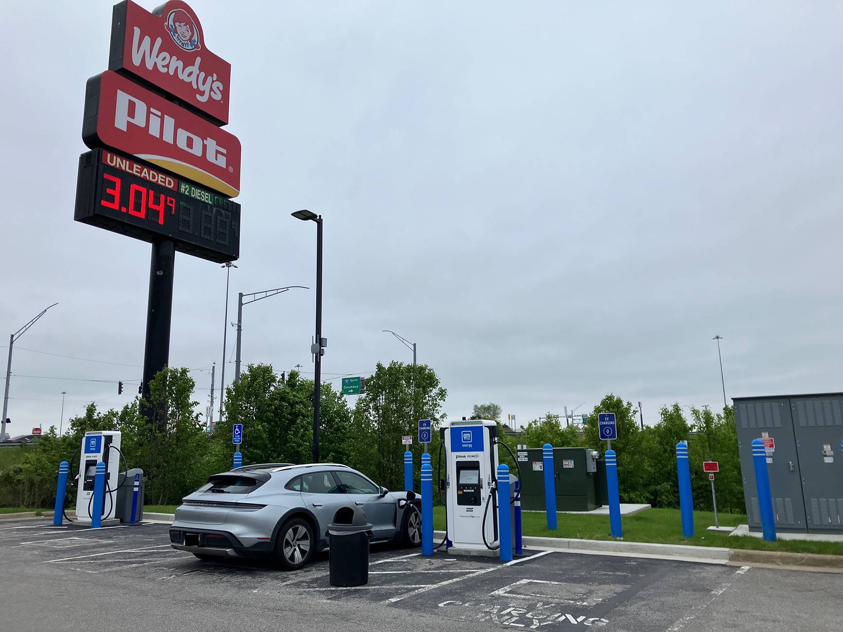

(1) at Pilot (Flying J), Burbank, OH (EVgo RFID)
(2) at Ionna, Willoughby, OH (credit card)
(3) at Circle K, Rockford, IL (Circle K iPhone app; stats in OP updated)
As you can see, I'm the only car charging again at each of these stops.

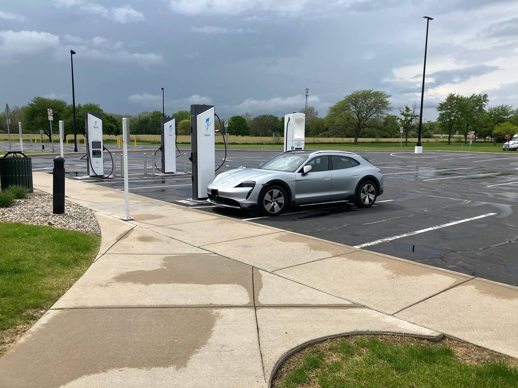

Three more charging photos from this trip:
(1) at Flying J, Edon, OH (EVgo RFID)
(2) at EA, Wyandot Service Plaza along Ohio Turnpike, Genoa, OH (plug-and-charge)
(3) at EA, Mishawaka, IN (plug-and-charge via Porsche)
Again, I'm the only car charging in all of these cases!
The photos are not presented here in chronological order.
