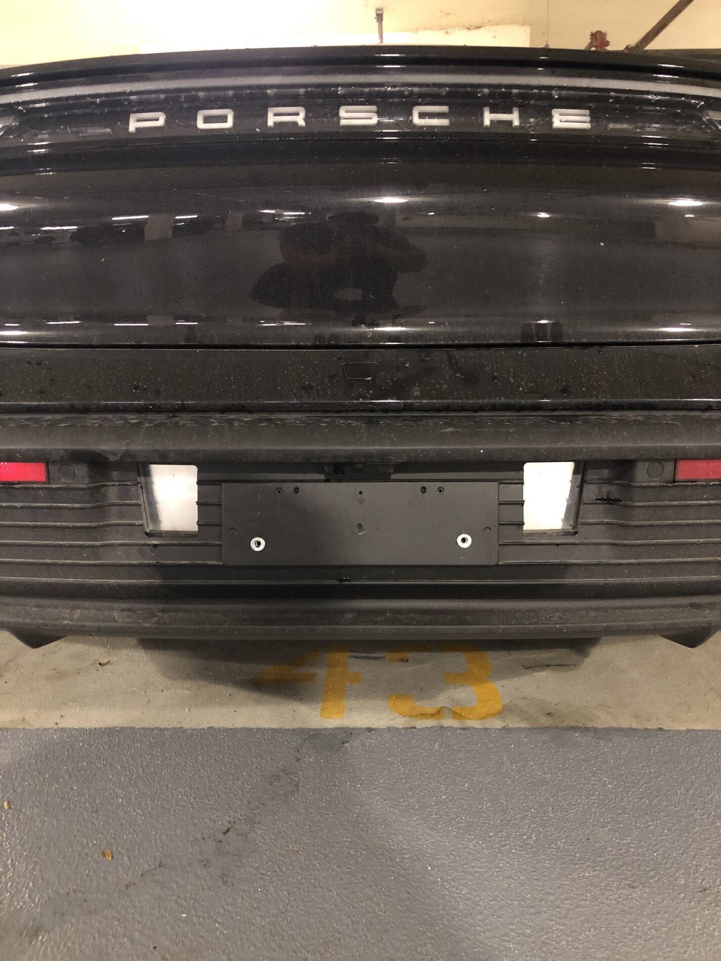

I haven’t done anything. I justtook off the license plate holder. That’s what it looks like without the hideous plate holder.
I was wondering if maybe someone would like to start a small back plate project. ? Maybe looking more like a European version of the Taycan from the back.
I have yet to look in detail at the attachments but whilst the two 'plugs' can be pulled out relatively easily can you recall if the top of the 'monkey butt' plate holder is attached with a screw or rivet or just a plastic tab?
I'm still dead keen on getting this ugly thing off my car and looking for a plate to replace it - @evanevery 's plug filling solution looks excellent but not familiar with any place I'd trust here to do a proper job with the 3D printing.
I may just ask the custom shop I will be going to this Tue who are going to paint my fender arches if they can build something or again might just do myself if their solution is mad expensive. Was hoping someone had taken up the request to measure this up and print but I guess not :)

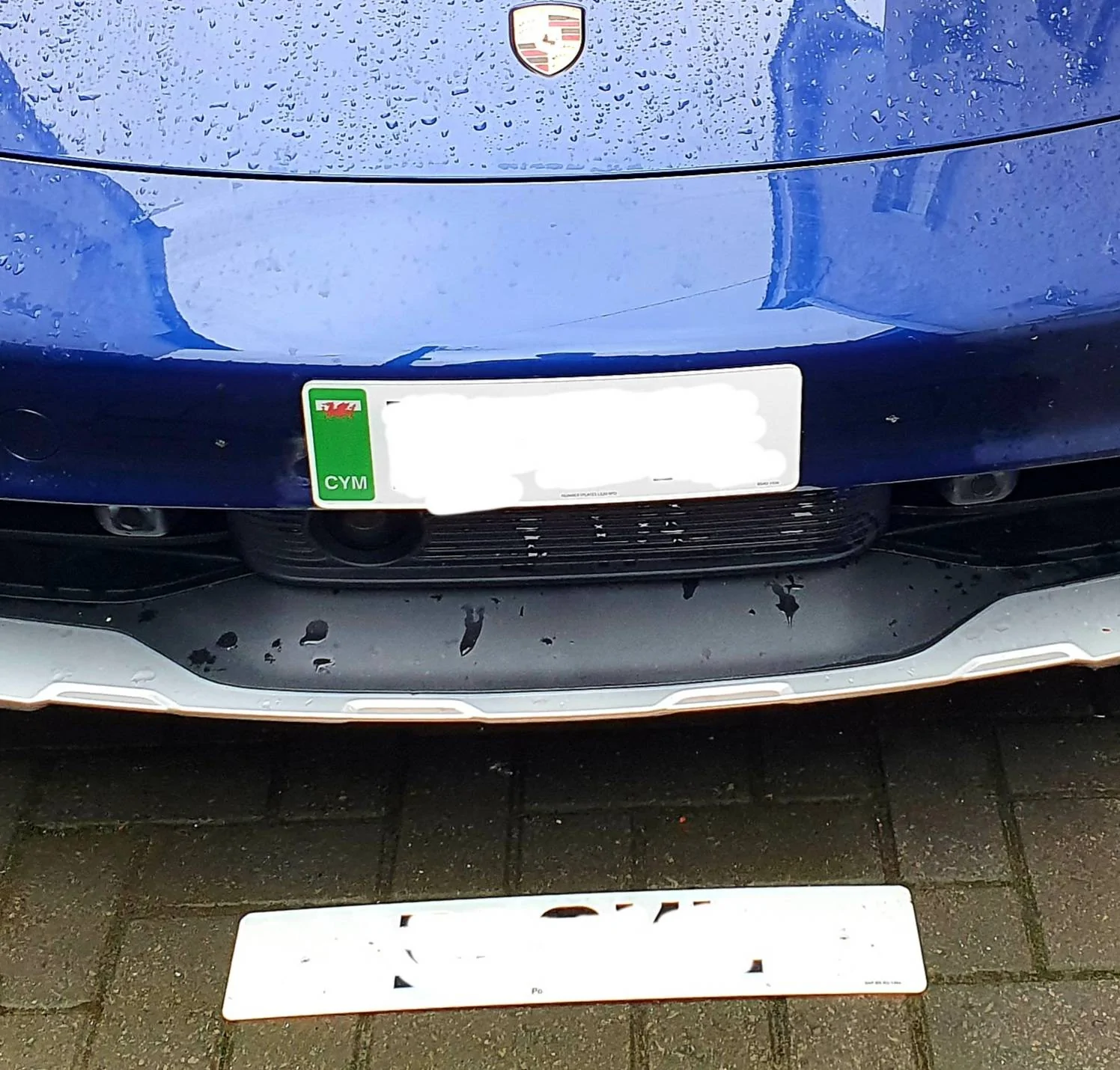

Thought I'd update my temp solution to the Money Butt Plate holder :) - Plan on doing a better custom fit but also a more elegant solution with matching ribbing if I can - again this is just a prelim template (color obviously not matched but even this grey not as light as it appears here) and actually not the one I will use in the final version:
Porsche Taycan 3D Printed Removable Front Plate Mount for Taycan (Print Files Attached) IMG_4934
Ultimately will look more like this:
Porsche Taycan 3D Printed Removable Front Plate Mount for Taycan (Print Files Attached) Screen Shot 2022-01-31 at 11.45.52 AM

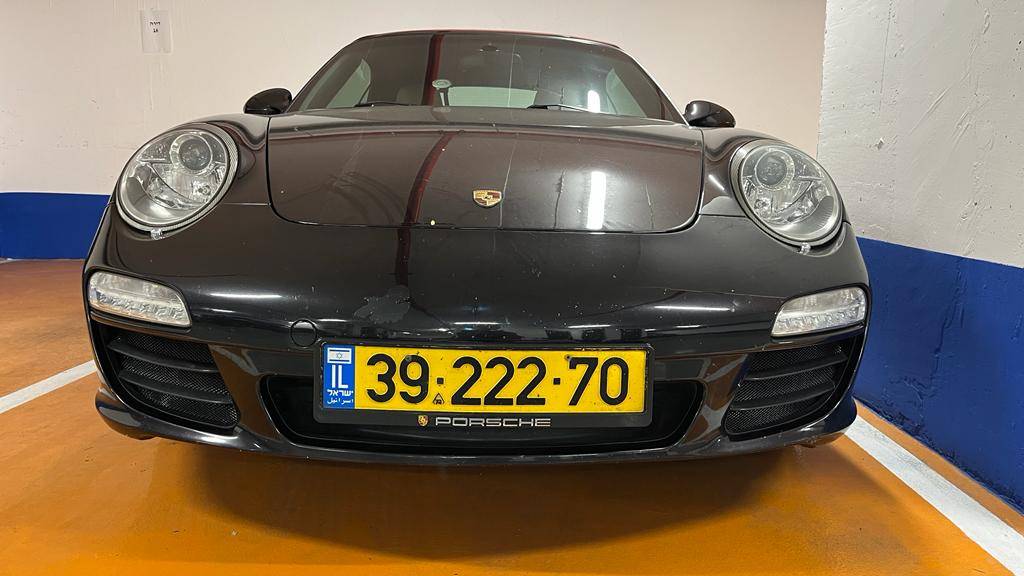

Hi Ed,
What an amazing project! :muscle:
I am looking for a license plate mount solution for my Porsche 997.2.
In my country the front license plate is a must, so I am looking more for a permanent solution.
Last weekend I added DIY grills into the left and right air intakes. I might also put a grill into the middle section that is connected to the outer sections.
There are already a couple of holes in my bumper from the previously mounted license plates and the bumper also needs a respray due to some paint peeling.
Before having the paint job done, I wanted to go for a more elegant solution with the license plate, which is why I plan to take your idea and approach to apply on the 997 model.
The plate will be allocated much higher than in the picture. Besides that I pretty much want to do what you have done.
This raises a couple of questions:
How did you get the correct shape of the bumper transferred into a CAD model?
I read that you used “… contour gauge, digitizer, and digital angle gauge/protractor”, but I wonder how that was done step by step. I would really appreciate if you could elaborate more on this process.
How the mounts are bolted to the bumper? Did you drill 2 holes there? And also here, how you took the exact measurements and transferred it to the CAD model?
Thanks alot for any assistance!
All the best,
Harald
