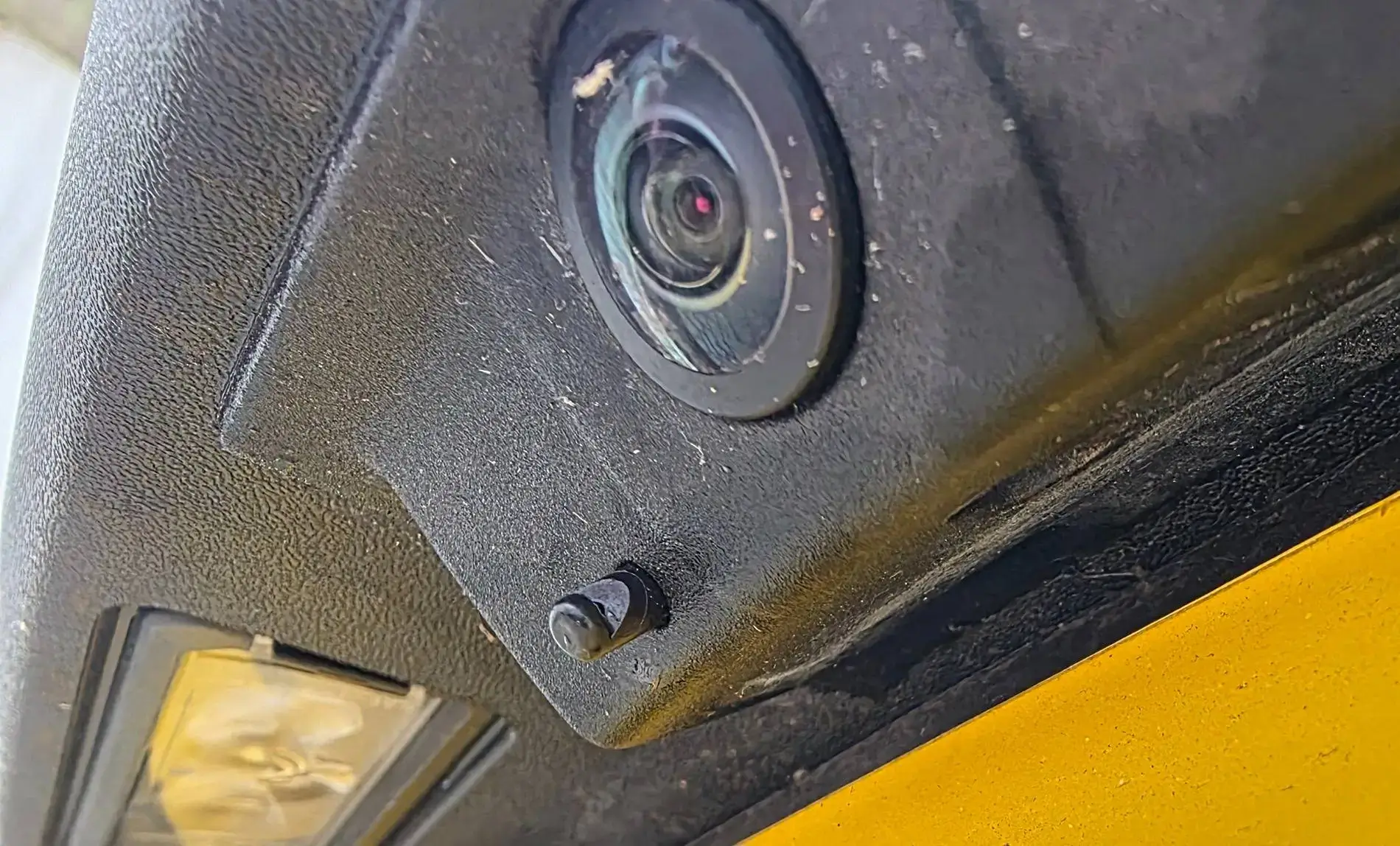

This might be a silly question but is there a rear camera washer on the saloon? It seems that there is physically one on mine next to the camera and also an option on the central panel but when I press the wash icon on the central panel nothing seems to happen. Wasn’t sure if this only works on the CT as it’s got a rear wiper whereas the saloon hasn’t. Looked in the digital handbook but can’t see anything.

Sometimes the washer is clogged, if so try to clean it gently with a needle. If it’s never worked, you may need to hit the wash icon many, many times to get enough fluid to operate the washer. Like maybe 50 times total (the car may prevent you from doing it too many times in a row, just keep turning the car on and off or wait until the next time you power it on to try several more times). This was my issue; I could hear the little motor kick in but no washer fluid for a long time.
See: https://www.taycanforum.com/forum/threads/rear-camera-washer-not-working.23549/page-2

Thank you for your advice. It now works like new!!! Appreciated. 😊
