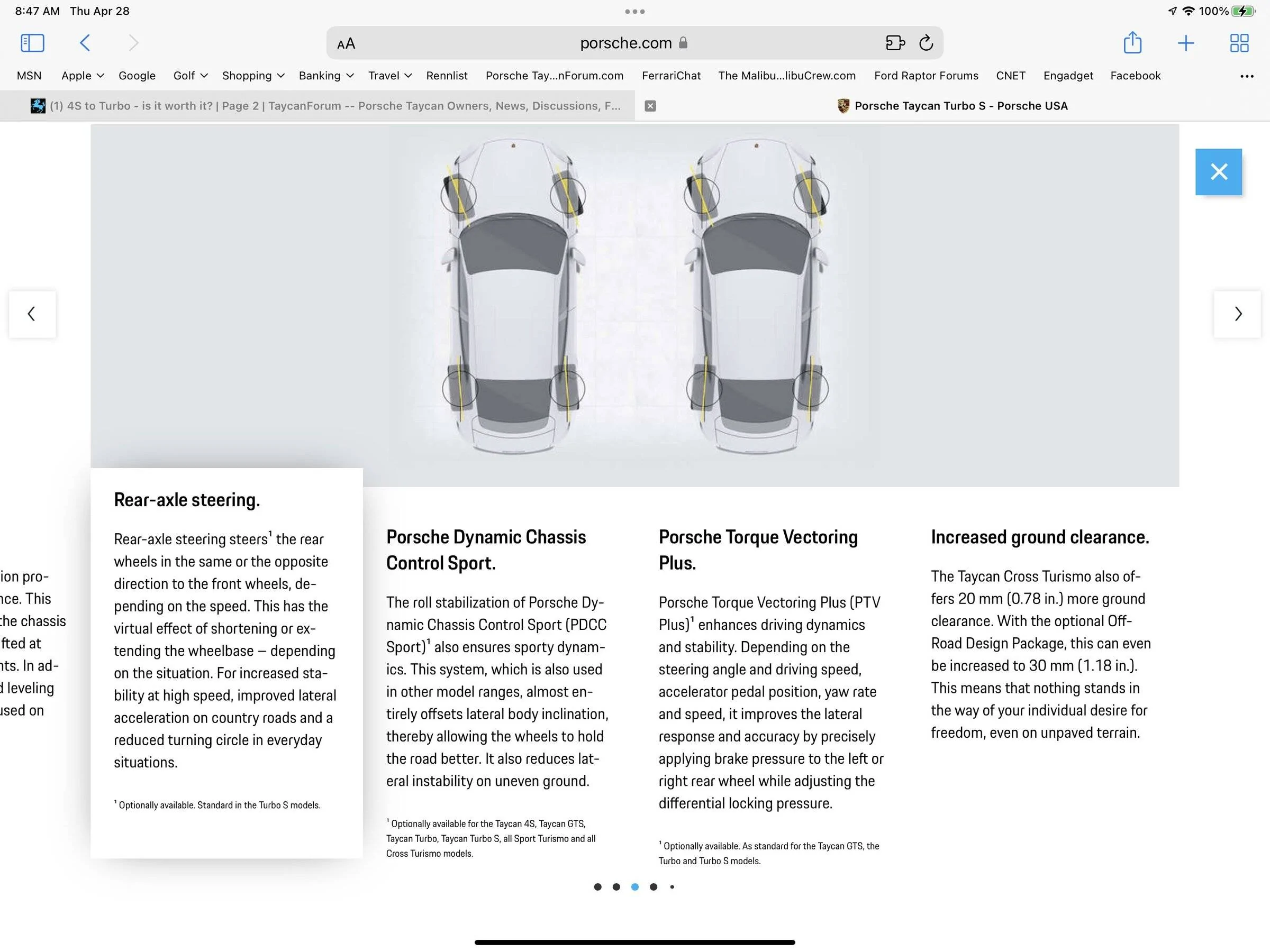

I went from a 2021 4S to a 2022 turbo S and the change is MASSIVE. Not just fast launch control which is almost too fast but in day to day highway driving it’s amazingly more nimble and planted.
Your 4S must not have had performance options. Similarly specced, there is no difference in the handling.

Actually @Archimedes the Turbo S has Standard Rear Axel Steering the Porsche Torque Vectoring. I know the former is a option on the 4S (I believe only 2022) and the later is not an option. Both make draumatic difference in driving/handling. I put 9000 miles on my 4S with 20 inch turbo Wheels and the performance battery and have had the TTS for a month. Spend a month in each and come back and tell me is makes no difference…lol

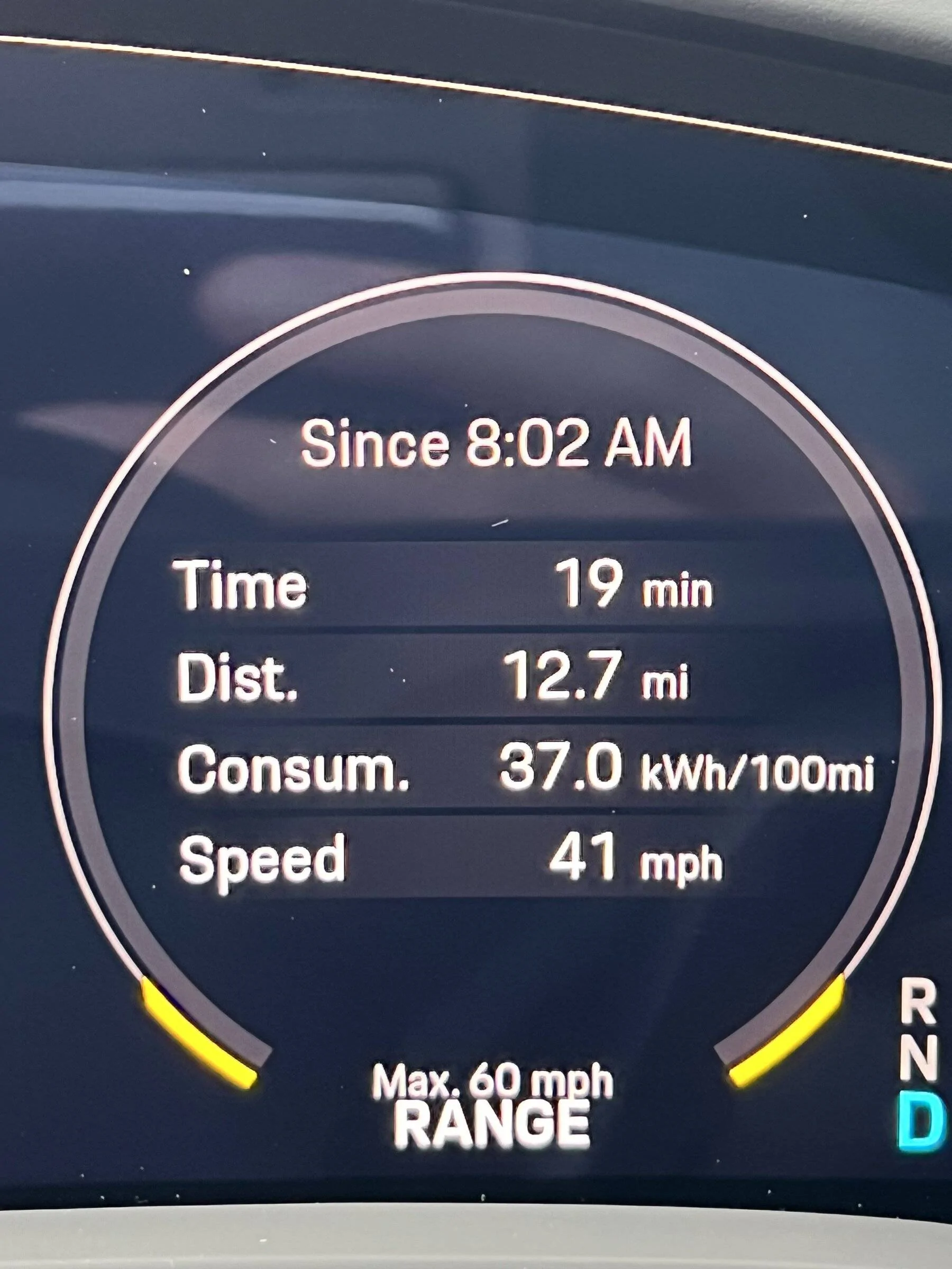

Regarding range, @KTC and I work together and live near by as well. I will say the very best range I ever got on my commute in my 4S was around 29kWh/100mi. This morning, I drove to work as mellow as possible In range mode with zero traffic and was only barely able to squeak out 37kWh/1000 in my Turbo S. I’m sure @daveo4EV could understand what this means. I assume its the higher tuned engine and/or the 21 inch E mission wheels/tires.
