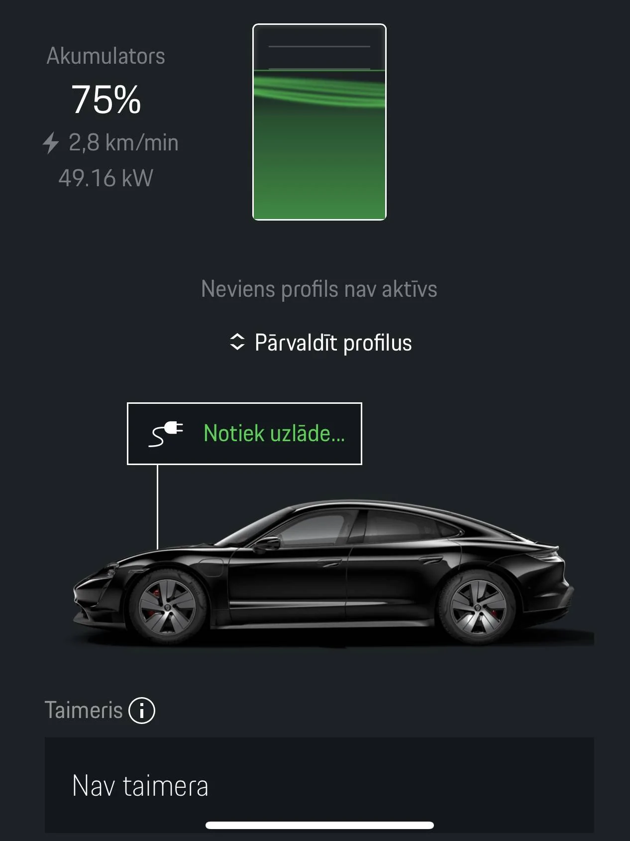

Charged yesterday using CCS on a 50kw charger. Got almost 50kw all the way until 93% (normally would charge to 85%)

Relax!
50KW is NOTHING at 85%! Stop worrying. I would expect the car to take 50KW to well past 90%...
Here in the US (with 150KW or 350KW charging stations) we typically see 100-150KW at around 80-85% SOC. In fact, if I was only getting 50KW at 85% I would be complaining how painful that is... The car decides how much power it can take - not the terminal! (The "charger" is actually inside the car in any case - not in the "EVSE" you are getting your power from. The EVSE Terminal is merely a big electrical source - its NOT the charger).
...and there is absolutely no problem taking your charge all the way to 100% (at whatever speed the car accepts) on an occasional basis. Particularly if you will be "driving it off" in the next 24 hrs...
Who is telling you this is a problem? Who is scaring EV owners into thinking this should be so complicated?
