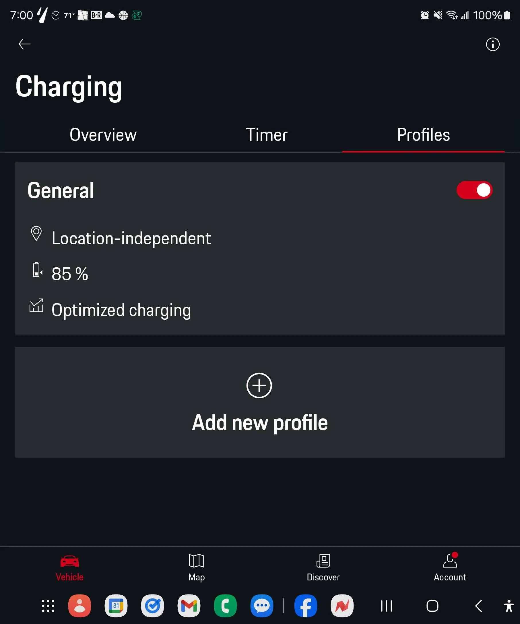

I’m going to revise my earlier comment about “it will start charging when I have it set.” It did not do that. With a Profile only, the car charged to 100% overnight.

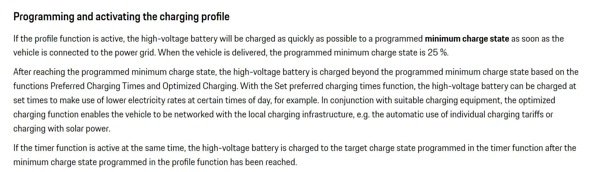

Is your profile set to optimized or preferred times? Optimized will stop at the minimum if there is no HEM. Preferred times will charge to 100% if there is no timer.
Watchesandburgers
Mark
Feb 11, 2024
432
521
www.instagram.com
Porsche Taycan GTS
@Jhenson29, your short reply would have concluded this discussion 407 posts ago had you said it so concisely at the beginning. Brilliant! "Optimized will stop at the minimum if there is no HEM. Preferred times will charge to 100% if there is no timer."
My preference is to charge from 10:00 PM to 7:00 AM to get the best electrical rates, charging to a maximum of 85%. Hence, I now have a timer and a "Home" profile. TYVM.
