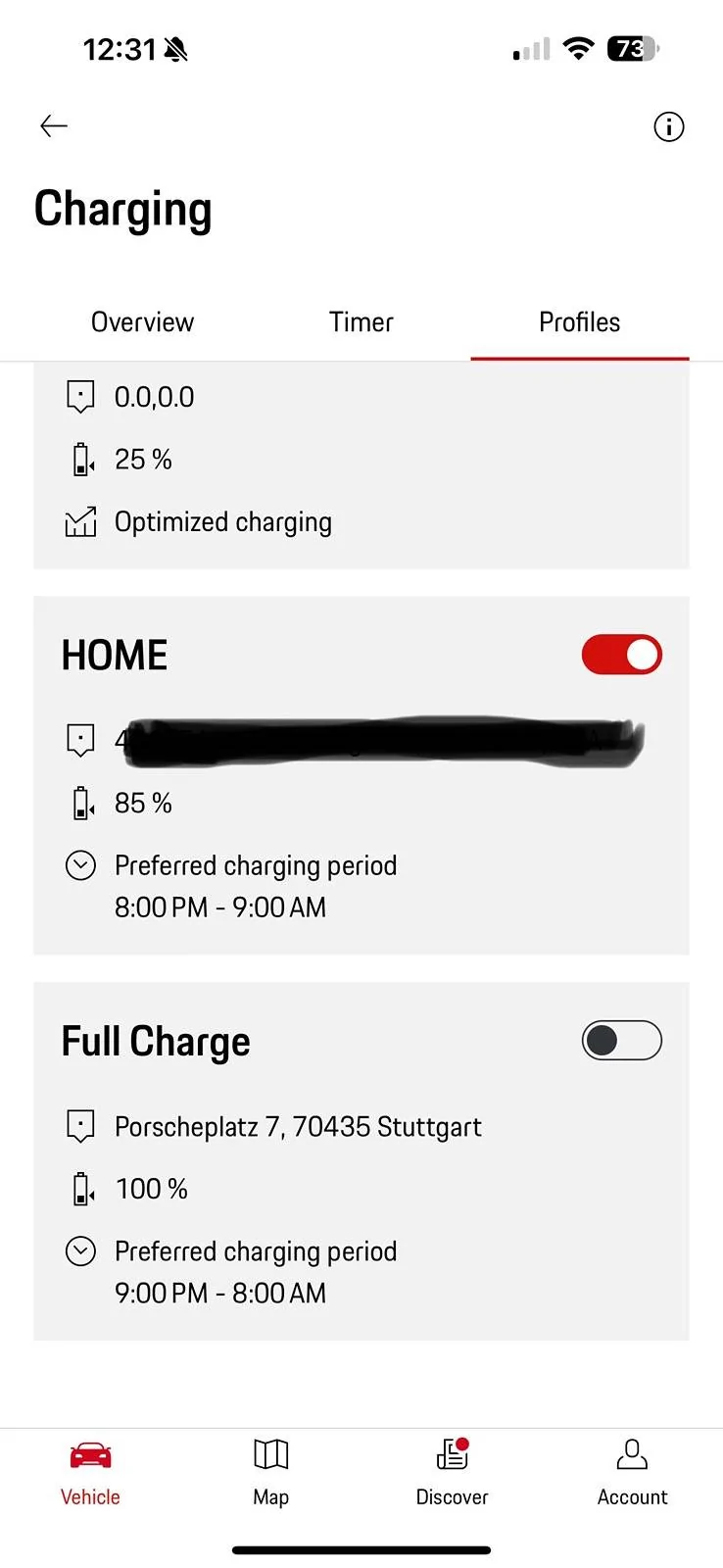

I just got our Taycan a couple of weeks ago but just set up some different profiles. I did one for 85% and one for 100%. I’ve had no issues charging to either, just set the one you want and send it to vehicle
to vehicle.
I have the exact two same profiles set up. LA Porsche Experience Center Mgr and a track star recommended 85% for local and 100% for trips. Said don't worry about 100% even at DC chargers if you precondition.
11,064
6,846
Profiles and timers are ignored when DC charging - I'm sure you realise that but just though I'd make sure.
Gotcha thanks, just indicating that when traveling to charge close to or at 100%

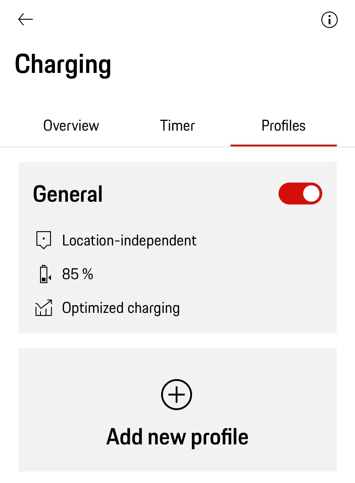

It’s easy to change the charge percentage using the My Porsche app. On the Home Screen touch the > at the right of the percentage | range row, then touch the Profiles tab at the top of the next page, then touch the percentage, then a slider appears, which you can use to set the charge.
