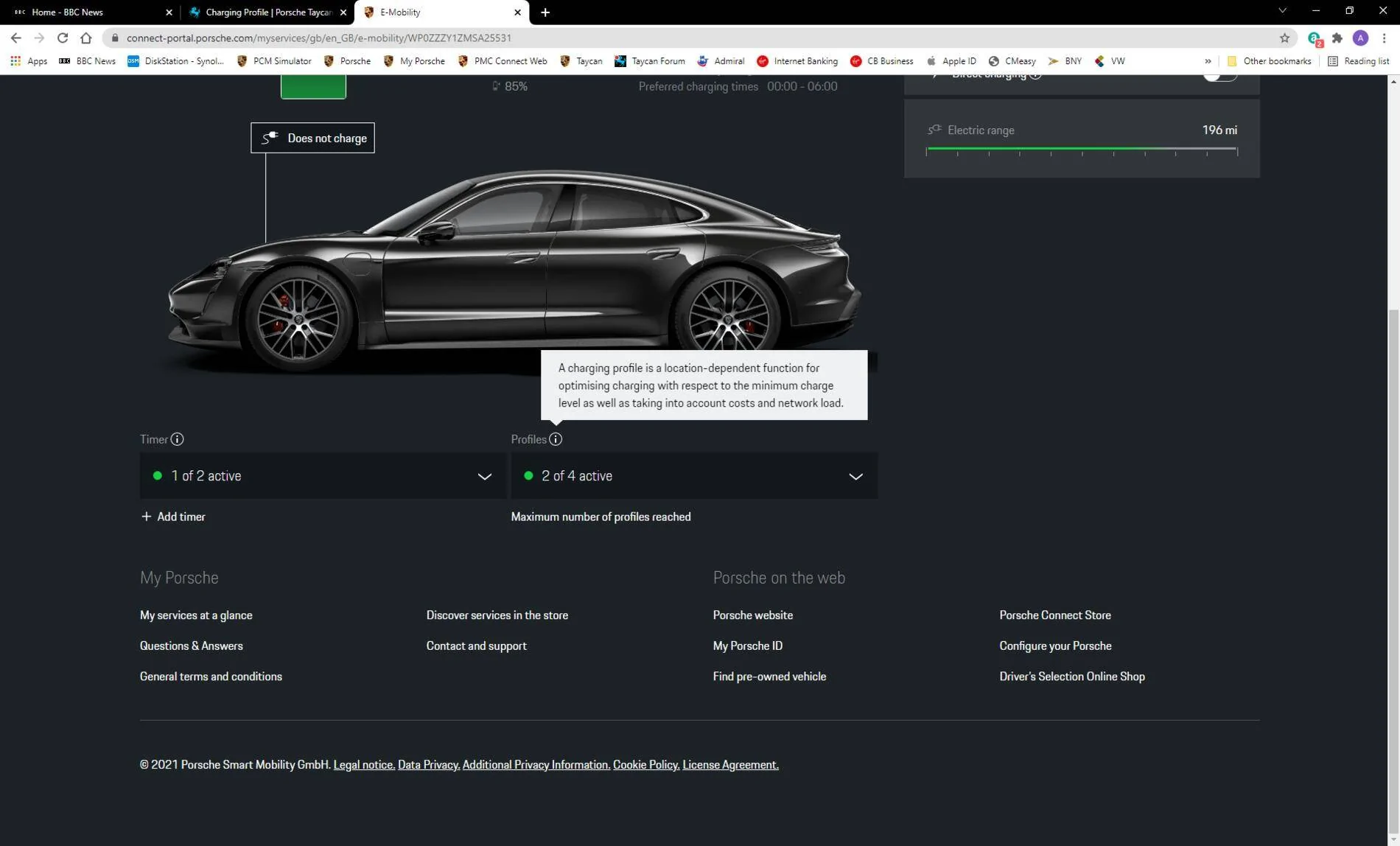

You can't set a target charge on a profile - this can only be done on a Timer where a 'Target Charge' can be set. Profiles provide the feature to set a minimum charge (25% or higher) - so not a precise means of control. Minimum in this case is 85% but no means to control the upper limit.

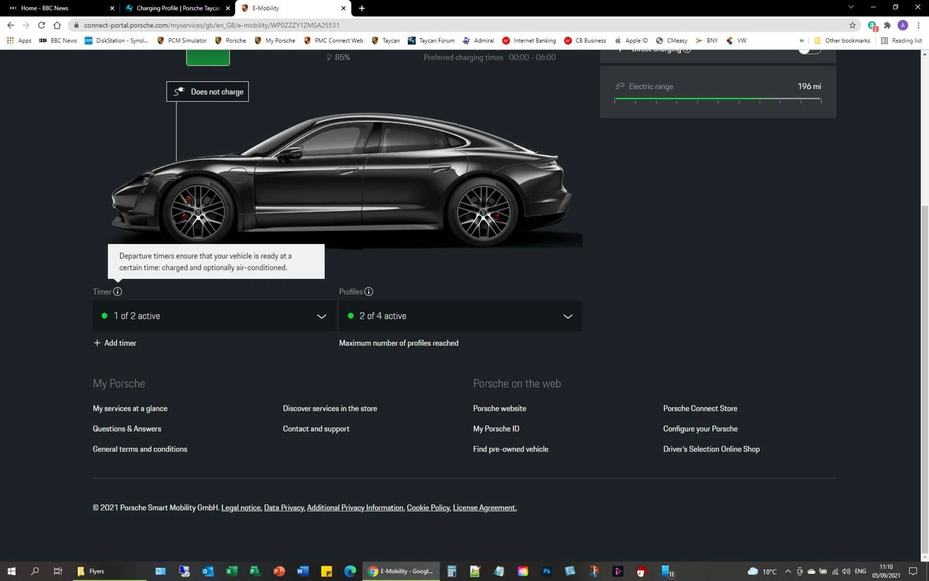

In order to (now) control the precise charge and end time then you must set a departure timer (Timer) otherwise you run the risk of overrunning the expected time slot.
I've always used both a timer and a profile since day 1 but others haven't and I think that since one of the recent software updates to the car the treatment of these may have changed. I've therefore not noticed any difference in behaviour of profiles.
Note that the charging period in a Profile is labelled "Preferred Charging Times" which doesn't necessarily imply rigid adherence to the time slot booked. It works best with the Porsche Home Energy Manager which I don't think is available in US and the Optimised Charging feature.
To ensure precise control you need to add a departure time - this controls when the charging ends and charging is paused. Obviously you don't have to drive the vehicle i.e. 'depart' but it is the reliable way to lock down the charging end time.

Set a timer too. Note that if your battery charge is less than minimum charge value set in your profile the car will charge immediately and then pause when target is met. Typically set this value to 25%

As @W1NGE mentioned, the car will charge to the profile minimum as soon as you plug in. The lowest this can be is 25%. And actually, the car will always charge to at least 25% when plugged in, regardless of settings.
Then you can use the profile preferred charge times to control the charging window for the car, but it will charge to 100% (if time allows). There is no way to set a maximum for this. But that’s the only way to actually control the start time.
Otherwise, you have to use a timer to set a target charge and end time.
