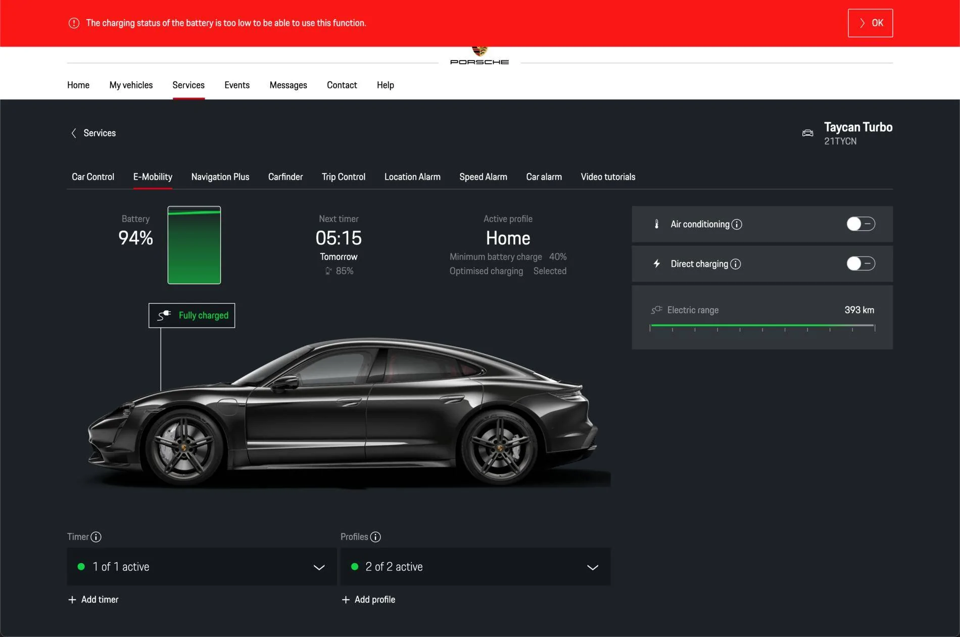

This is the third time it has happened my Taycan to charge do 100% on my home three phase AC charger, despite I have a Home Profile which says no more than 80%. Here's a pic of my centre console display, which shows both, my Home Profile being active and 80% being the limit... and the current charge level.
Does this happen to anybody else?
Also, I've noticed this happens only if my car stays connected to the grid for more than a full day. The Porsche Taycan User Manual states its preferable to keep it connected at all times, if possible, however with the COVID-19 situation I don't leave the house much, hence the guys sits in the garage connected for days.

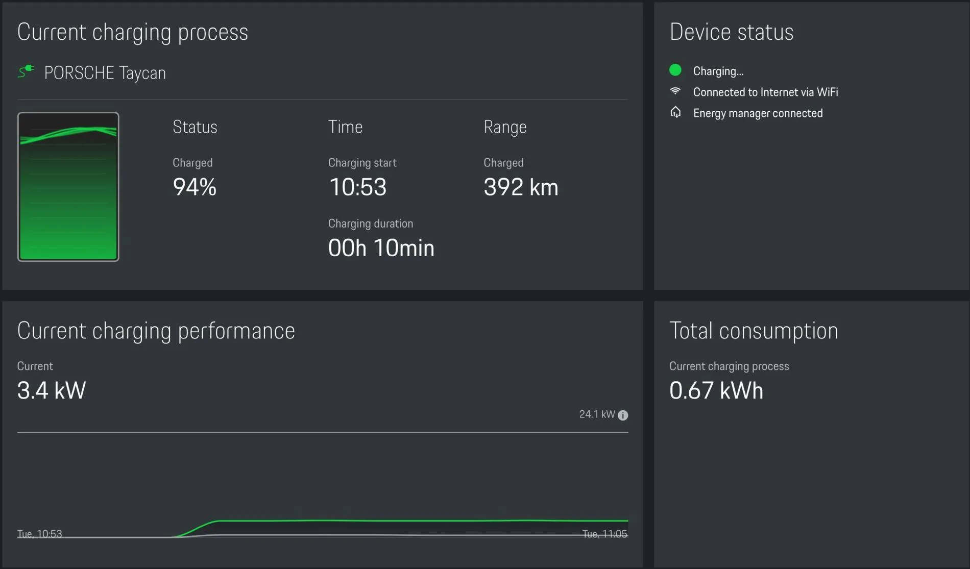

I am having the same issue however it seems to only happen on a Sunny Day as I have a PV system with excess capacity so I feel the car is trying to use that (only Charging at 3kw) however it will ignore the 85% max setting. I feel there is a bug in the optimised charging settings.

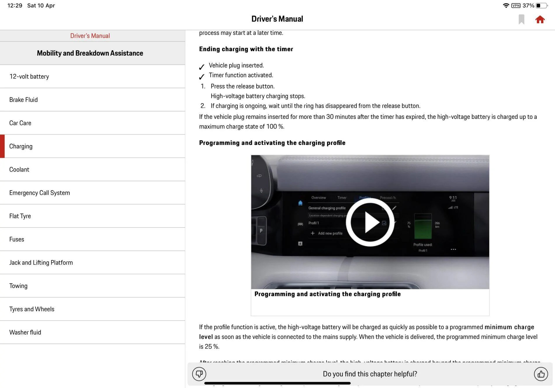

if the car remains plugged in for 30 mins after the expiry of the timer then apparently it will ignore the timer ceiling charge level and charge to 100%.
Not my experience. I have a profile, charge min to 50% and I have a timer set charge max to 90%. So it will charge right away to 50%, then it will pause charging and charges to 90% to reach the time set in the timer... Worked well so far...

My experience matches @feye, profile sets the base, then car will charge to timer setting planning for that time, then will remain at that charge no matter how long its plugged in.
That's not correct.
Use a timer and a profile to control maximum charge say to 85%.
Proper use is well documented on this forum so please search a little and you will find guidance and videos.

I can also agree with the behavior described by feye (I charge to 85% at 6am and have routinely unplugged well after 9am with the battery obediently charged only to 85%). I got rid of my profile, despite having a time-of-use rate plan and just set one timer for 6am - cheap time for me starts at 9pm and at 240V 40A, 9pm - 6am is plenty of time to charge so the profile with preferred charging times was just redundant.
