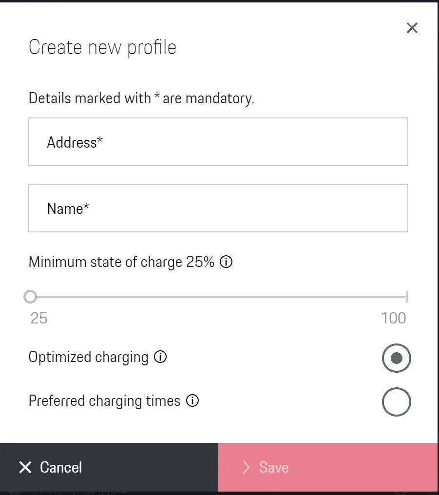

I think it should say min, not maximum. If you are setting it to something that says maximum you are probably in the wrong spot.

I have the same problem. I have a timer set and the profile set. With a Maximum of 85% and a minimum of 25%. Only have one timer and one profile checked. And it charges to 100%. This interface is way to strange for anyone to understand. What am i doing wrong.
if the car remains plugged in for 30 mins after the expiry of the timer then apparently it will ignore the timer ceiling charge level and charge to 100%.

is the direct charging on? having direct charging on overrides any profile settings
Not my experience. I have a profile, charge min to 50% and I have a timer set charge max to 90%. So it will charge right away to 50%, then it will pause charging and charges to 90% to reach the time set in the timer... Worked well so far...
What exactly did you setup?

My experience matches @feye, profile sets the base, then car will charge to timer setting planning for that time, then will remain at that charge no matter how long its plugged in.
That's not correct.
Use a timer and a profile to control maximum charge say to 85%.
Proper use is well documented on this forum so please search a little and you will find guidance and videos.

I can also agree with the behavior described by feye (I charge to 85% at 6am and have routinely unplugged well after 9am with the battery obediently charged only to 85%). I got rid of my profile, despite having a time-of-use rate plan and just set one timer for 6am - cheap time for me starts at 9pm and at 240V 40A, 9pm - 6am is plenty of time to charge so the profile with preferred charging times was just redundant.
