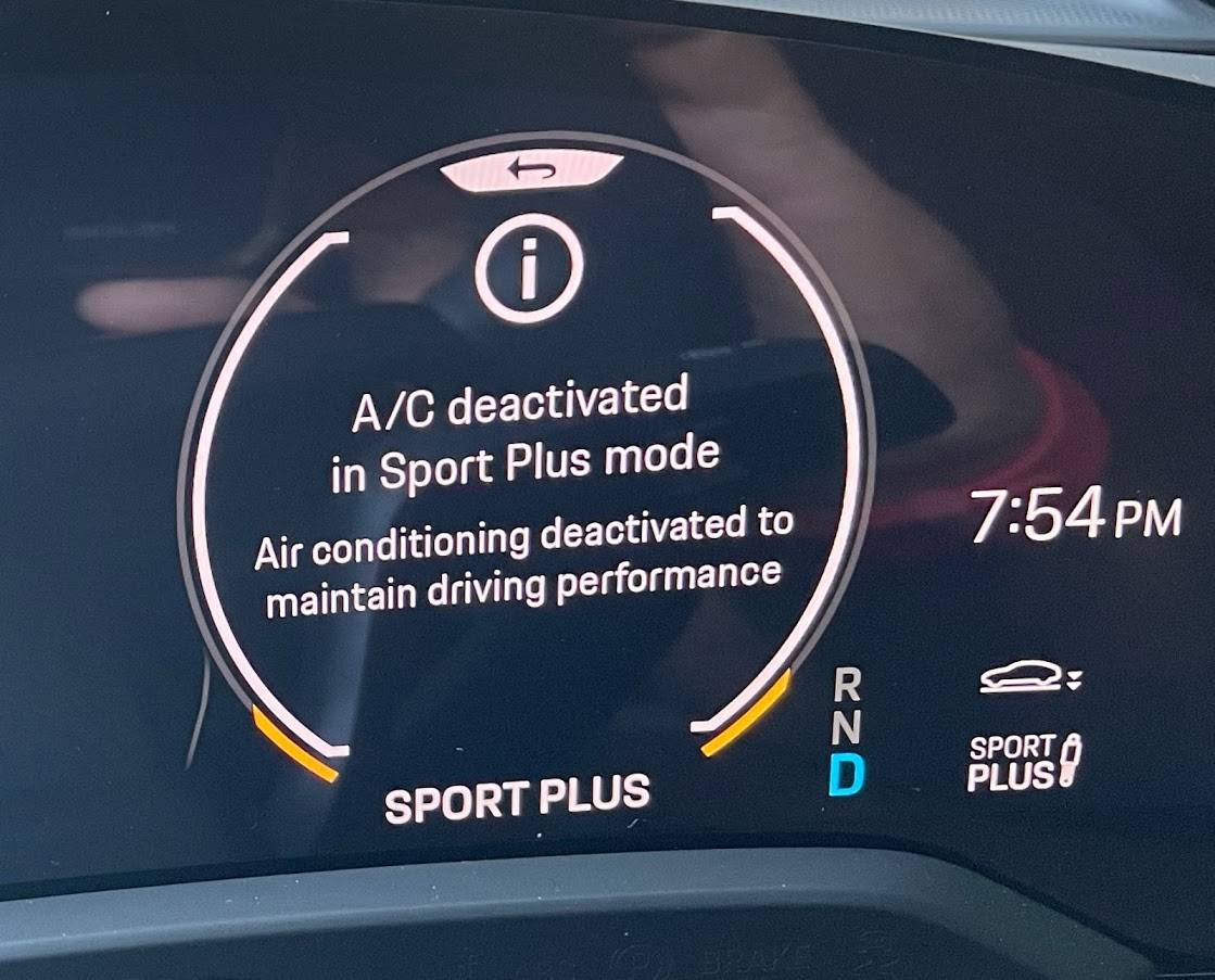

Reviving and old thread. I have been getting this message more frequently lately. I live in FL and its been very hot and humid. I always Drive in Sport Plus and it comes on maybe 3-4x a week. No rhyme or reason, but mostly in the peak heat of the day and sometimes early evening. Drives me crazy as I keep my AC at 60 in the car and I do not want it off (so I have to manually click the climate icon and the AC icon). Wish I could tell the car to never disable.
It will be battery temperature, the default instrument layout shows that in the right hand dial.

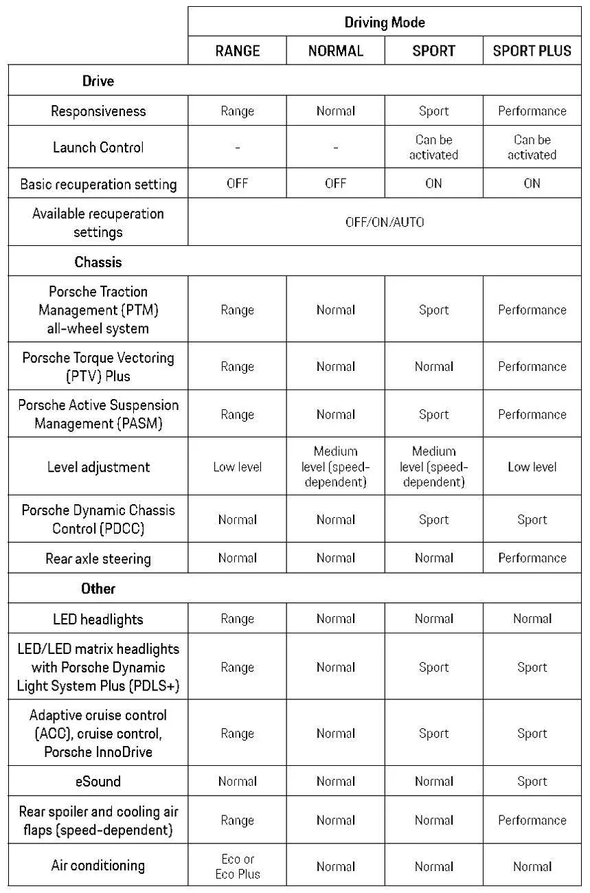

Sport + closes off some cooling for better aero and for better power but if the battery gets too hot it can be damaged so since sport + assumes you are going for performance over comfort sport + chooses that compromise.
