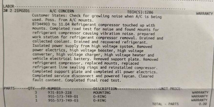

Just picked up mine today. Here's what was done:
Drove 45 miles home with the A/C on in 100 °F (38 °C) weather without any growling :whew:
