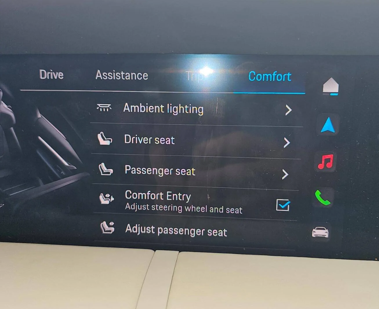

Where do you access comfort entry from?
Can you set this as a default when you stop and before you enter?

Perhaps it's an optional extra.
Nothing like that in my car/comfort menu
For clarity:
This thread conflates three different and unconnected things:
- Active Ride, a new (and expensive) option that among other things raises the vehicle on entry;
- Comfort Entry, which just moves the seat and wheel; and
- Smart Lift, which raises the vehicle while driving, eg when you want to transit a bumpy road
