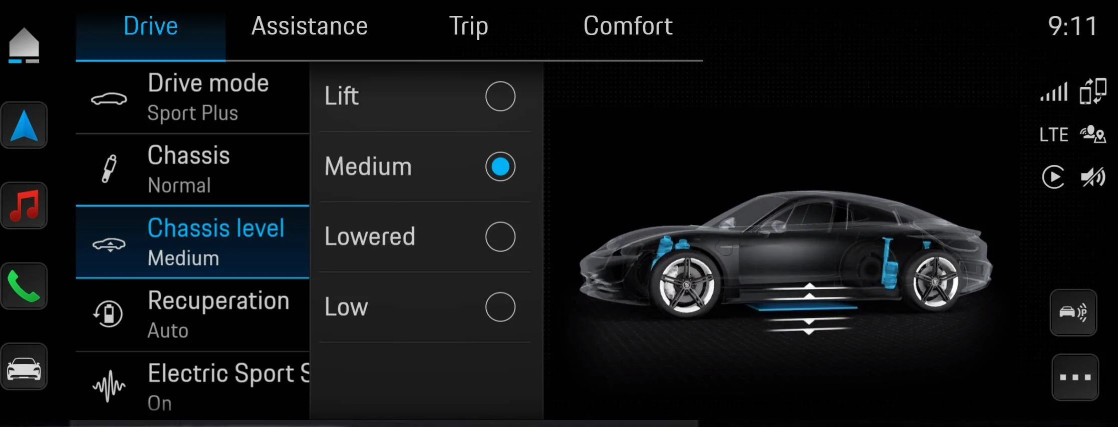

> Does the ride height automatically change based upon what drive setting is selected? If so, can someone fill me in as to what the respective settings default to.
In default mode your ride height will be regular. Sport modes will lower your car. This is important to be mindful of if you're driving in unfamiliar roads that might have dips or large bumps.

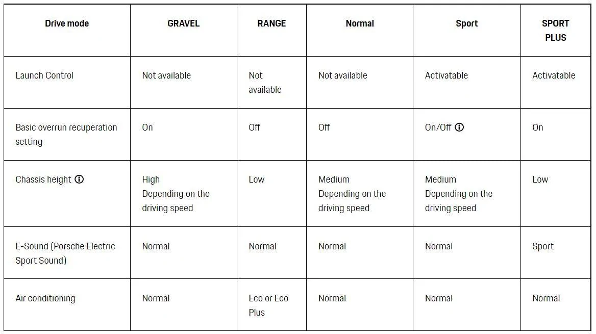

Height auto adjusts.
Depending on Drive Mode selected drive height will vary from Lift to Low
Porsche Taycan Ride height automatic according to drive mode ? 1672918031745
Range Drive mode will typically lower the car to its lowest setting as well as raise the rear spoiler (speed dependent) and shut off external vents etc.

Range is the great divider here and in UK / Europe range is generally lower (ambient temperature dependent) than warmer US states. For this reason Normal Drive Mode is probably the default for most as Sport drive mode does consume more battery - even at a standstill. We're only talking a few miles but it makes a difference (to some).

Note 1: If you're in Normal mode, for instance, the car is at normal height but if you manually lower the car it'll stay that way, the car remembers that setting the next time you'll start it.
Note 2: In Normal and Sport mode the car lowers itself when going over 90km/h and returns to normal height when you slow down again.
Normal and Sport are linked when it comes to ride height, very strange.
