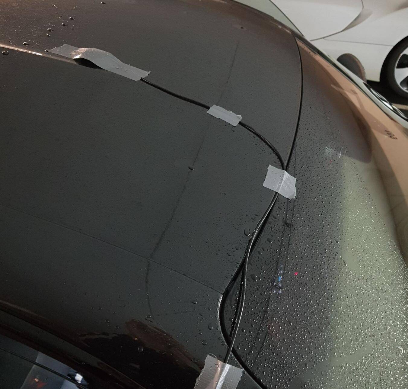

glad you are in here, didn't notice it. may be you remember my question during your online event:
very likely the breathers help to lower the drag, but in the order of magnitude of perhaps 1%. So very hard to capture with road testing where other variables have a lot of impact.
why guessing? :) I think you have all the tool and models to get concrete results of the losses?
- The height difference, for example, is 21 meters (-16 versus +5). That represents an energy difference of E = m * g * h = 2200 kg * 9.81 m/s² * 21m = 453 Joules
I excluded the height for a reason I may explain: the height channel of normal GPS devices (Smartphone in that case) is usually too unprecise to use it more than than a rough plausibility check if the test run was okay or not.
Usually I use professional test equipment from Racelogic (Vbox etc.) which are providing much better (doppler based) velocity vectors like vertical speed with at least 10Hz. This is proven to be usable like "okay" in meters but still has less precision as horizontal precision which is nearly to cm, but always very important to have good GPS reception and an external antenna, especially with the solar insulated glass option.

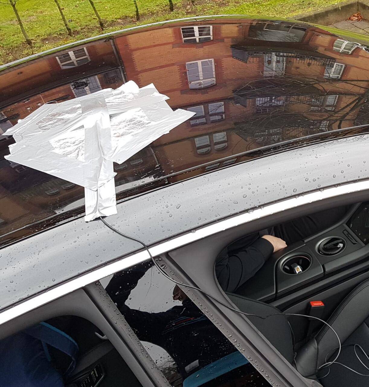

Porsche Taycan Aero comparison of electric charge doors vs. manual 1662102176079
and even more difficult with the glass roof where you need to go sure to have a reflecting surface done with aluminum foil.
Porsche Taycan Aero comparison of electric charge doors vs. manual 1662102827757
