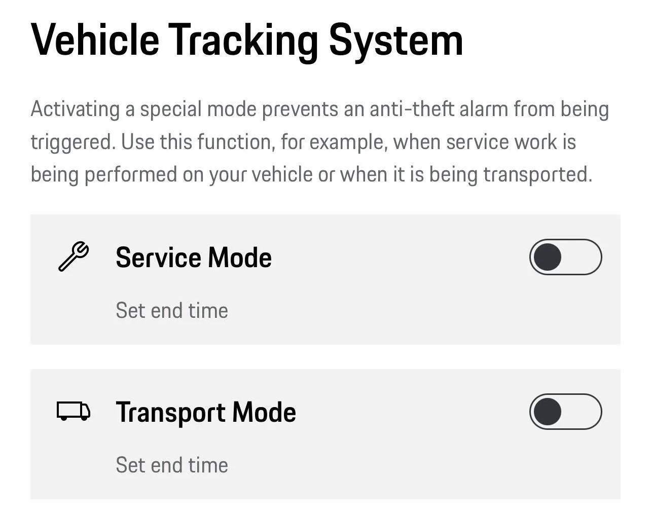

If you've subscribed to the Porsche Vehicle Tracking System, you can set transport mode and service mode in the app:
But there are caveats -- see this post:
LOL at 'caveats'. Yes, the alarm going off on the ferry is better than the car being immobilized by its security system on the ferry and having to repeat water crossings until it can be recovered......
