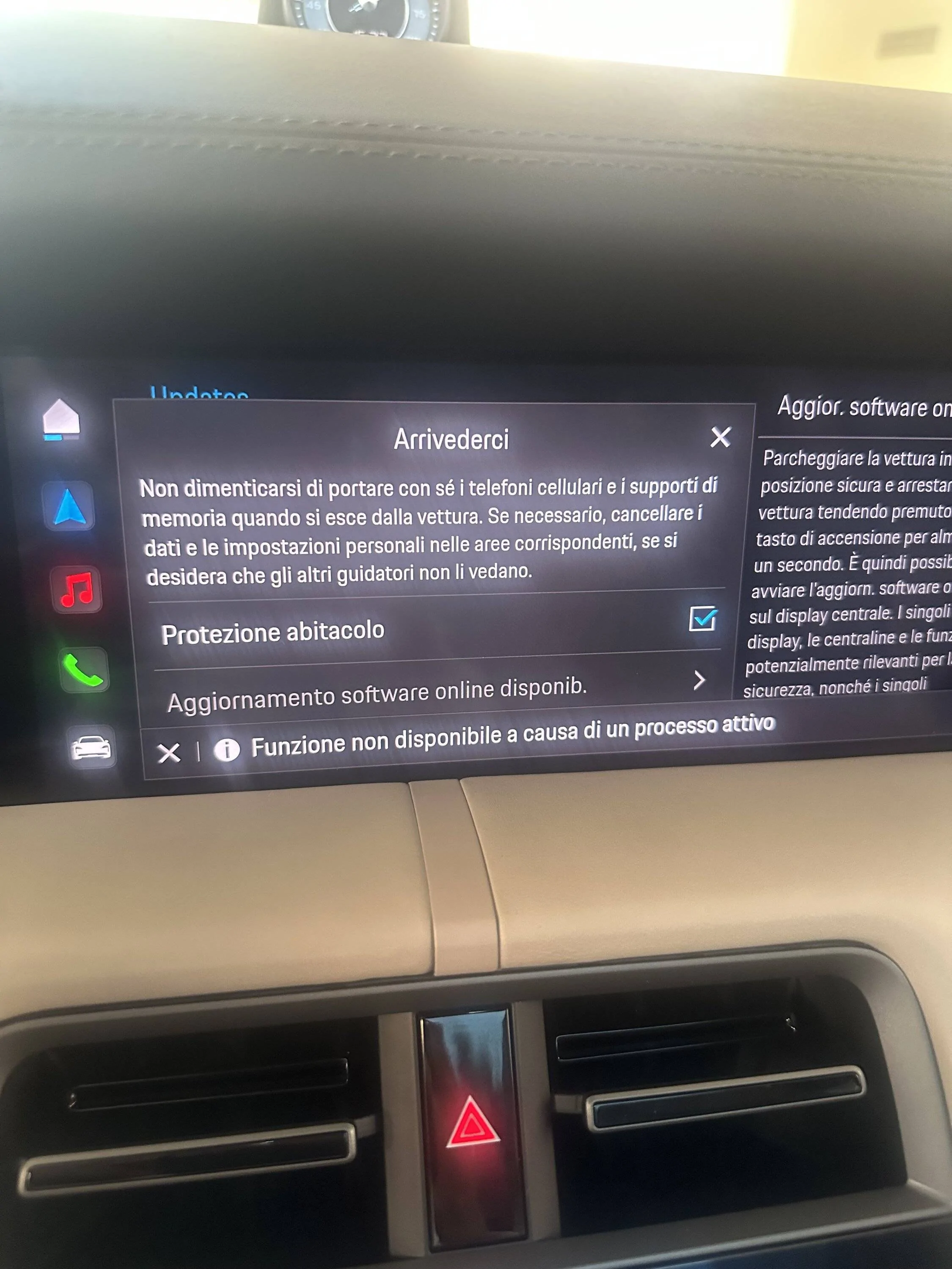

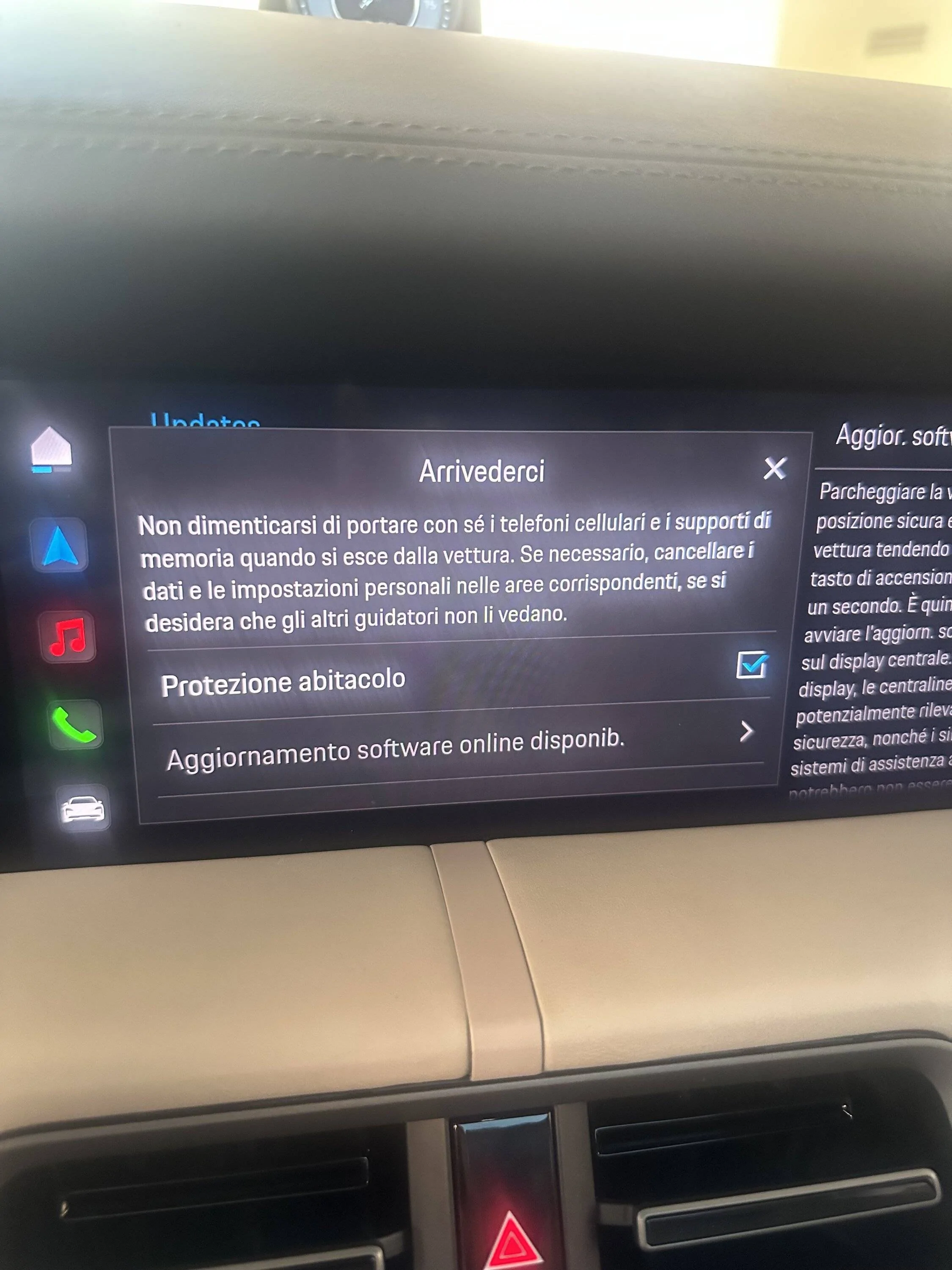

Hi everybody! I’m Andrea and I have a Taycan 4s. I’m writing here because I’m having problems to activate the upload: as you can see by the images I can’t push to the button to start the upload because (once I switch the car off, before going out) a message says there is an ACTIVE PROCESS. Could you please help me to understand where is the problem? Thank you so much
Try the two finger reset on the PCM (top right hand corner of the display). Search the forum for more tips on this reset.
Thanks for the answer. I followed instructions on YouTube and I made a reset. But I have the same problem: the message remains in green and if I click on that it says there is in the car an active process… did anybody had my same problem? I can’t find any solutions, I tried also to contact porsche service but they can’t help me! Thanks so much
