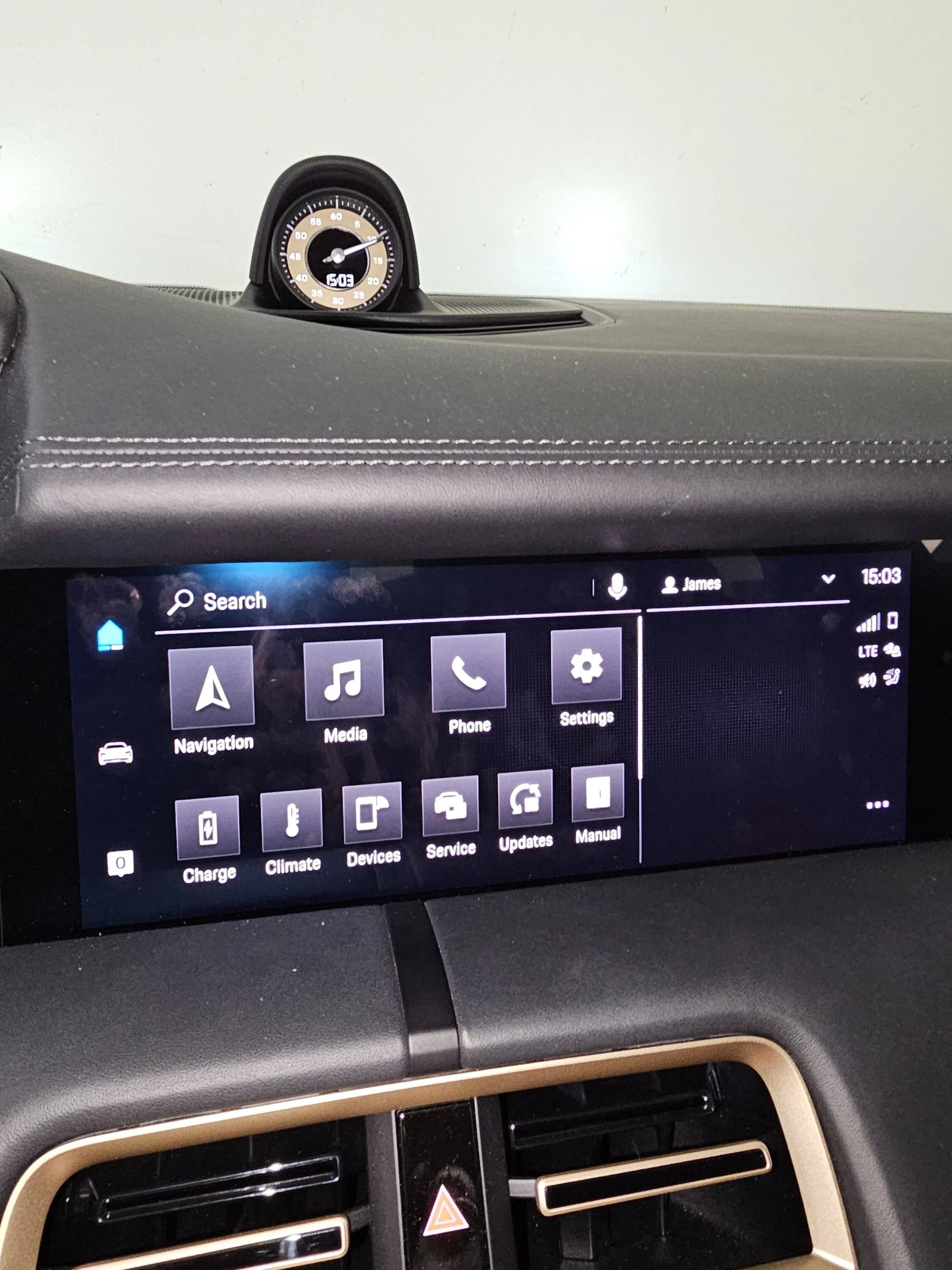

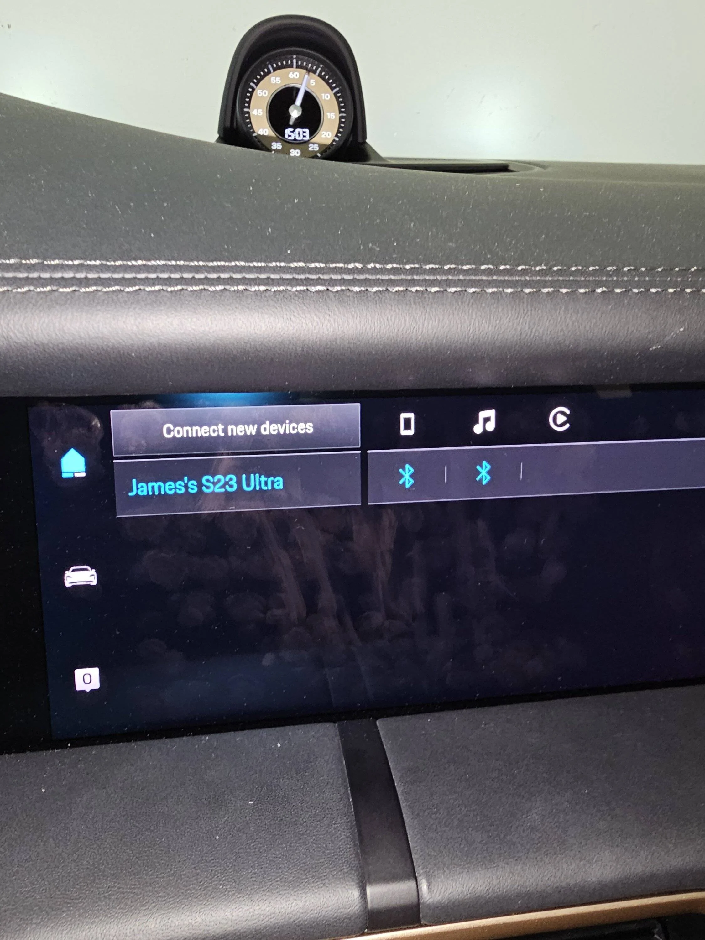

Hmm. So something must be wrong. I've attached the photos to demonstrate what my dashboard shows.
When I click on software update, it says searching for update and then tells me that I am fully updated.
Your PCM is missing the largest software update called "uPdate" - coloured icons and tiles.
How did you miss out on this?
AA will be resolved once you've upgraded.

I only just bought the car. How do I get this upgrade?
11,103
6,871
Porsche Dealership.
Takes a full day.
Released last year.
Suspicious to me that you don't have it and would question the provenance of the car.

Why do you say that? I bought from a Mercedes garage in France who had just purchased from a regular wealthy client who had barely used it.
11,103
6,871
It was a global recall by Porsche to bring all MY20 - MY22 cars up to MY23 software spec A franchised dealer would not have been permitted to sell it without this upgrade.
Go back to the seller and make some noise.
