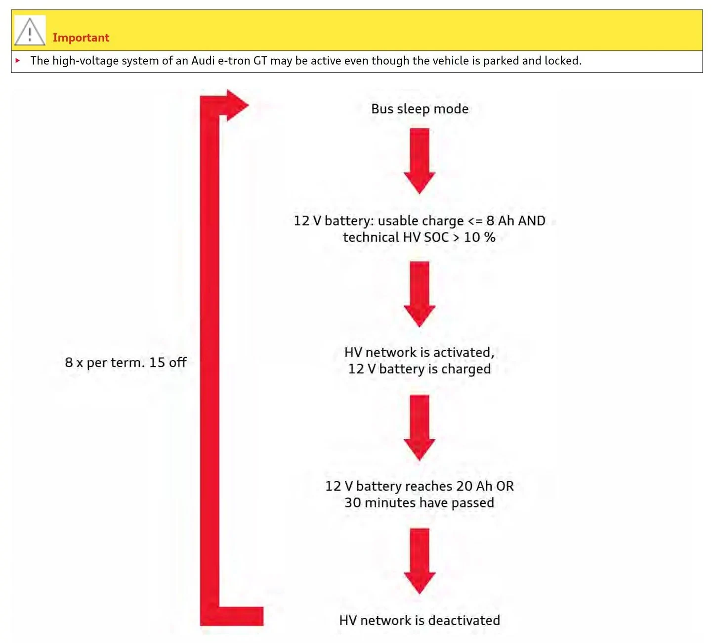

Absolutely not. We have plenty of people here having 12V battery issues that use their cars every day. There have been two reports in the past week alone, one of them on J1.2.
It is widely known that there is a lot of issues with the 12V batteries themselves. Due to the Taycan topping up the battery it doesn't rear it's ugly head immediately, but on the Cayennes it's a very widespread issue...
Any 12V issue is the car being broken, end of story. If you can't afford/don't want to fix it that's on you, but that doesn't mean all the cars have issues.
I've left my Taycan for over 1.5 months last summer, didn't leave it plugged in, zero issues. Turned on and drove completely normal without any problems or errors. I will do it again this summer on my J1.2, as I spend the majority of the (fairly short) summer on my yacht.
