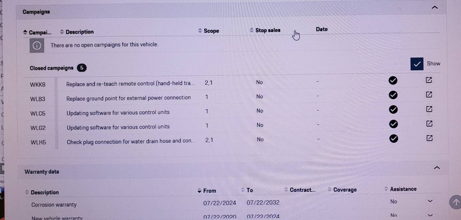

Yup - maybe Porsche has deemed this a 4S-specific issue? Here is the Porsche service screenshot on the campaigns closed for my VIN (with none open) on the Turbo S at least.

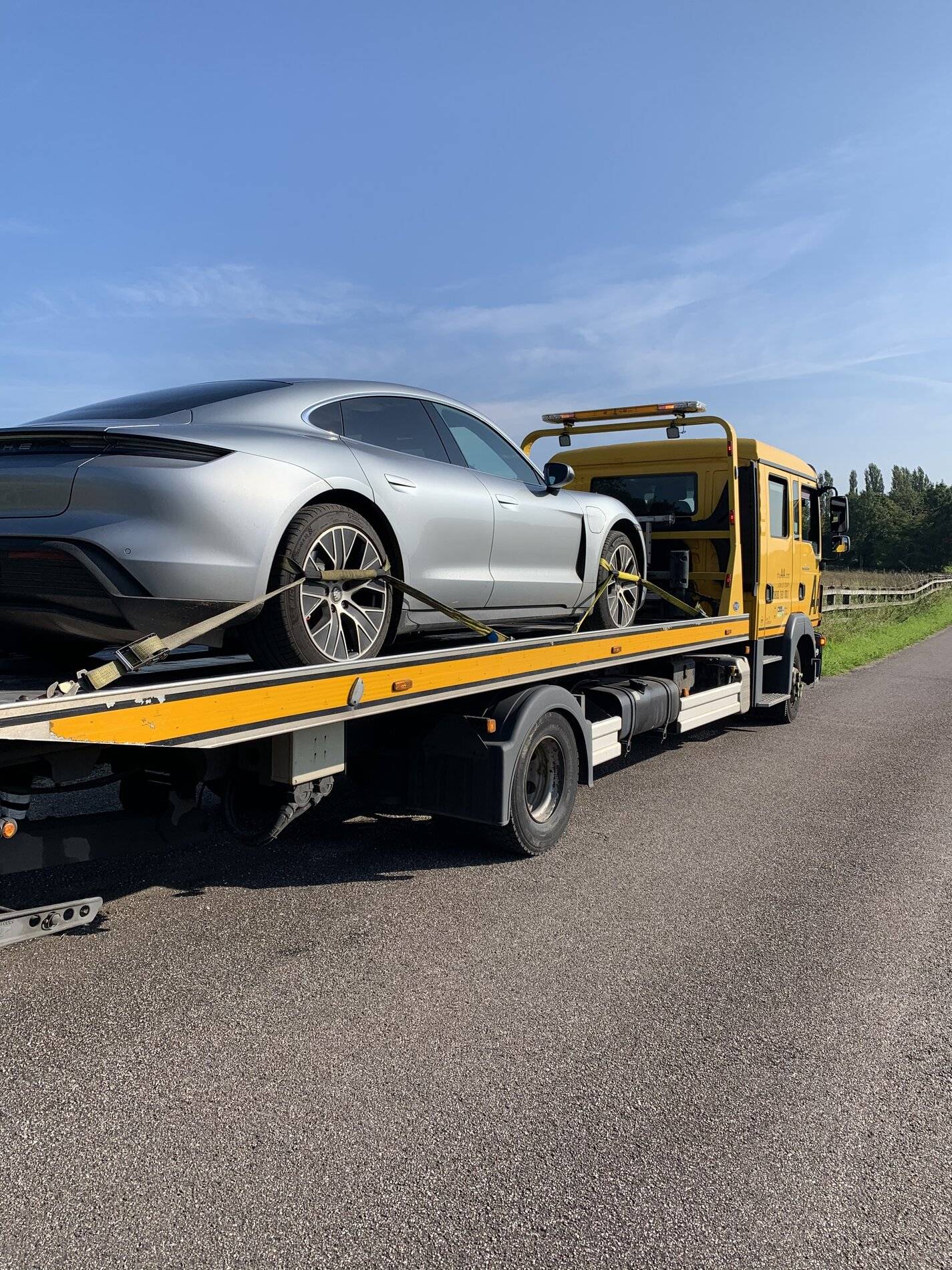

My business partner text me a pic of his car this morning on the back of a low loader heading back to Porsche Chester.
seems there’s a problem with certain chargers and the car software. There’s an update being distributed by recall.
should be an update OTA rather than a dealer recall...at least for all other owners whose cars are still "alive"
