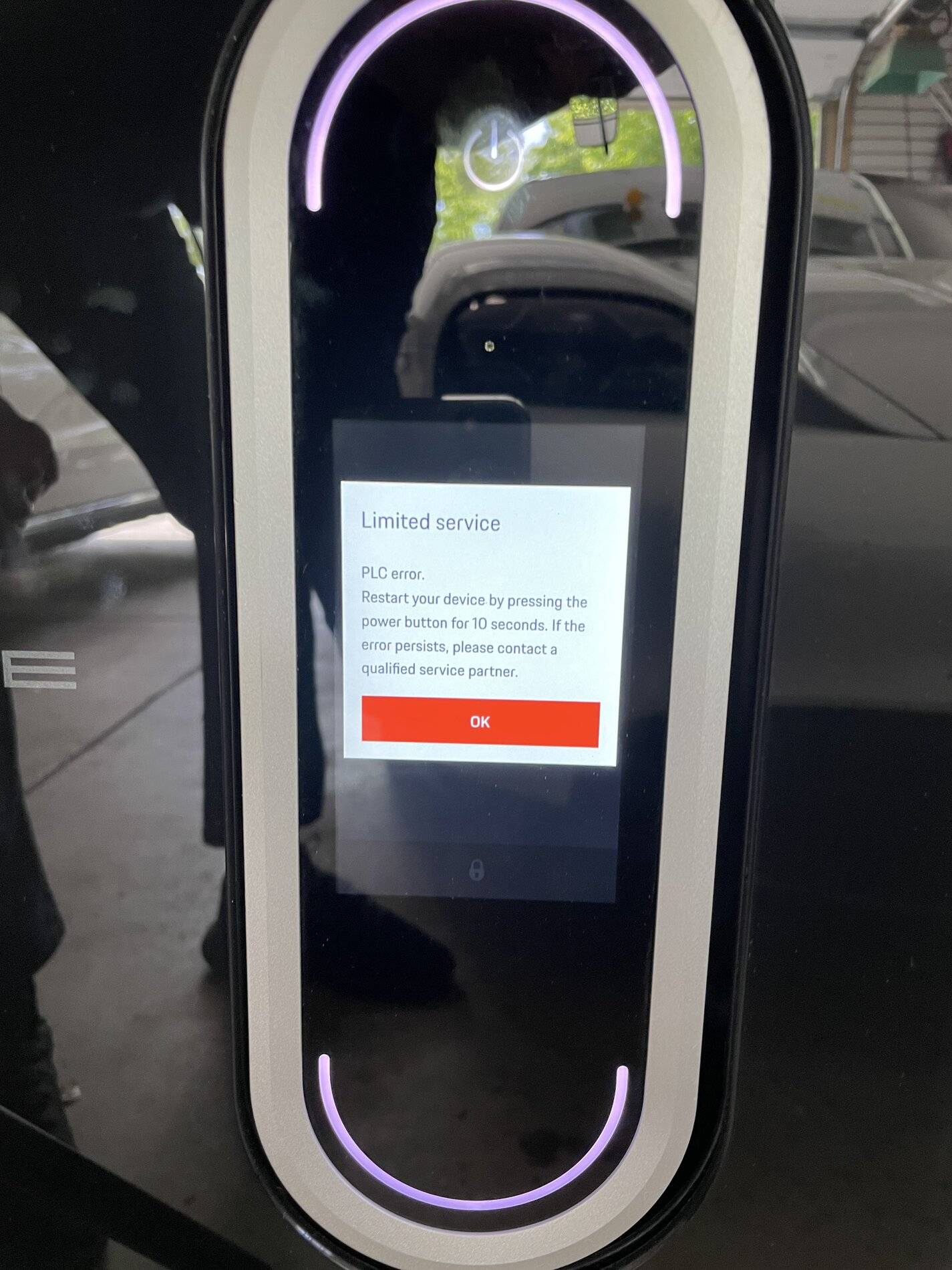

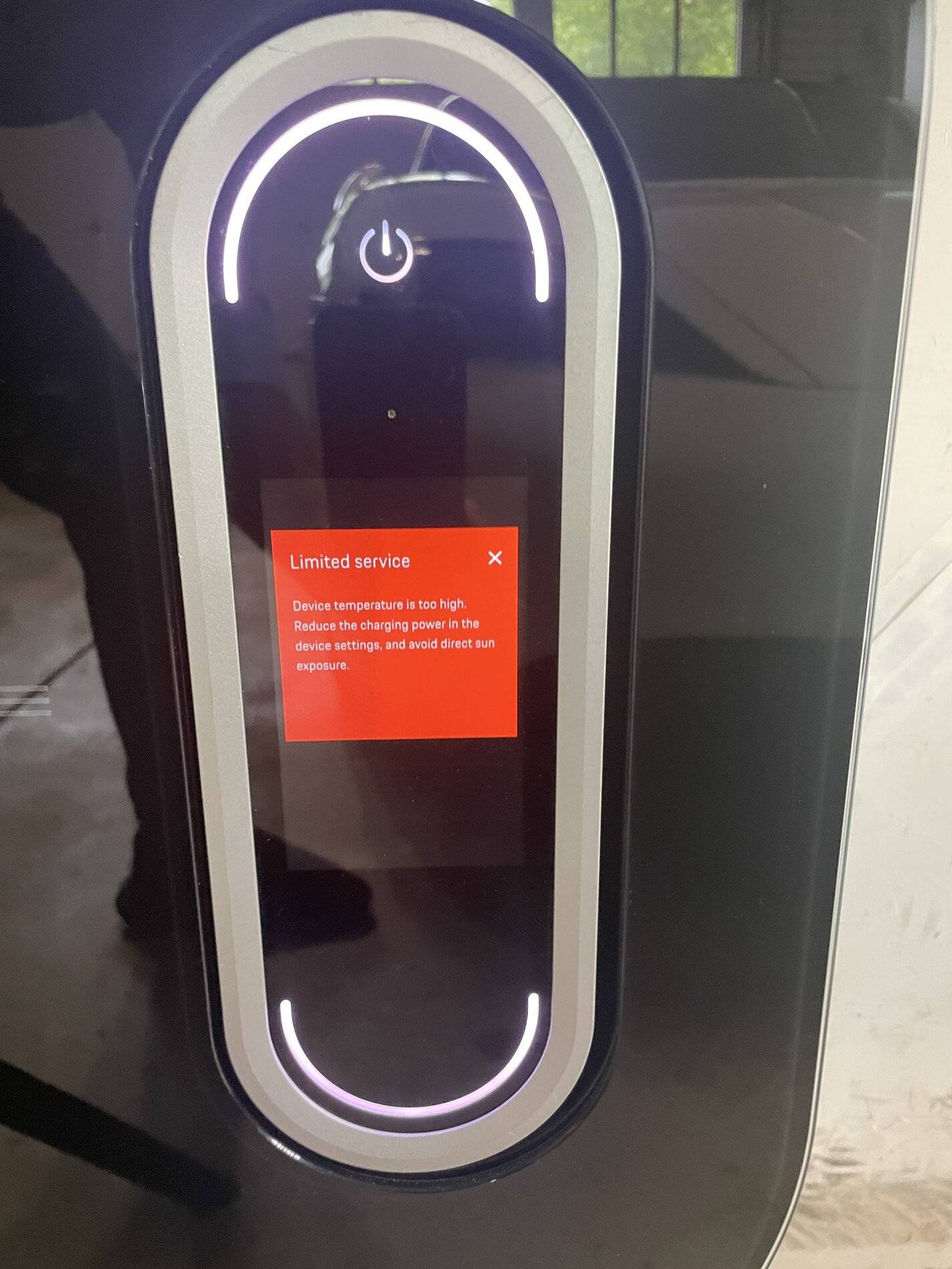

I am really getting tired of Porsche not having a handle on their software. Due to the 'update' I have been getting an error message every time I charge the car. I fiddled with the menu and various settings and managed to eliminate the message one time, but it has returned. I will get one of the following two messages every time I charge.
Despite these error messages, charging is proceeding with no problems whatsoever. I'm told to 'ignore' these messages. :mad:

Hi @Vim Schrotnock , I got the same 'device temperature' error message recently and assumed it had to do with the rising temperatures outside. The next time I charged, I left the lid of the PMCC open and did not run into the same issue, but that could of course be a random event with no proven relationship between keeping the lid closed or open and the device temperature error message.

The PLC error is easy to solve. Disable PLC in the PMCC - use the web interface for the device (passwords in the white envelope you would have received) and disable PLC - Power Line Communications - if you are using WiFi.
To be fair this is not a Porsche coding or programme error but a classic case of RTFM.

I have a small addition to this old thread: I wrote a software tool that fixes the PLC error without the need to disable PLC in the PMCC. Meaning this fixes why the error message and problem appears in the first place.
The problem comes up if you or the Porsche dealership activates PLC and uses it to connect another device with the PMCC. Now every time the PMCC starts up, it tries to connect to this saved PLC connection and fails, hence it shows up the (stupid) error which confuses everyone. Most likely the update process of the PMCC is the root cause for this, as for me the error showed up right after I came home after the update and connected it again (and did so for many others).
So if your dealer exchanged the device because of this, have fun with the next possible update done at the dealership. It will appear again.
It would be a very easy task for Porsche to implement a fix in the charger software, but so far my 2 month old ticket resulted only in horrendously stupid responses :(
I will now check with my dealership if they are interested in a proper solution or prefer to continue with the "turn PLC off" workaround.

By "other device" are you meaning a PLC-enabled device on the service side (e.g. Porsche Home Energy Manager) or a PLC-enabled device on the vehicle side (e.g. say, a Porsche Taycan)? I assume you are deleting the saved device record in the PMCC?
AndiL
Andreas
Apr 14, 2021
262
217
Germany
Taycan 4S, ID. 3
A PLC-enabled device on the home side, not the EV side. E.g. Porsche Home Energy Manager, any PLC-Modem to connect it to your local network etc.
Not deleting the device record but the PLC network profile. You can connect multiple PLC devices to create one network by using power lines, e.g. if you can't retrofit ethernet wires.
