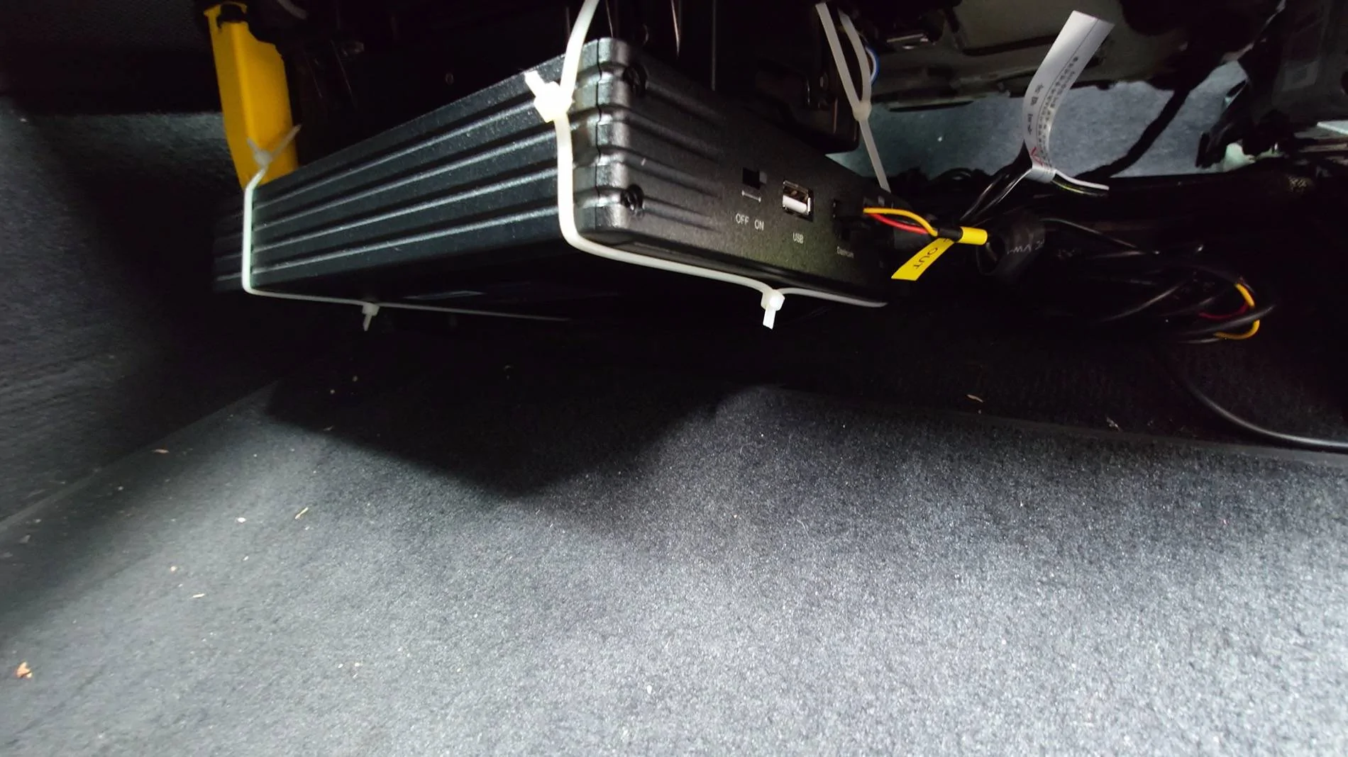

I was ready to use a normal power bank when I realized how much costs a Blackvue B-130X battery (more than 300$/€). However, after having read here (and elsewhere) the heat and charging issues that you may face with a powerbank, I went for the Blackvue battery. It has an additional USB port, an app to check its status.
3. the installation:
I'm no expert in this kind of things, so what i did, every one can do it ...
- dashcam to battery: super easy. just connect the 3 wires from the 4G kit to the 3 wires from the cable provided with the battery. Black to black... but red to yellow and yellow to red. I got it wrong at first and the camera wouldn't go into surveillance mode.

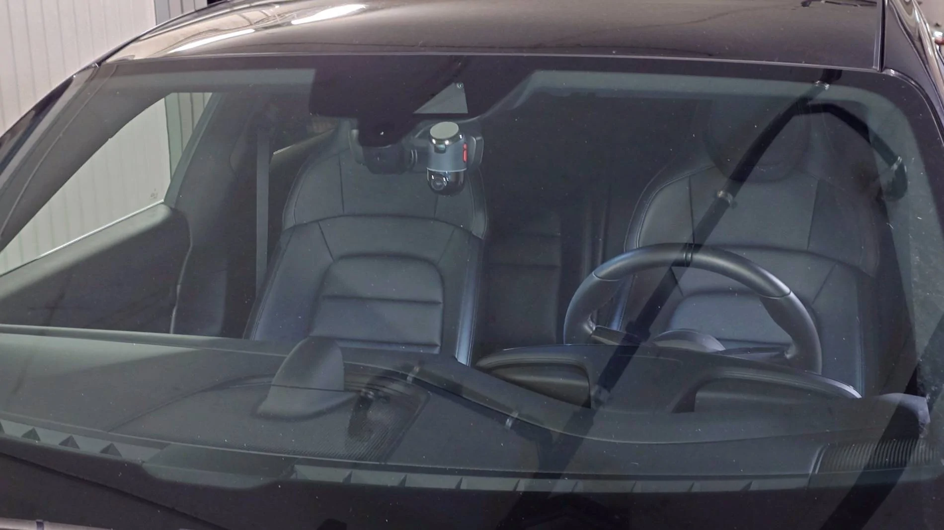

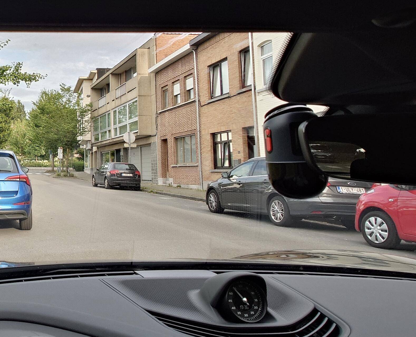

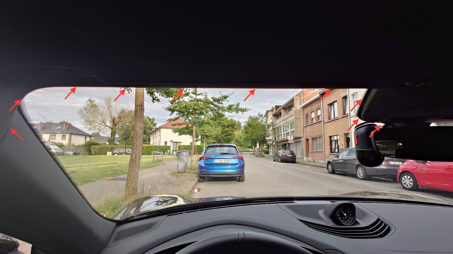

- i installed the dash cam on the left : the base hold with a sticker.
it gives me the possibility to access if i wish so some control buttons. Contrary to what the pic seems to show, it doesn't block the vision.

- the battery is installed under the driver seat. i can easily access it (on/off switch -USC port)... especially if it goes on fire ?
Not the cleanest installation I admit it ...

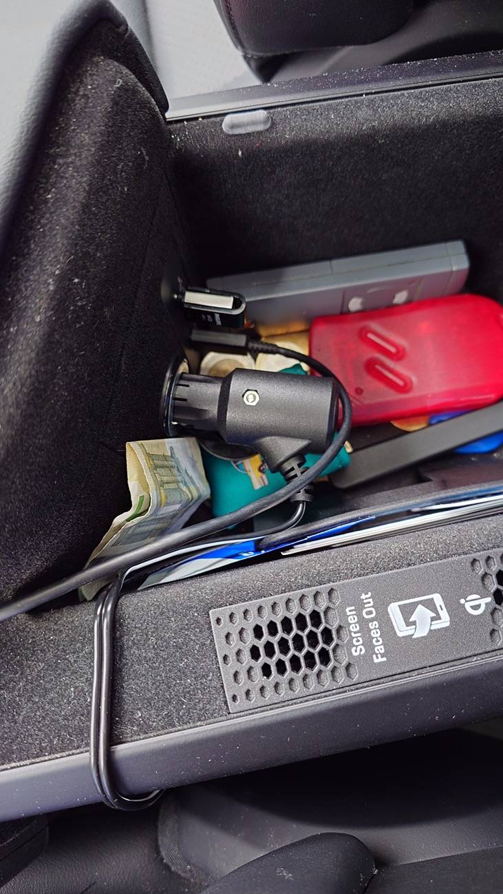

Porsche Taycan Another dash cam installation : 70mai Omni 20240722_193724707
it's plugged to the 12V in the arm rest. Easy to unplug, and not much wiring

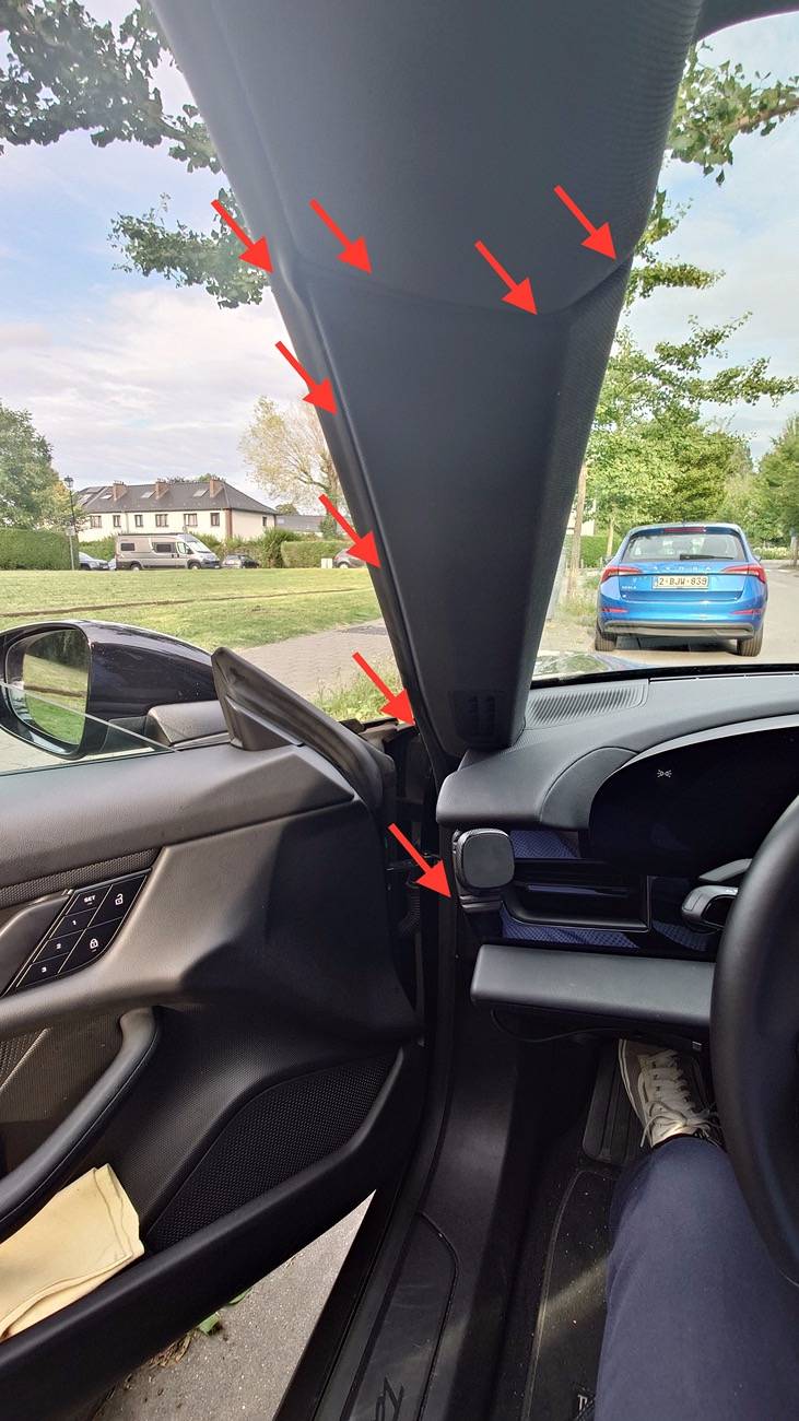

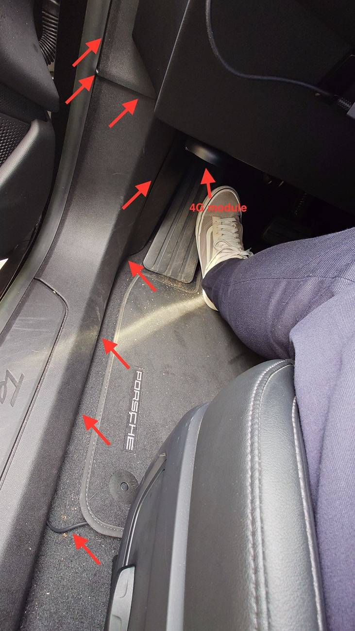

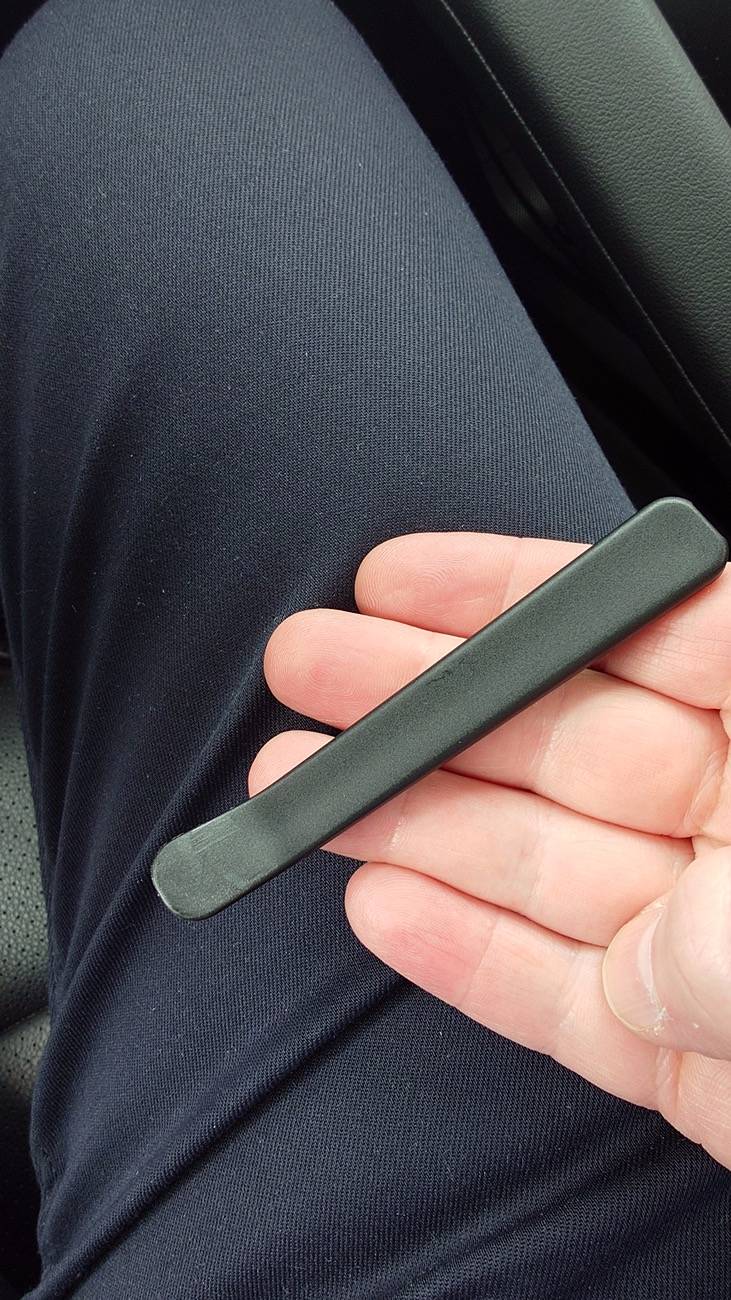

- wiring the dash cam to the battery was my main concern... I didn't want to remove the A-pillar or other parts.
It was in fact quite easy, using the tool provided with the dash cam.
Porsche Taycan Another dash cam installation : 70mai Omni 20240722_193616757.JPG
I just had to push the cable all the way and it doesn't show at all.
Porsche Taycan Another dash cam installation : 70mai Omni 20240722_193654401.JPG
Porsche Taycan Another dash cam installation : 70mai Omni 20240722_193706420.JPG
Porsche Taycan Another dash cam installation : 70mai Omni 20240722_193713739.JPG

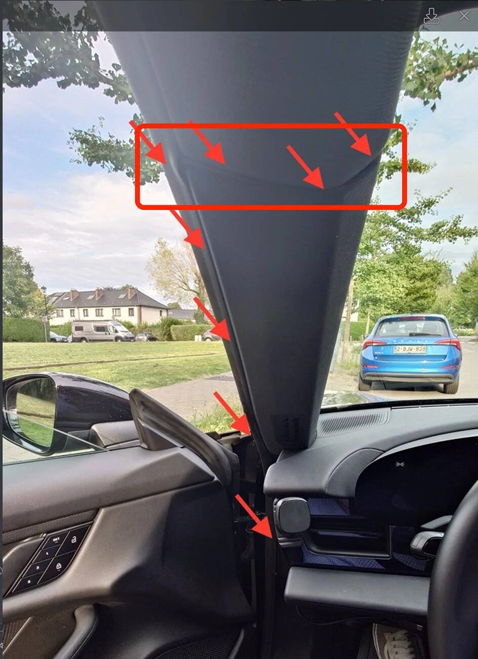

In a world of very same-same dashcam designs, it is certainly different! Must read up more on it. My Porsche Centre is very fussy on not allowing "unofficial"accessories – so the fact you are powering all this by the "official" 12-volt socket is a big advantage from a warranty perspective.
FWIW: in this bit the cable is going "in front" of the airbag that is behind that trim piece. Everyone has different risk appetites and given the force that an airbag deploys – I'm sure it isn't a problem.
But – speaking only for myself – I'd be worried enough in a worst case scenario about that bit of the install.
You're right. My first option was to go on the green side but it was almost impossible to hide the cable in the bottom. And the cable is not long enough to hide the 4G module where I have it now : it would stay on the dashboard, exposed to heat.
So I went for the unsafe option ...
