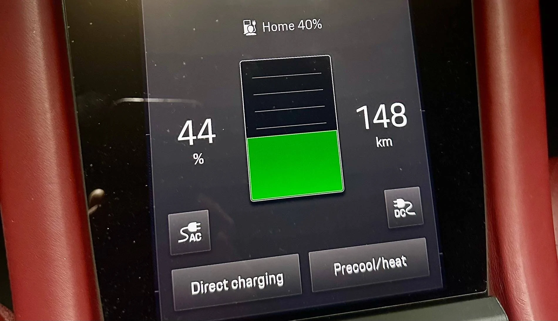

MY2021 has been charging beyond the set minimum. For example, I set it to charge to 40%, but it will charge to 44%. If I leave it overnight or park it for more than 2 hours after driving, the state of charge will drop back as it deducts the 4-5%.
-battery temp. after charge(29°)

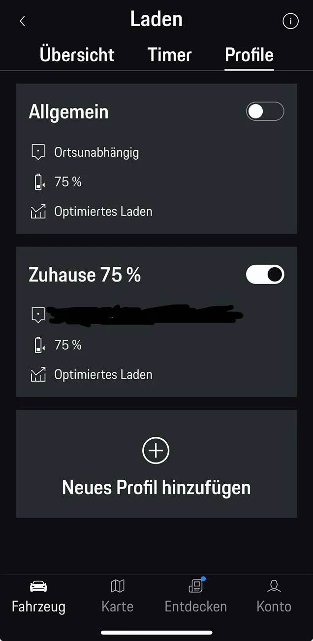

How do you set the charge minimum/maximum? When I charge from now on in my garage, I'd like it to charge onky up to the now-recommended level of 80%. Actually, I had earlier thought that charging to 100% was actually less than "true" 100% by virtue of the battery/charger 'smarts' not to go to full charge. Your help/comments?
I've noticed mine at 1-2% over, but I attributed that to temperature changes and didn't think much of it.

Same here..If I charge on a cool evening, the state of charge is up a % or two when things warm up the next day

Which is the normal chemical reaction.
Other way round: if you leave the car over-night in freezing temps with 5 %, you might find it the next morning with 1-2 %.

You need to set up a profile with the desired percentage.
No further timer is set.
Than your car will charge up to the percentage set in the profile.

Lately, only when I set it to 40%, it goes over by 5%. However, at other states of charge, it doesn’t seem to charge beyond the set point as much. The strange thing is that sometimes, overnight, it deducts the extra 4%, and other times it doesn’t. It seems like the balancing is off.
