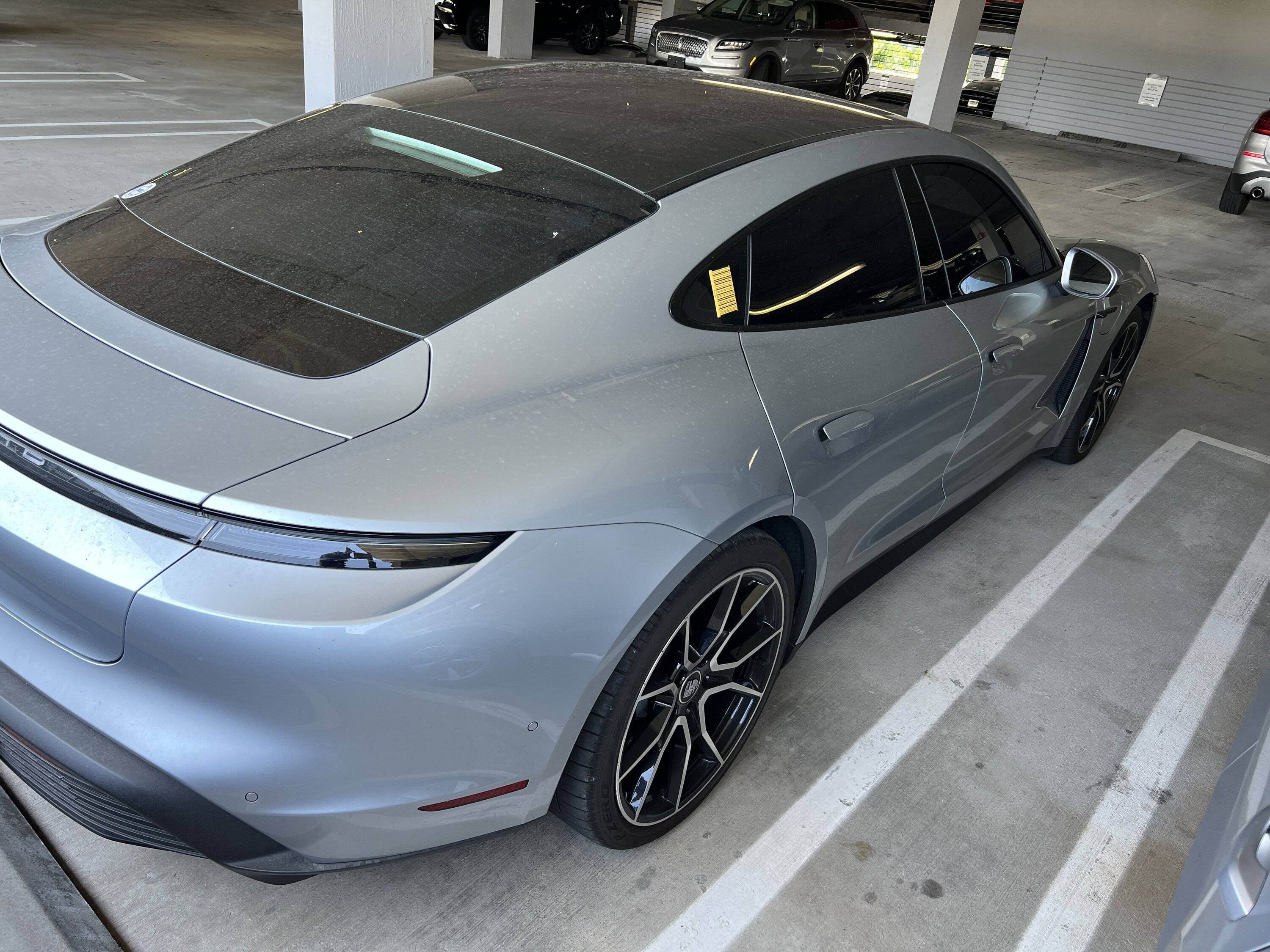

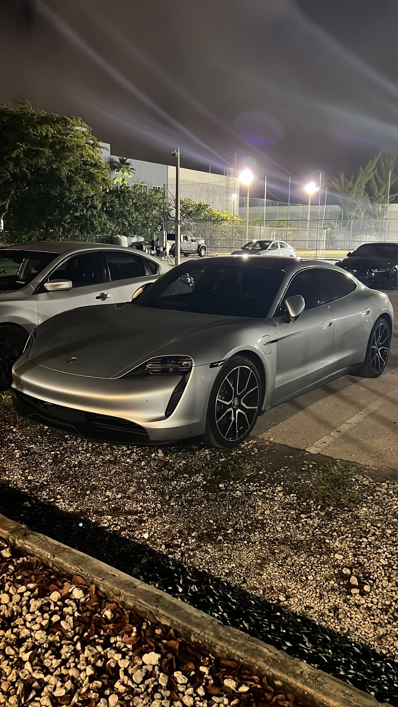

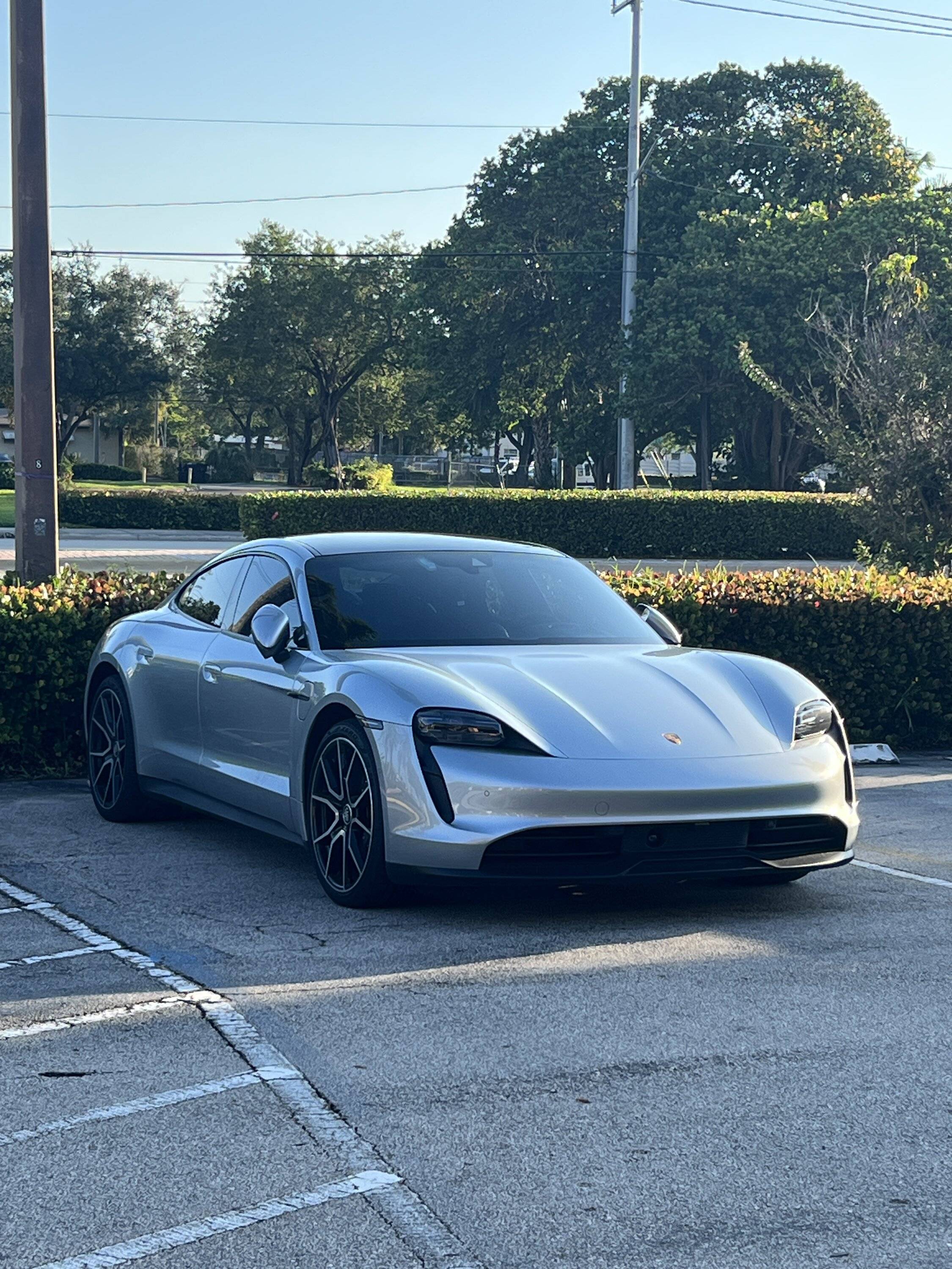

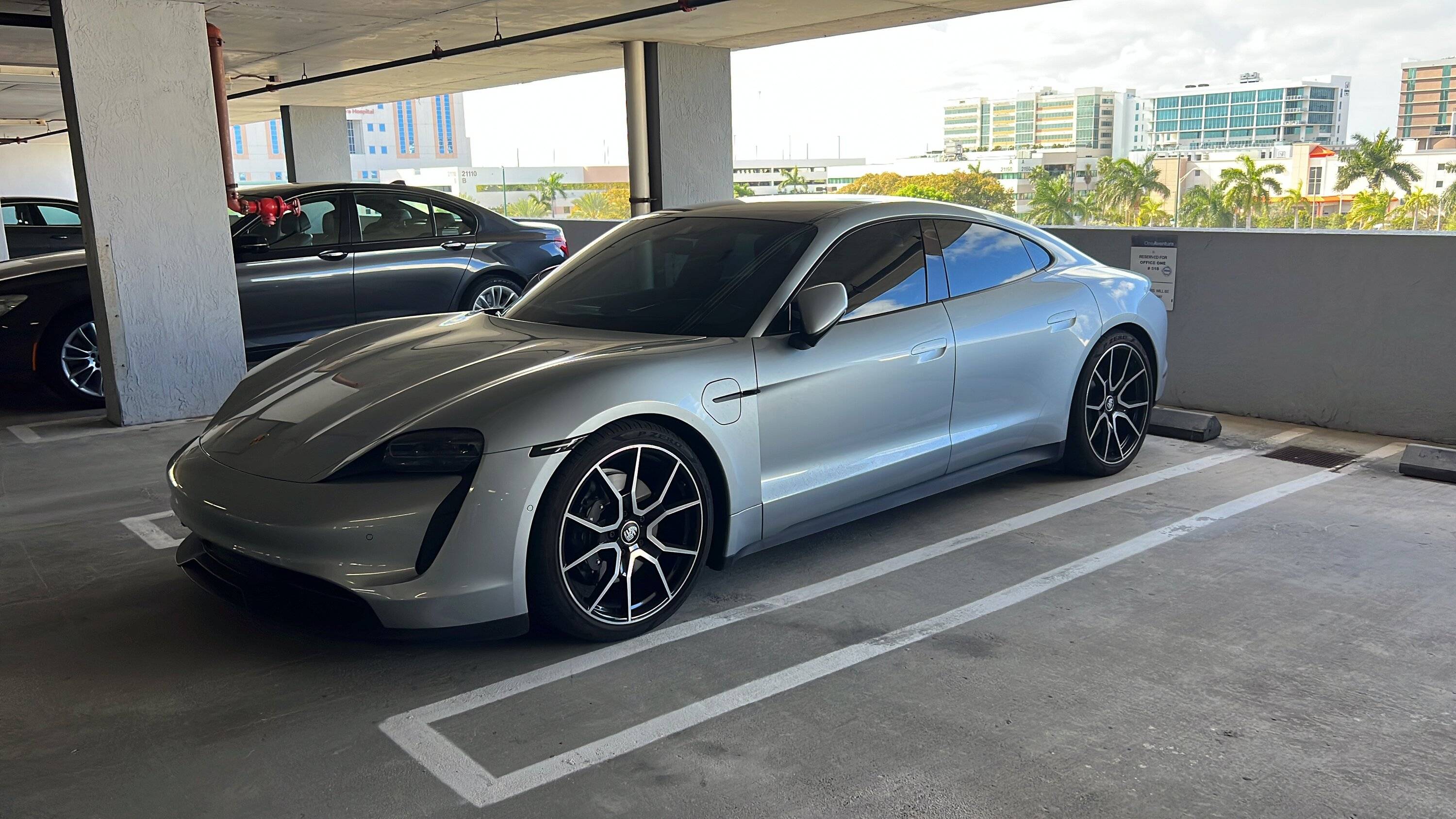

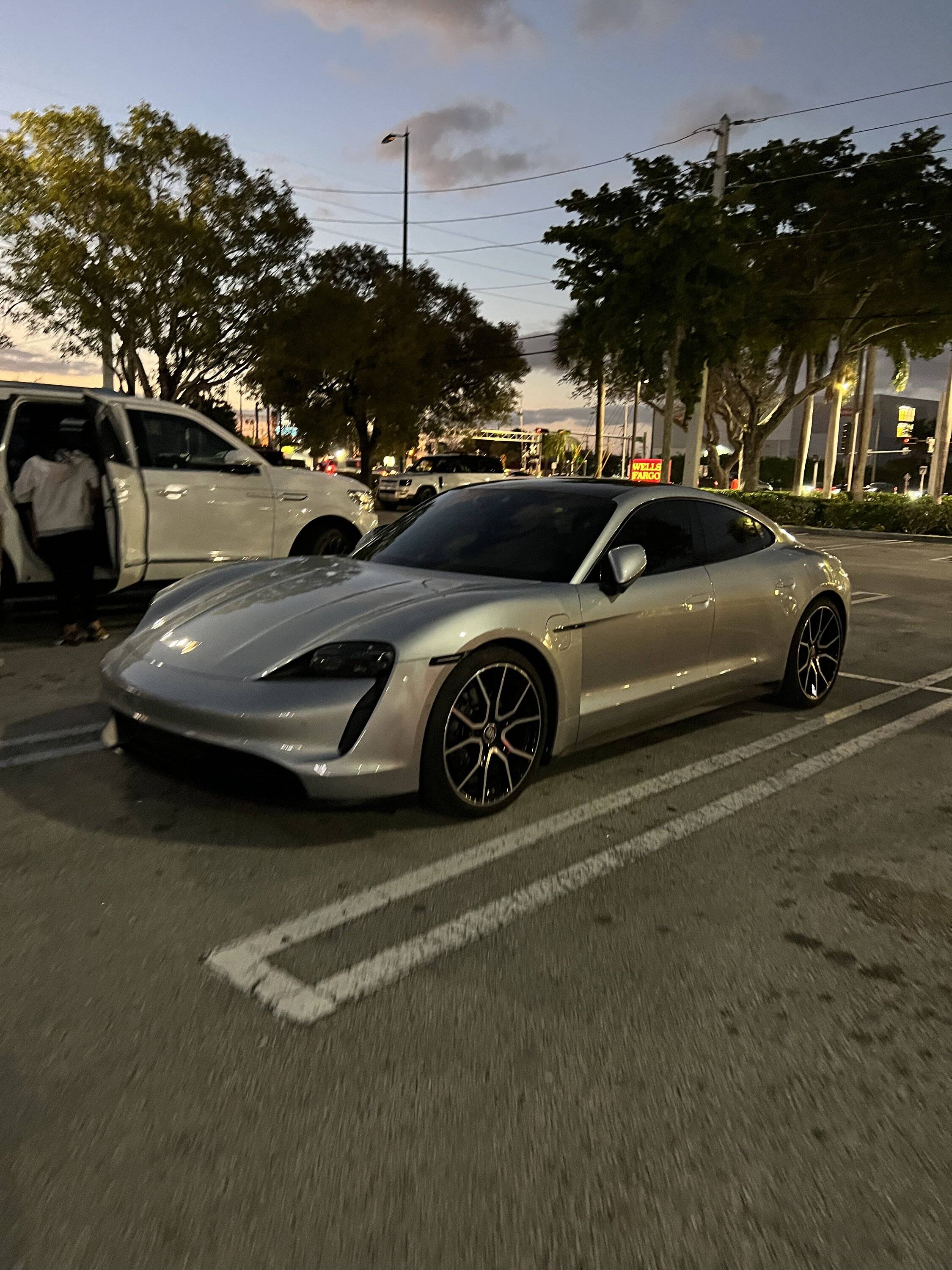

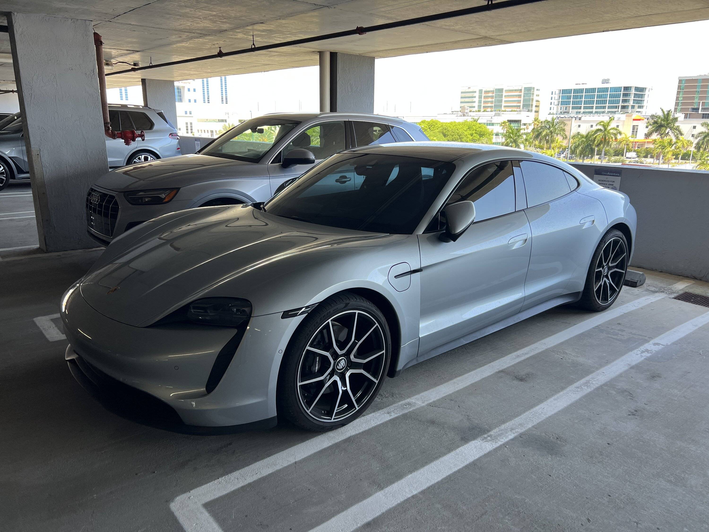

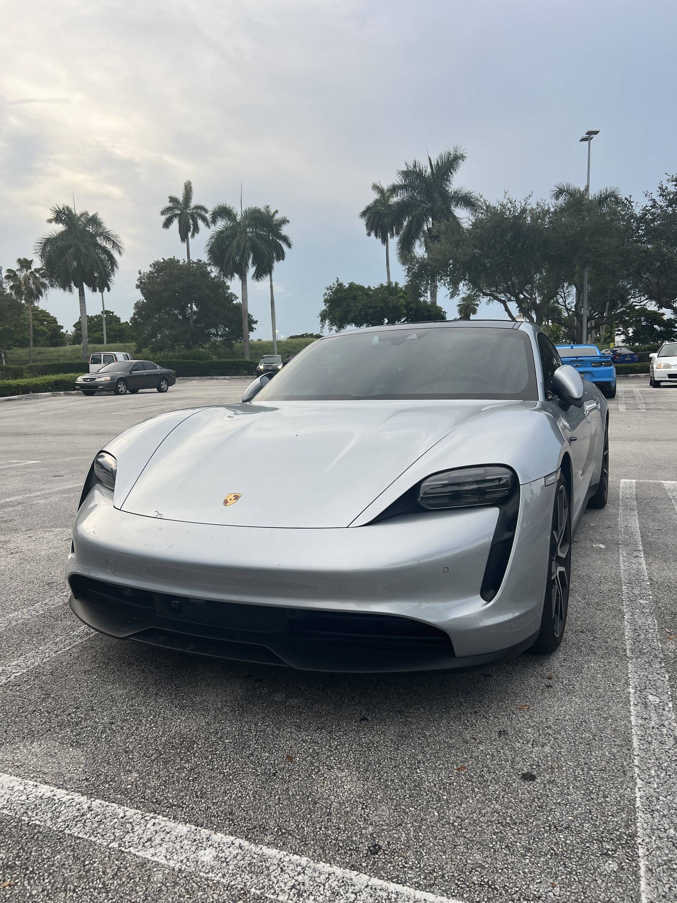

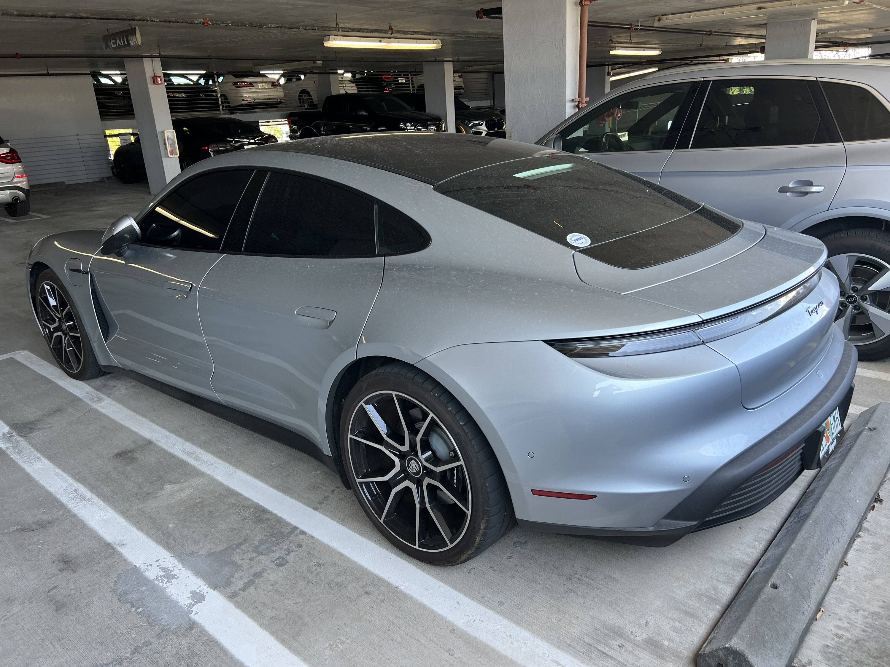

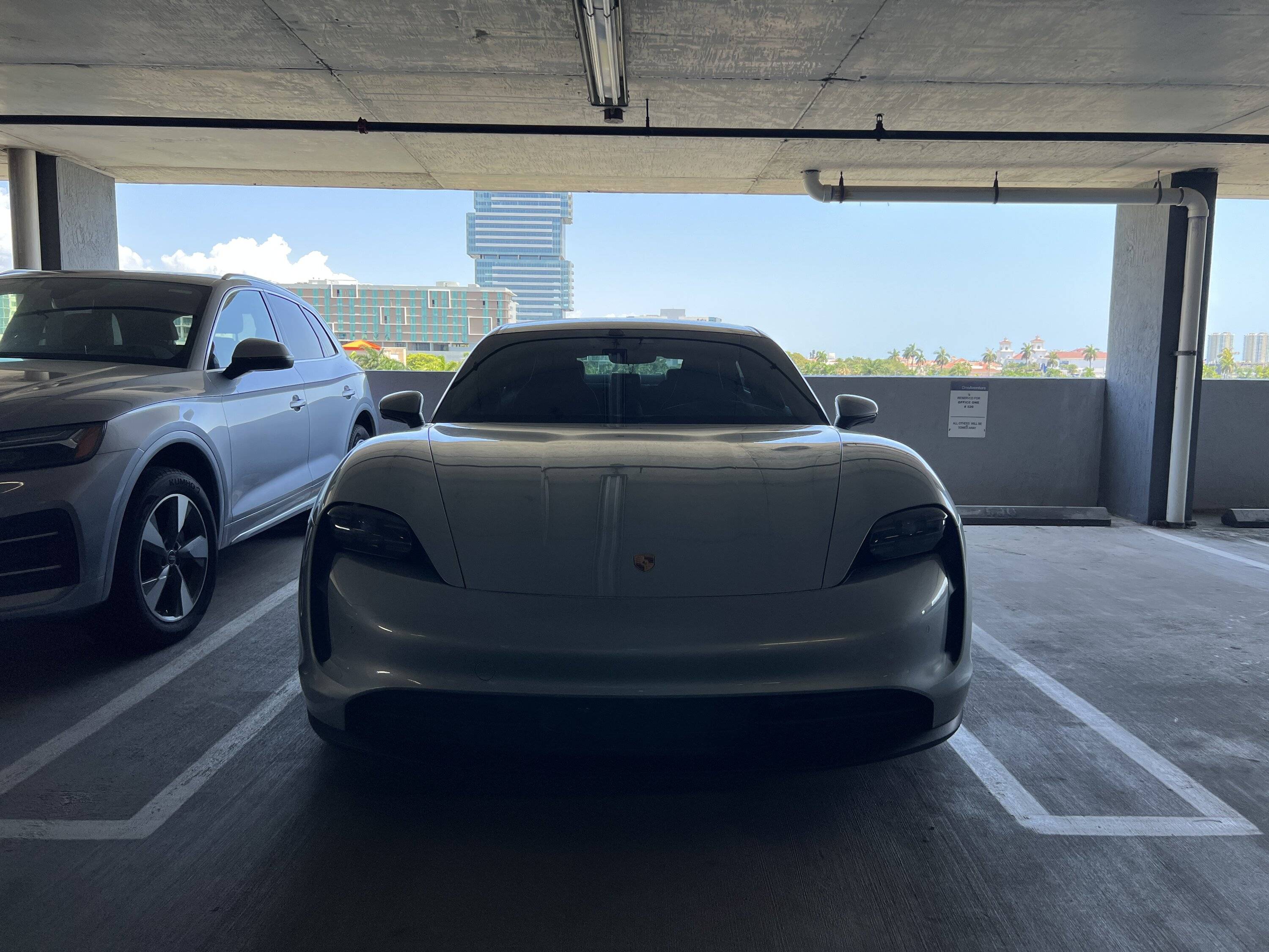

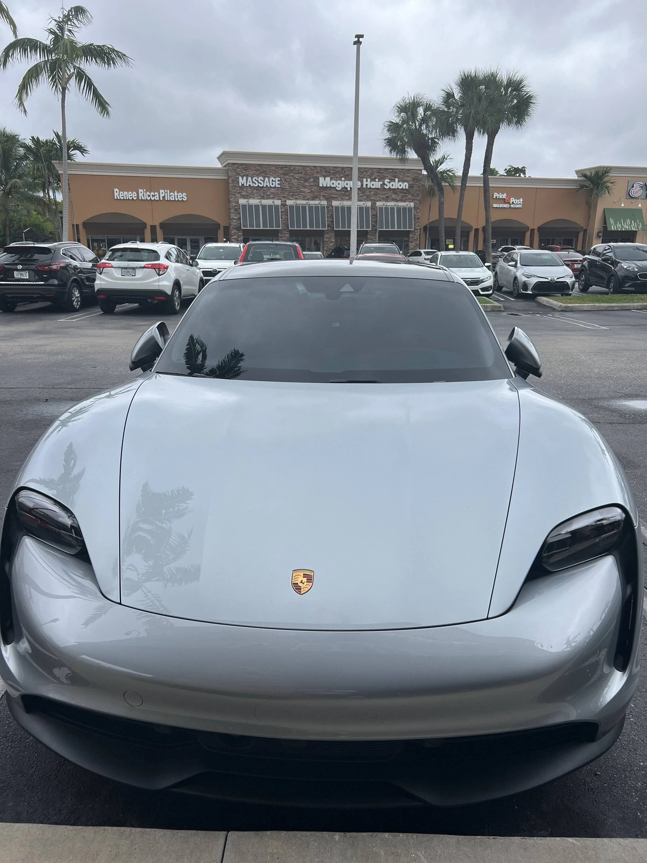

Very intrigued. Can you post some pictures?
here you go!
many angles, light conditions, day/night/rain
this is the result pf many years tinting a ton of cars to get to my perfect mix
