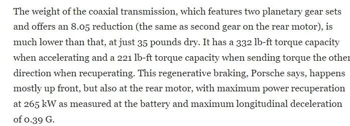

After uPdate , no change for my 21CT:1,2 miles slightly descending (not 2,6 weeks…) before recuperation works …
More generally,the discs pad are active only if deceleration is stronger than 0,4 g An Extremely Detailed Look At The Porsche Taycan's Engineering Designed To Take On Tesla (jalopnik.com)
