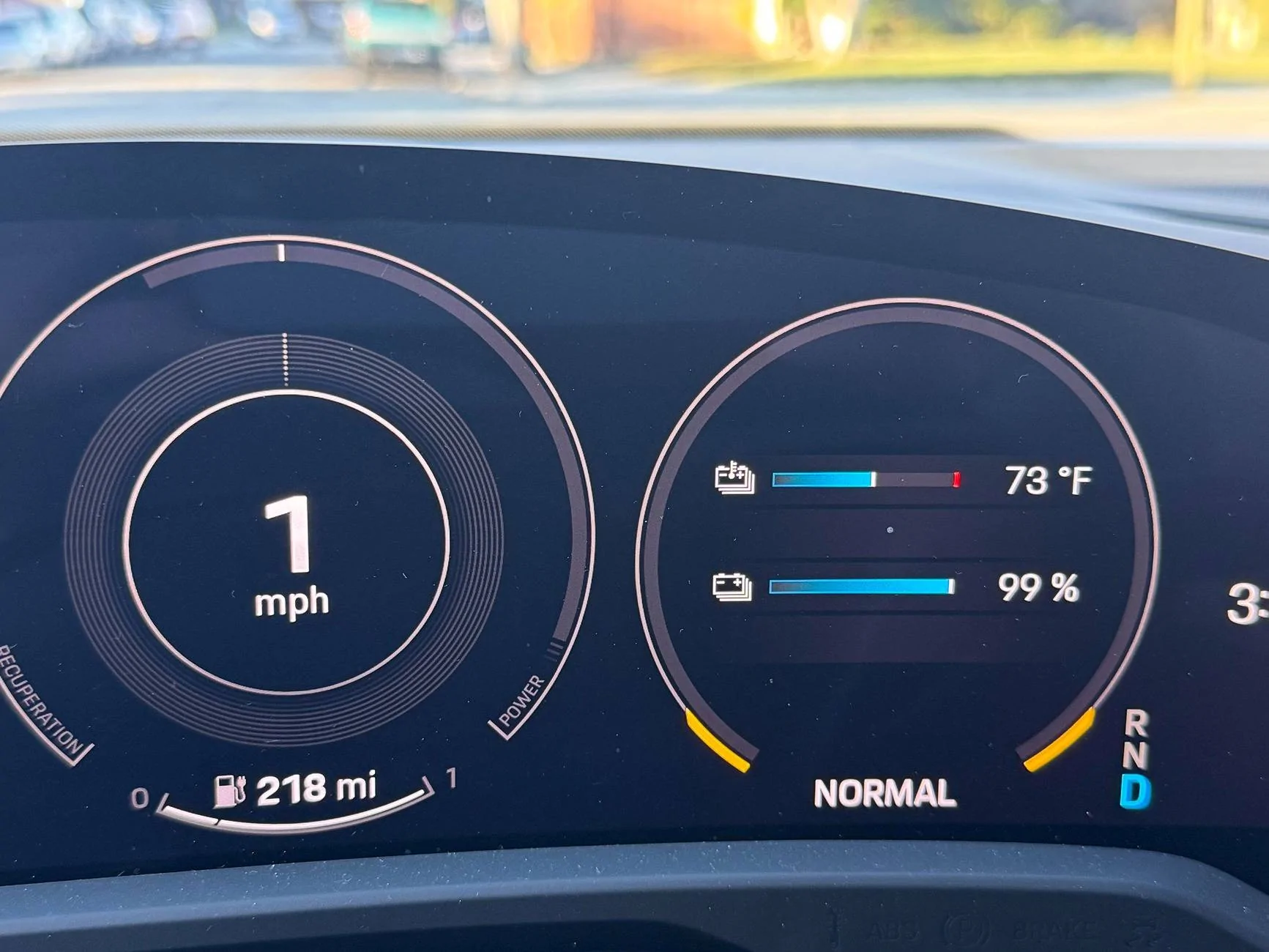

I have a '22 GTS sedan. From day one 100% battery yielded 240-242 miles of range. Not great but workable because of how awesome the driving dynamics are on the GTS Taycan. For context the car currently has 23,000 miles. For the first 3 years I've owned the car I didn't really notice any battery degradation, then one day a month or two ago I noticed when I charged to 85% I was getting significantly less miles of range. 85% didn't even get me over 200 miles of range. 70% charge gets me 155 miles of range. I had to take a long trip so I charged to 100% and the range was 218 miles.
This is my first EV so I guess my question is does this happen overnight? I know that batteries degrade over time it was just a little shocking to lose so much overnight. Is that normal? Thanks in advance.

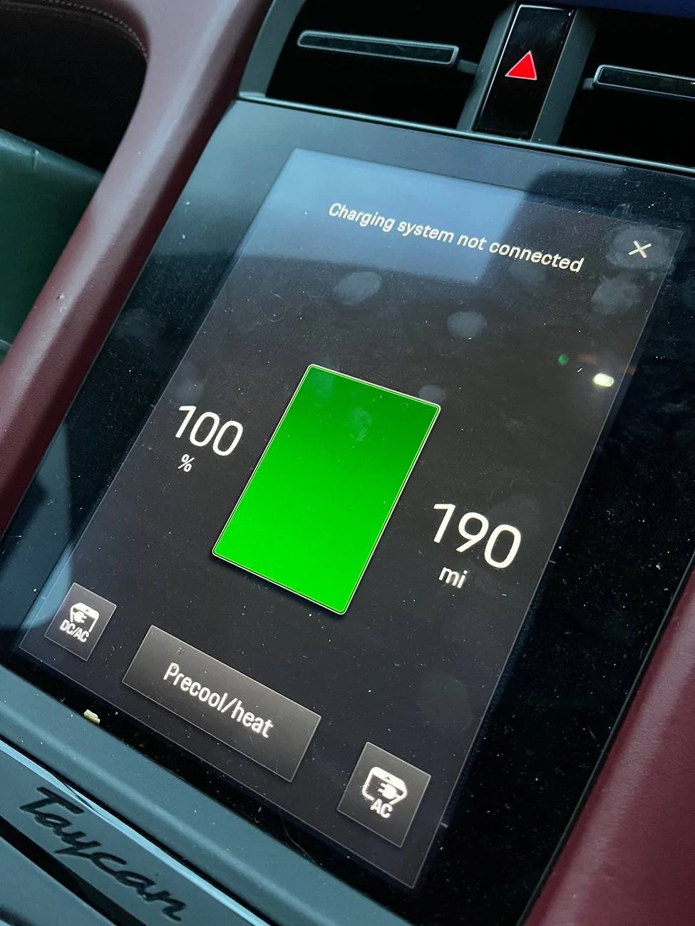

My 2021 CT4 did the same I believe about two weeks ago. I normally get 240m of range and about 200 in the uk winters but just before I got the letter from Porsche informing me they need to monitor my battery my range dropped to 190m and it wasn’t that cold. ?‍♂

@LotusPhil, this to me would indicate that battery cells may be going bad. I would strongly recommend getting an OBD with CarScanner app, get a read out on the cell voltages and charge levels and then doing a rebalance. The worst case is that you get Red Circle of death and then you can only flatbed the car. We have 2 extensive threads on the forum that cover both topics on how to do it. Let us know if you need help with it.

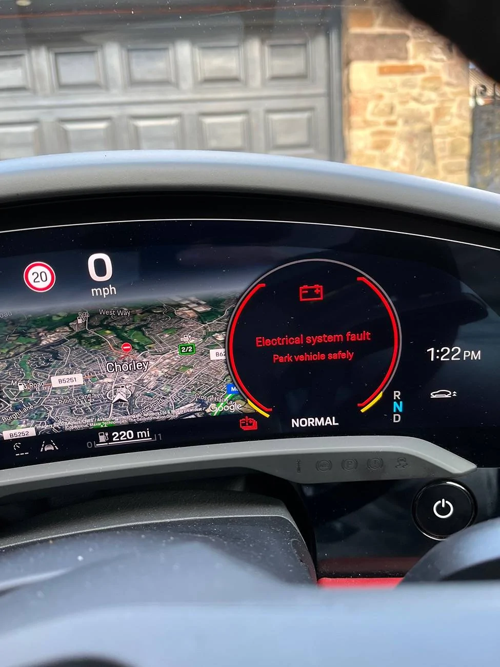

Ah you mean like this… I’ve had two screens like that in the last year… By the time the breakdown service arrived the fault cleared

^ This is the sign of cells going bad. Yes.

You need to show this picture to service, and they need to check the battery cells. They CANNOT simply send the car back without diagnosing and correcting this problem. You'll probably have to escalate and deal with a fair amount of BS.:mad:
