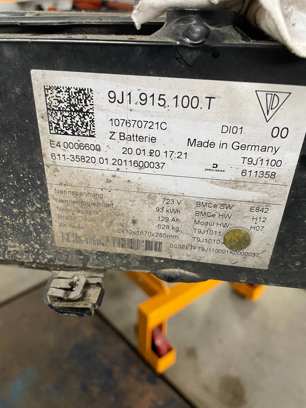

Everything matches, except for the numbers on the battery itself, my battery is
9J1.915.100. T
E4 0006600
611-35820.01.201160037

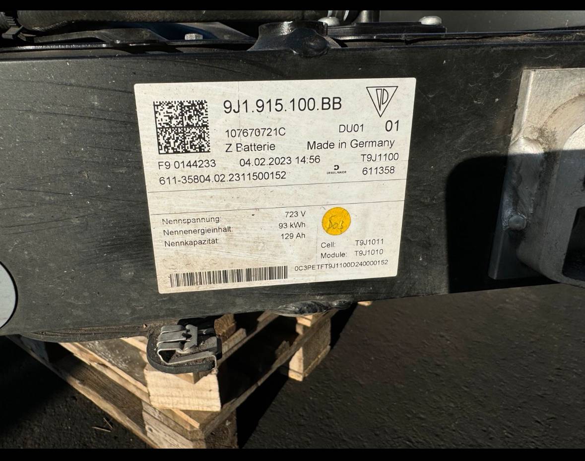

Battery I would like to buy:
9J1.915.100 BB
F9 0144233
611-35804.02.2311500152
Both batteries are 723V, 93 kWh, 129 Ah!

Porsche Taycan Battery change IMG_3735
Porsche Taycan Battery change IMG_6651

There's a write up on rennlist that goes over the different battery modules used for the different model years. Seems like they're interchangeable, but the guy claims the newer batteries are more reliable.
